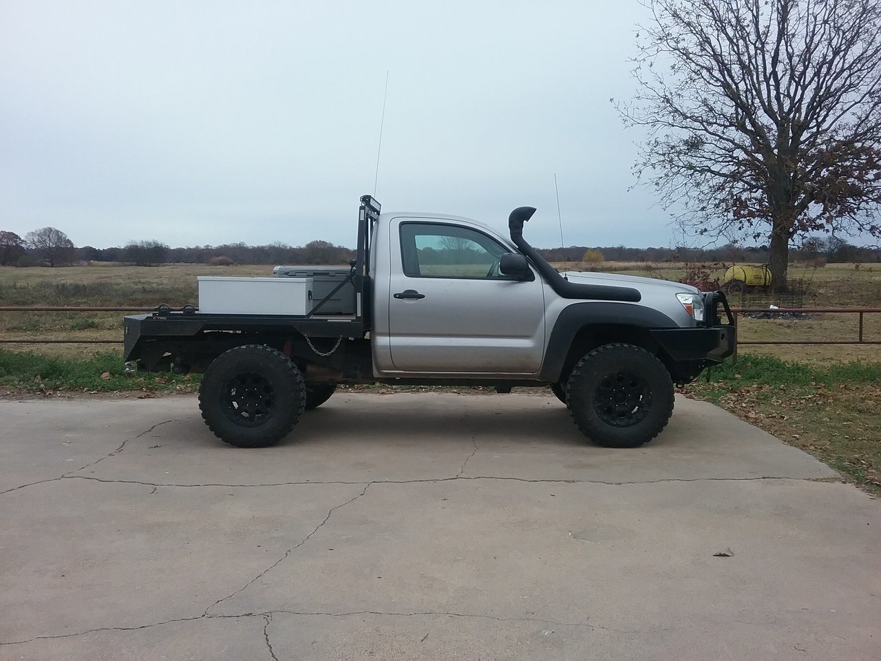

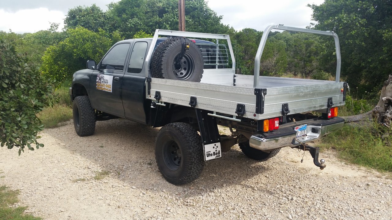

    About to order this bed.
    For this truck
    Also doing a removable cage with canvas top, dual battery set up, 40 watt solar panel with tjm controller, rear slide drawers with sleeping platform on top, and rear winch. I will start a biuld thread and link it when I start.
