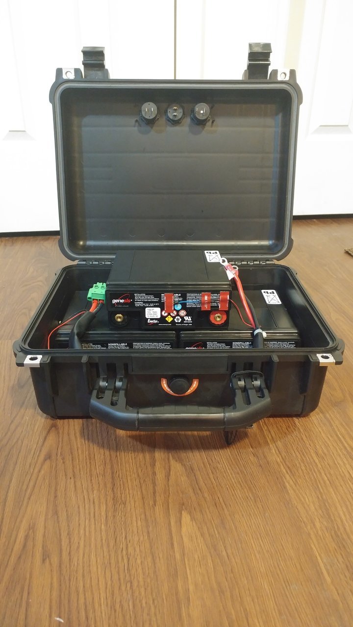

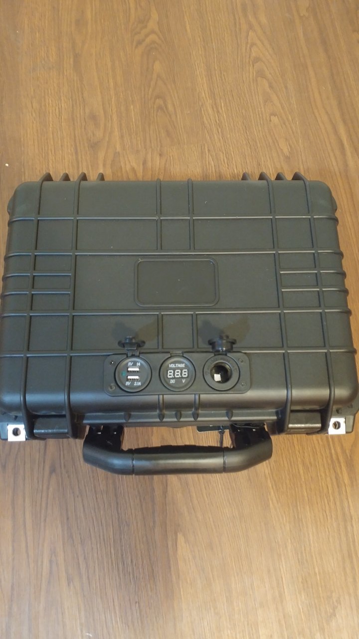

    Portable Camp power ready to go

    What type of battery?

    3, 12 volt. Same batteries we use to power portable XRay machines.

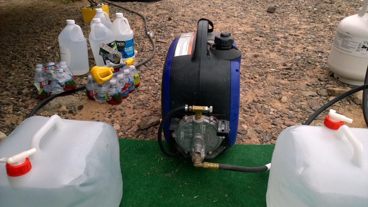

    Been in NV on BLM land since Nov 29th, so far so good. Trailer fridge stopped working on propane, works fine on AC from the generator. Yamaha generator is good powered by propane, 4.5g LP tank lasts a long time. Propane is god-like for me.

    @monkeyface Why did you decide to convert the generator to propane?

    4.5 gallons from a 20 lb propane tank vs 1 gallon stock gas tank. Can run the gen for a lot longer than gasoline. And don't have the messy refill, nor carry gasoline containers.

    @monkeyface how did you convert the generator, and do you have pictures of it?

    I've installed tri-fuel kits from here on three generators - https://www.motorsnorkel.com/
    Others have similar kits. https://centuryfuelproducts.com/generators/conversion-kits
    https://www.propanecarbs.com/small_engines.html
    USCarburetion (aka motorsnorkel.com) has been good for me. Easy install, I think it's the easiest install of the bunch. Yamaha EF2000isv2.
    Notice on the right of the brass T fitting there is a loadblock. That has to be set right to get it running and get the air/fuel mixture correct. Can be adjusted out to richen the mixture at high altitude.
