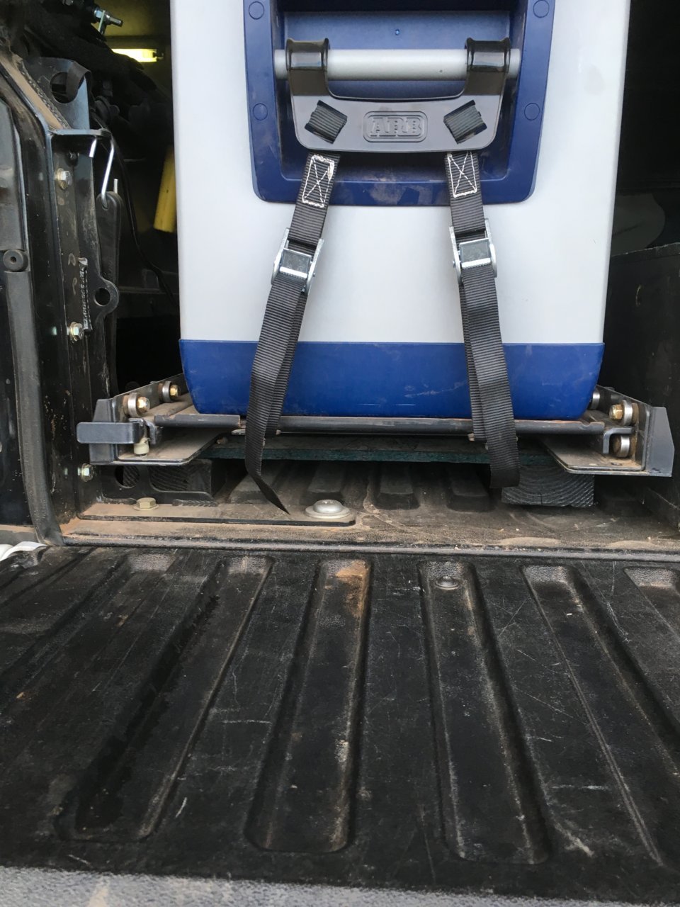

    I've searched some different threads but still no real solution. Anyone have any insightful input on mounting fridge slide to the bed directly using riv-nuts/nutserts or plus nuts. Or attach it to a plywood base and anchor that using the bed bolts or something? behind the seat isn't an option.

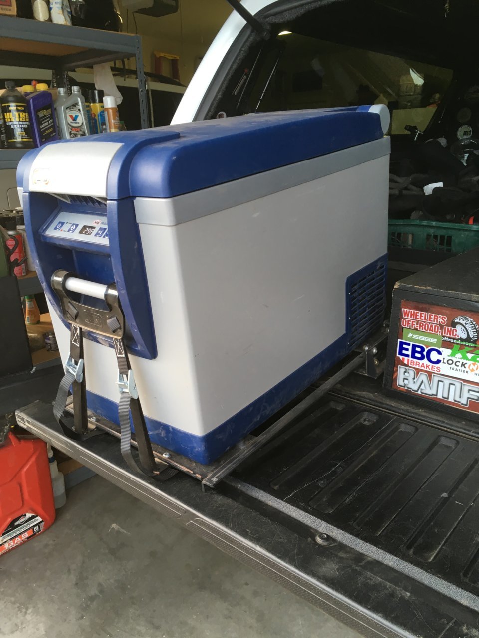

    I mounted my slide to plywood cut precisely to fit in between my bed stiffener/wheel well/drawer. It works great and unintended auto-tilt feature makes access much easier. I’ve run Hells Revenge and Trifecta with it and had no issues. I also considered your rivnut idea, but I really like how easily I can remove it.

    my hero! Running the same TC stiffeners. Definitely like to keep my system modular. How do you keep it from sliding back? I have a bed rack so I'll be housing my new fridge in an enclosed box with DIY arkpak behind it powering the operation.

    That's what I was thinking. Thanks for the input. I see so many fridges installed, but very few document the mounting solution.

    The slide mount or the slide? The TC stiffener keeps the plywood/2x4 platform from sliding backwards. The slide assembly is bolted to the plywood. And there is a locking pin that locks the slide either open or closed, so nothing moves unless I want it to.

    The entire ply/2x4 base. I guess I meant, the whole unit sliding towards the cab.

    The wheel well prevents it from moving forward.
