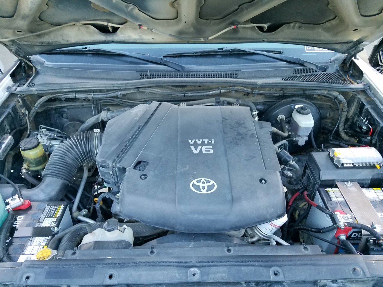

    What size positive wire from battery to battery ? I am just going to ground battery to frame with big grounding strap. Have some 0/2 copper welding leads laying around just looking for a reason to have some lugs crimped on

    Why 1/0? I’m assuming both batteries are under the hood?
    When I built my dual setup I used all 2 gauge. FYI there is a bolt hole on the top front of both sides of the frame. Easy to ground both batteries together.

    Im using 2gauge cable. No measured voltage drop with the amount I used. Longer runs between batteries will require larger gauge obviously. 200amp circuit breaker from the starting battery to a 200amp isolator. And a 150amp ANL fuse to the house battery from the isolator. The house battery is grounded to the starting battery and not to chassis.

    To each there own. I did not put any fuse between the batteries so I can self jump. The aux battery is grounded to the motor and the frame. Then I beefed up the grounds from the frame to main batt as well as the body ground.
    I left the main batt out and started soul off the aux and it was just like the main so I knew it would be good in case of a self jump

    Hmmm, I better get the big stuff then......I gotta run all the way to the bed
