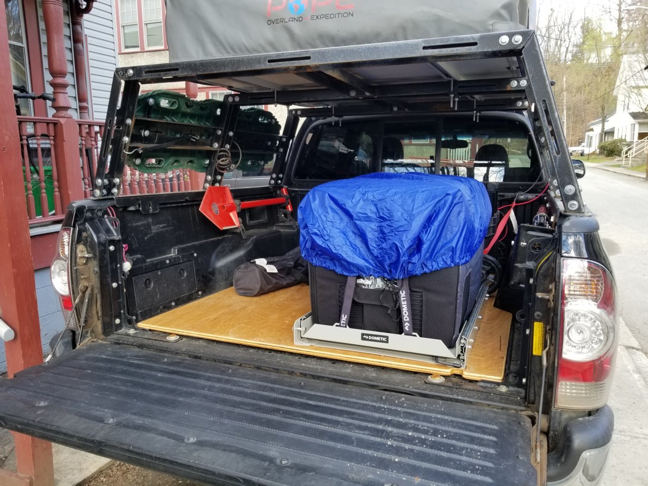

    I spar urathaned the shit out of it. Better than buying marine ply at $120 a sheet in my area.

    Spray urathaned?

    Spar urethane. Commonly used in marine applications. Great for wood exposed to lots of moisture.

    I can't speak for trailbutter, but what I've done is get a 4x8 sheet of finished plywood, cut it to fit the wheelwells. Then slather it with spar varnish. Looks good, durable.

    Exactly what I did.

    The extra two foot from the 4x8 I put it onto the tailgate. Looked pretty good and was a nice surface to sit on or coleman stove and lantern
