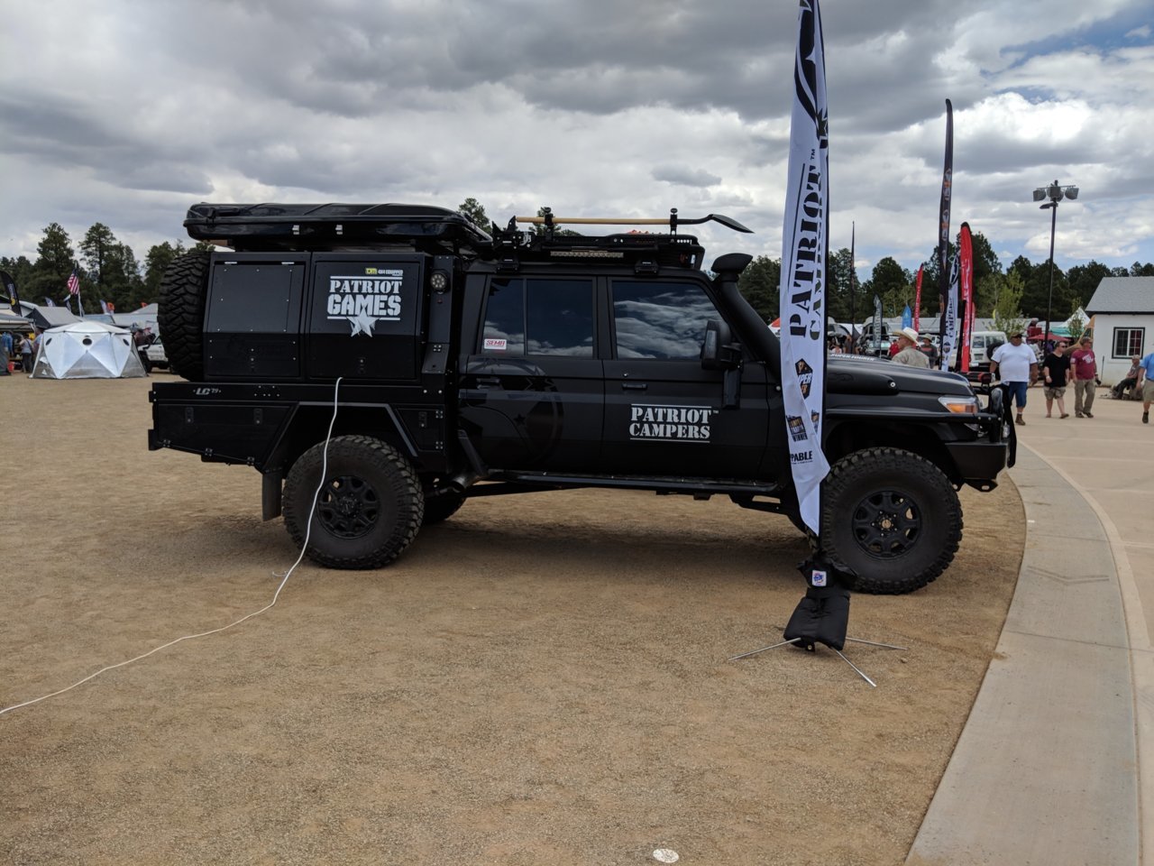

    That truck is at Overland Expo West.

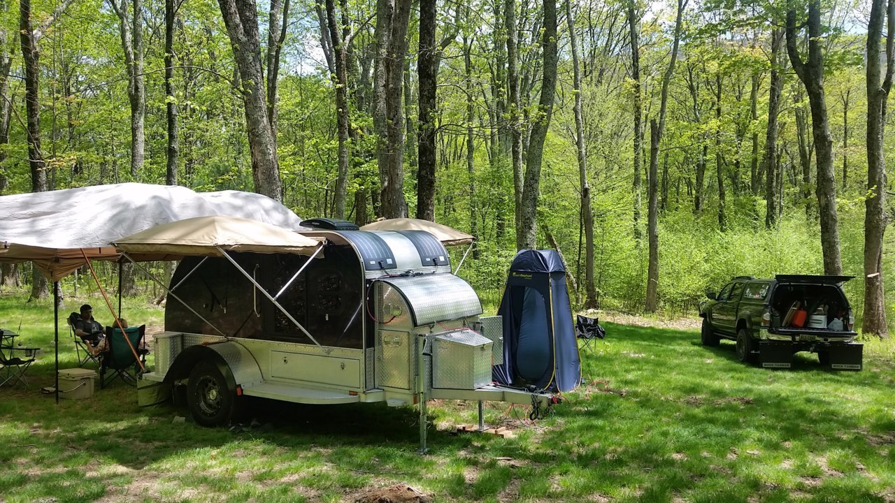

    Dude you can't post a picture like that and not give us some details

    like why his mudflaps are so big?

    Well, if the road to the campsite is extremely muddy, maybe you wont have to camp in a mud covered trailer when you get there. That would require big mud flaps on tow vehicle as well I guess

    Thanks!
    I believe I just did. So obviously I can.
    :D
    But the link in my Sig does explain the teardrop.
    As for the trip, it was our Mothers Day weekend trip for my wife. The kids came along and helped us celebrate with a couple of gourmet quality dinners. We were in George Washington National Forest outside of Buena Vista Virginia.
    What more would you like to know?
    Tow a trailer down a muddy gravelly road, you'll figure it out
    Bingo! One trip we had to wash the trailer before we could even get in it to take a nap! The big mudflaps help a lot, not perfect, but we're working on a better option.

    Looks like you have flexible solar panels on it but after reading your link (Excellent write-up:thumbsup:) I didn't see any info. I'd like to know what panels you used and how did you fix them to the trailer? :hattip:

    Yeah. They are a new addition. Added them Saturday before our trip. They are self stick. You just peel a backing paper off as you stick them down. That are from Unlimited Solar (Amazon) part UFLX-100.

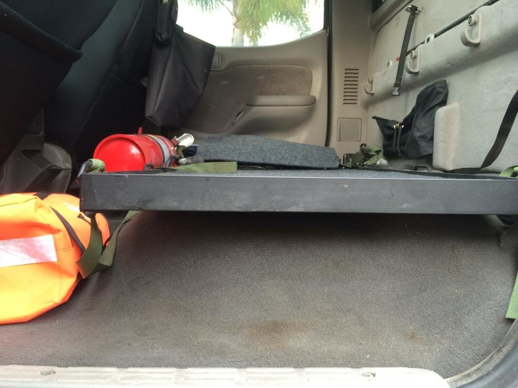

    You guys should always be thinking about "Where is my stuff (fridge, boxes, knives, extinguishers) going to go in a rollover situation?"
    If you think it can't happen to you on your wheeling trips, think again. I rolled my first 4runner in my parents back field.

    shelf deal.jpg I made this, its steel with a wood and carpet platform. The tie downs are welded to the steel frame. The steel shelf frame mounts using the holes and bolts that the rear seat mounts too. I usually have my fridge in there, but now I need a new battery solution. (HELP) It can be removed in about 5 minutes and the rear seat put in its place.
