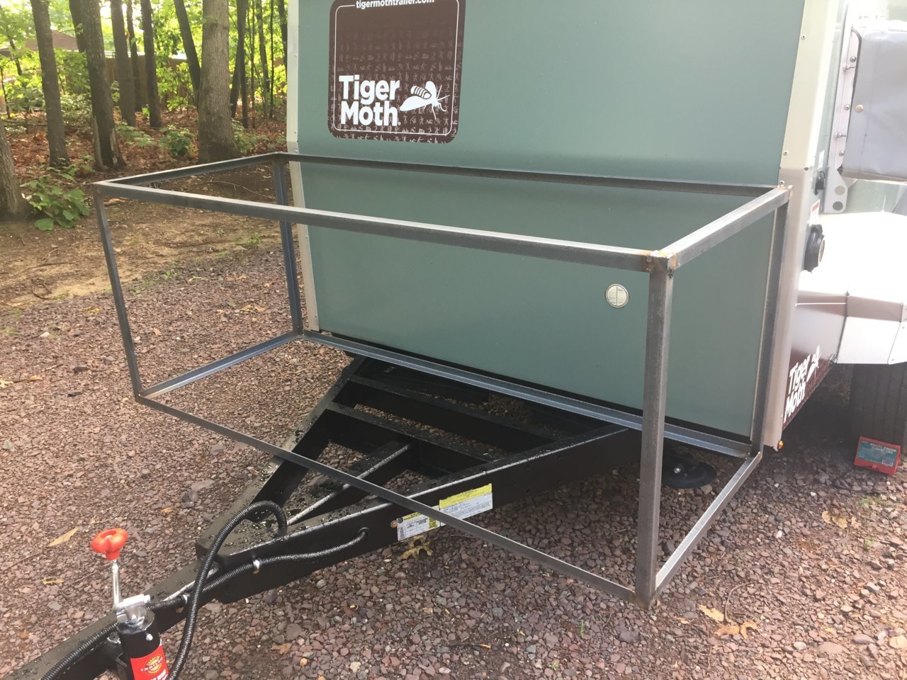

    We got a IndelB TB51 with the cover for the camper. There's nowhere inside the camper so I'm building a 24x24x60" box to mount to the tongue. The box is configured to allow for the required air space around the fridge it's the sun heating up the box that has me concerned. The box is steel so I got a piece of 1.8 aluminum diamond plate that'll be spaced a couple of inches above the box to reflect the sun and the space as an insulator. Ther'll also be 2 4" vents towards the bottom on the front and toward the top in the rear to allow cross ventilation. The box will have the fridge on one side and storage on the other so I cut a hole in the devider and filled it with expanded metal for even more ventillation
    Keeping the fridge as cool as possible is my goal if all this doesn't work I'll mount a 12v fan in the top of the box.

  11. May 31, 2018 at 5:37 PM
    Nomad_Pilot
    Nomad_Pilot I need to pewp
    Feb 2, 2015
    #147763
    3,277
    Clay
    Ft Collins
    Gonna paint it black?
    Casper66 likes this.
  12. May 31, 2018 at 5:47 PM
    Casper66
    Casper66 grumpy ass
    Apr 3, 2016
    #183160
    32,042
    Culpeper, Va.
    '15 DCSB TRD Sport 4wd super white (sold) '13 access cab SR5 4wd
    piddly stuff
    I've been thinking bedliner for durabillity. Which adds to my concern for the heat
  13. May 31, 2018 at 5:51 PM
    Casper66
    Casper66 grumpy ass
    Apr 3, 2016
    #183160
    32,042
    Culpeper, Va.
    piddly stuff
    fridge will be mounted on the drawer slide also so all we need to do is open the door and slide the fridge out for access
  14. May 31, 2018 at 6:06 PM
    Nomad_Pilot
    Feb 2, 2015
    #147763
    3,277
    Clay
    Ft Collins
    Well, if you can pull it out when your stopped, and only store it in bad weather, nighttime, or while moving....I don't see why it wouldn't work
  15. May 31, 2018 at 6:18 PM
    Casper66
    Casper66 grumpy ass
    Apr 3, 2016
    #183160
    32,042
    Culpeper, Va.
    piddly stuff
    Kinda my thinking. It'll be secured at night or when we leave the campsite but while we're there I can actually open both doors and allow free flowing cross ventillation. It's been a busy last month, I extended the tongue and installed a lock n roll hitch, fabbed a spare tire mount and relocated it to the rear, added lights, building this box has been a good sized project on its own now I will extend the frame to support the box all the way across. Most of it's i n the camper build toward the end
  16. Jun 1, 2018 at 3:07 AM
    Casper66
    Casper66 grumpy ass
    Apr 3, 2016
    #183160
    32,042
    Culpeper, Va.
    piddly stuff
    I ordered boat vents which are suppose to keep water out :fingerscrossed: since the fridge will mount sideways in the containment area o was planning on the lowe vents being at the level of the compressor vent. Yes I plan on insulating at least the top of the box on the inside every little bit helps and if still not enough I’ll install the 12v roof vent

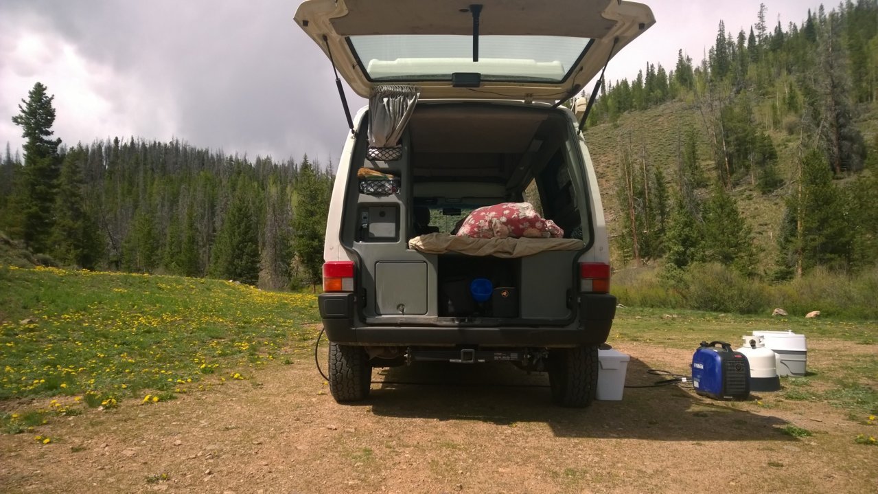

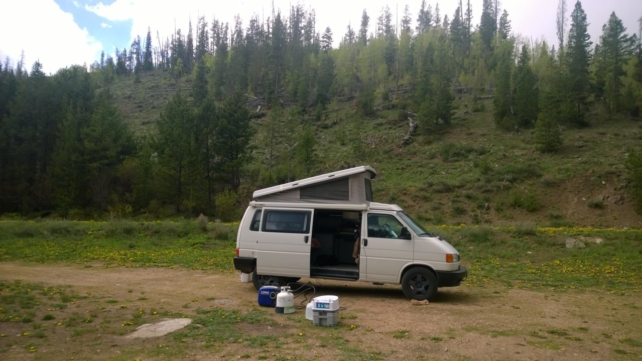

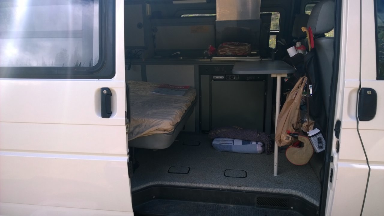

    monkeyface
    monkeyface Douchebag, or just douche if we're friends
    May 13, 2012
    #78740
    3,132
    Colorado
    '90,'97,'12,'05 Tundra 4.7,'07 T4R 4.7,'08 T4R 4.7
    The mighty '95 Eurovan conquers all roads, errr, 2WD roads, err, dry 2WD roads with a 109HP@4500/140tq@2200 motor, 4spd autotrans, and FWD/1WD!!!
    First Colorado offroad fishing trip with this bugger, actually not bad. It's like having a 22RE motor in a 5500lb fully-equipped camper.
    I weighed it equipped for dry camping with 17g fresh water, 21g gasoline, generator, one 20lb LP bottle, full 20lb LP bottle on the van, some basic tools, little of this, little of that. 5552lbs, door sticker says 6173lb GVWR.
    9.75" ground clearance through the middle of the chassis, climbed fine on some dirt/rock switchbacks, there was some 1WD slippage. True 2WD would be nice. 20mpg. It's a comfortable camping unit.
