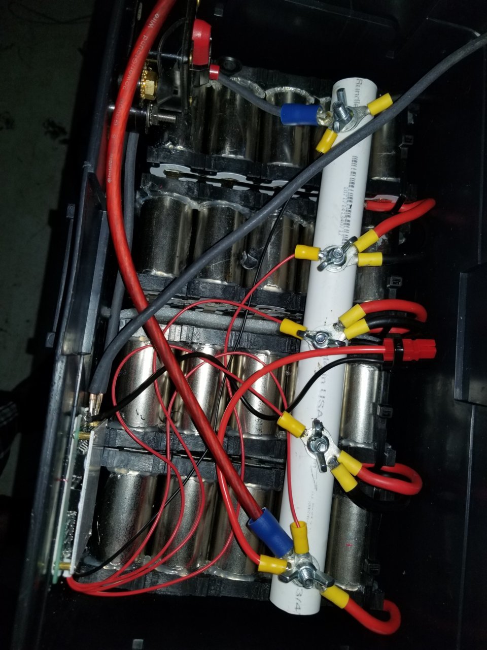

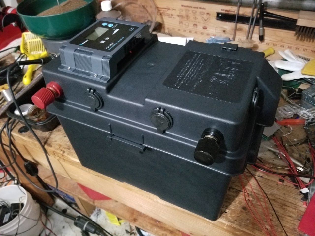

    I made something similar using size 32650 LiFePo4 cells (4s20P). 100Ah weighs 29lb. It's not as simple as AGM or Lead, requires battery management. Overcharging or draining a Li battery to zero will destroy it.
