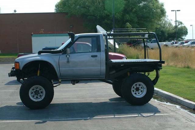

    I had a snorkel on my old FJ40 and I used it for water crossings. Several times with water over the hood, that was on a truck 5" of lift and on 37's so it was pretty deep stuff. I gotta tell ya, some of those crossings were pretty sketchy. And if you play like that you have to spend the time to waterproof all the other crap like electricals.
    Fun crossing from Kane Creek. This truck is lifted 6" and on 37's. so that water is easily 4' deep.
    I have since stopped looking for deep water and frankly I avoid it unless I have to cross it. For me the primary use of my snorkel is most definitely dust. One on of our long overland trips a couple years ago we covered over 1000 miles of dirt roads over a few days. Everyone in the group except one had a snorkel. The guy without the snorkel had to clean out his air filter 3 times because it was so clogged up. A snorkel makes a huge difference IMO by bringing cleaner/cooler air into the motor. Like PCBuilder said, the increased fording depth is a plus. I look at a snorkel as cheap insurance. If you install a high quality one correctly the ~$300 investment is a pretty inexpensive way to avoid several thousand dollars of repair if you ever hydrolock your motor. I've seen guys hydrolock in a foot of water that was barely up to their hubs. Blasting through water can splash water into all kinds of places and one little fluke that gets water into your intake system can ruin your day and your wallet.
