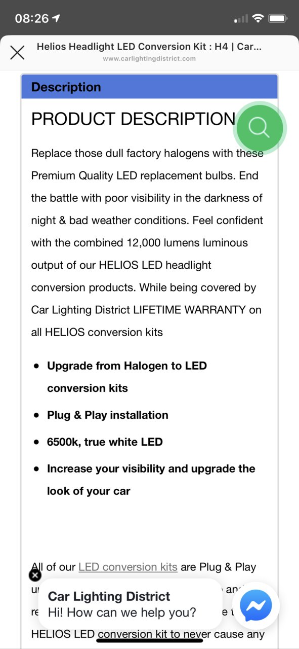

    Anyone have any experience with Car Lighting District headlights? These came up as a sponsored link on Instagram and are plug and play with ballasts.

    LEDs do not use a ballast, they are likely using the wrong terminology and talking about the driver which is not confidence inspiring. The design is a very dated one with oversized chips that do not even attempt to mimic a filament and provide no attempt at a glare guard in design. Charging $135 for that is pretty absurd.
    LEDs and HIDs are very different. An LED is a solid state semiconductor chip that emits directional light when voltage is applied to it. HIDs are a bulb with 2 electrodes spaced apart in a gas chamber that when very high voltage is applied from the ballast causes an electrical arc to jump the gap, creating an omnidirectional light source.
