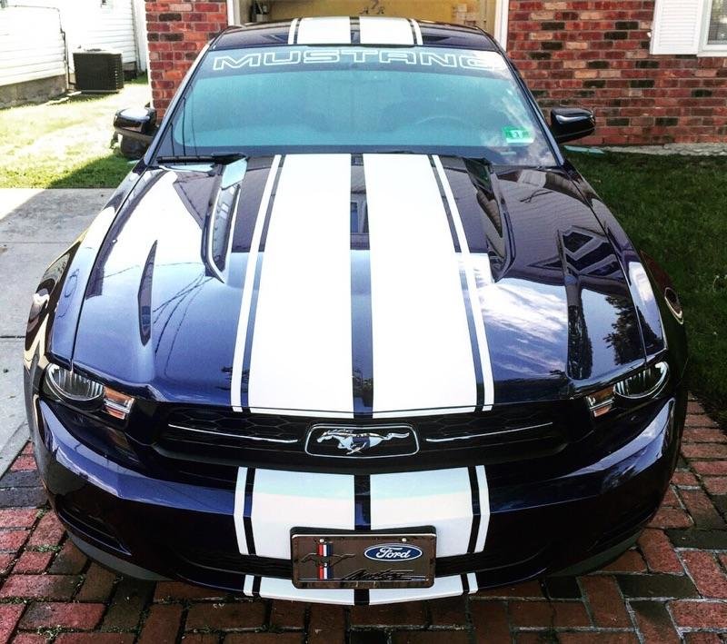

    ...^^^... Always loved that model (with those grill lights)... beautiful Mustang ... :thumbsup:

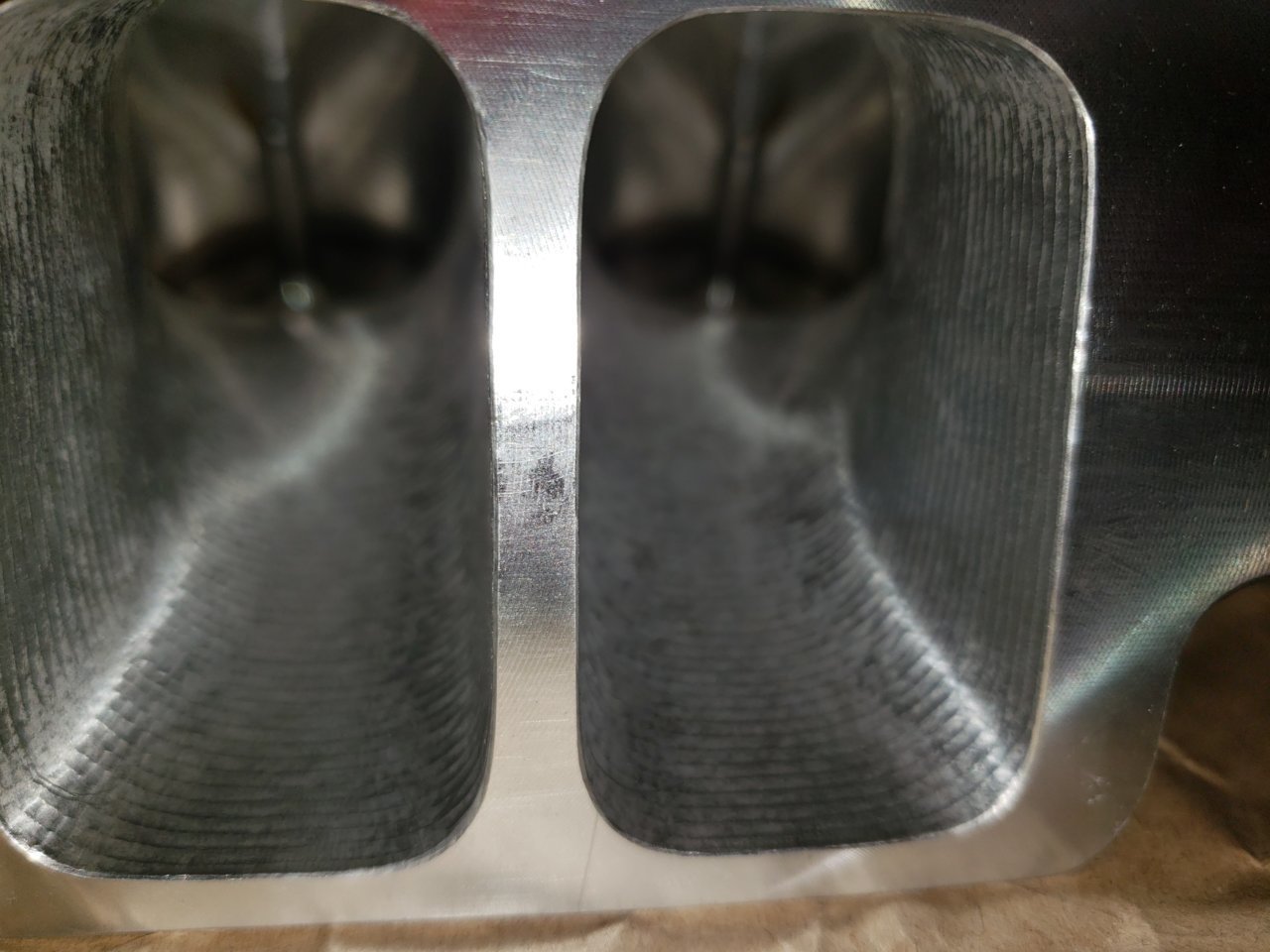

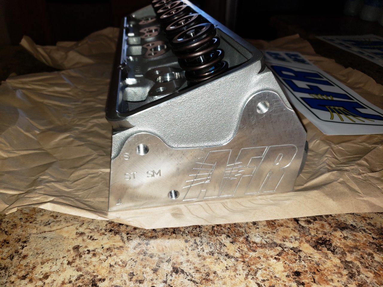

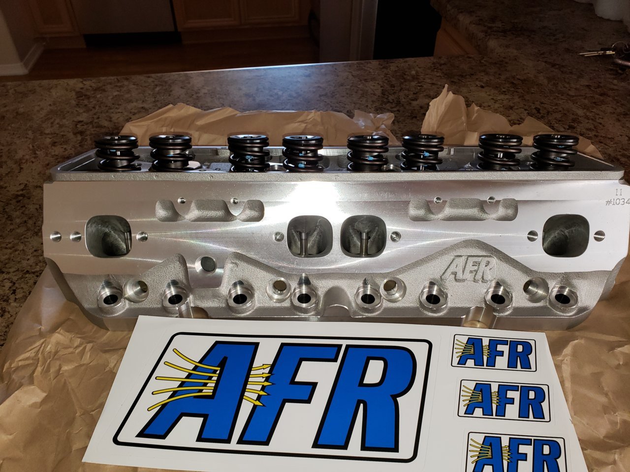

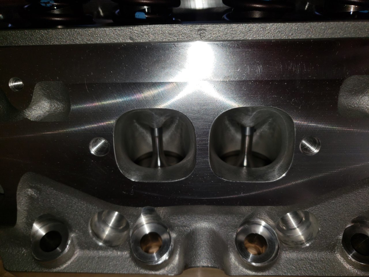

    How about some horsepower making porn !!! :burnrubber:
    My new AFR 210cc aluminum cylinder heads
    Look at the size of those intake ports and valves !! :thumbsup:
    20190524_115700.jpg 20190524_115620.jpg 20190524_115544.jpg 20190524_115518.jpg 20190524_115451.jpg 20190524_115412.jpg

    Nice. What compression ratio will those put you at?

    About 10.9:1

    What sort of cam are you running? That seems like you'd be pushing it, even with 93 Octane, unless you've got a really efficient cooling system or timing in the upper 30's...

    308 dur/ 550 lift flat tappet
    My old combo with 11.1:1 comp 16 Initial 36 total at 2800rpm ran very well on 91 octane
