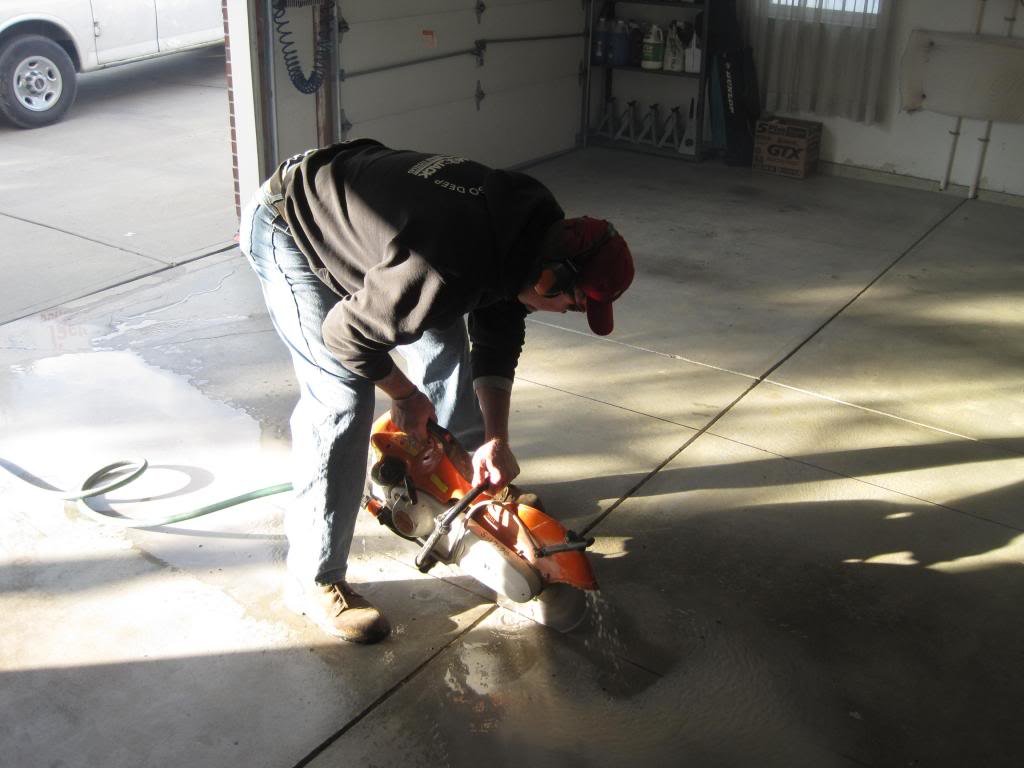

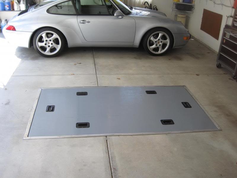

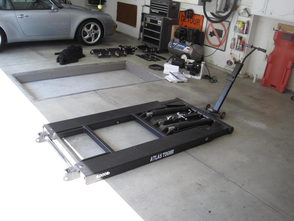

    Ever thought about possibly buying a lift to help out with maintenance? Well, I had been wanting one for years but could not get a 2 or 4 post in my garage (looked into busting / popping the ceiling out, wasn't happening due to layout) so I compromised and decided upon a scissor lift. Not the best for many DIY jobs but my fun cars are Porsches (rear / mid-engine) so access to critical areas is fine. Here goes:

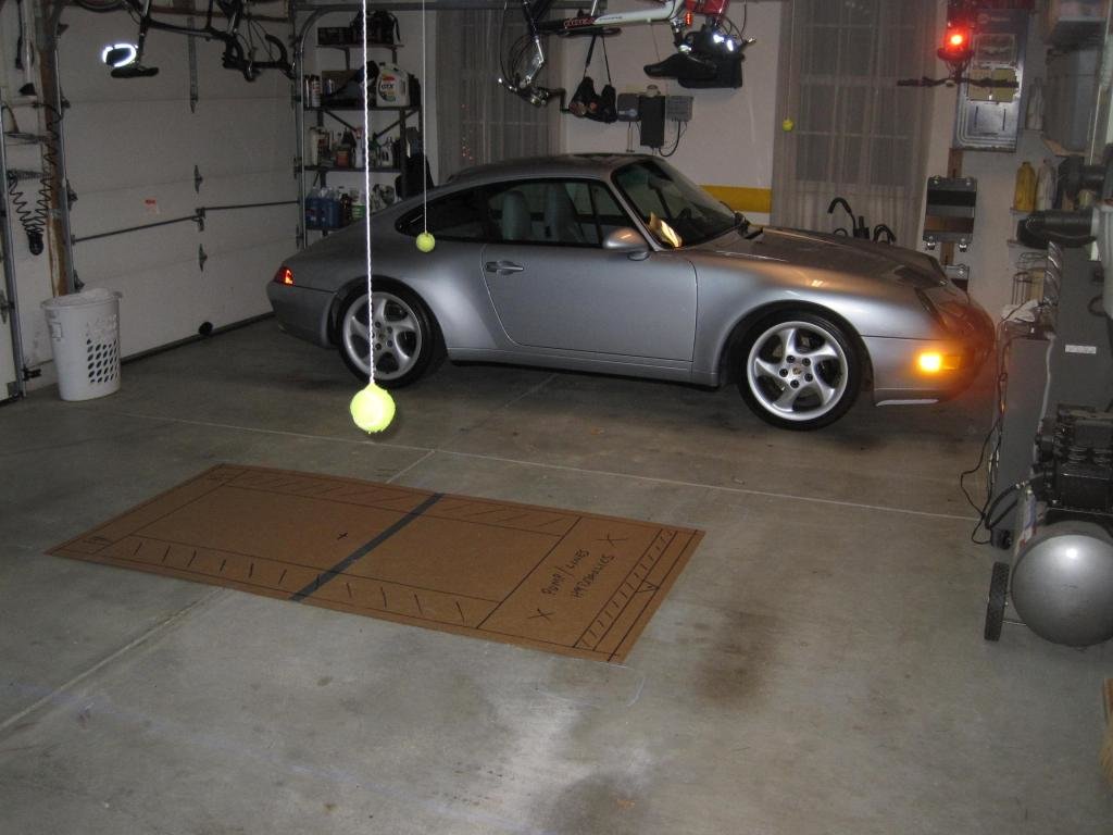

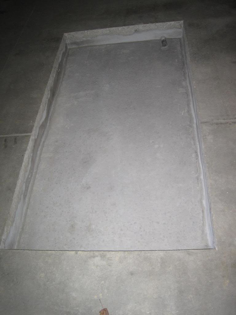

    Laying it out and measuring where to place the hole

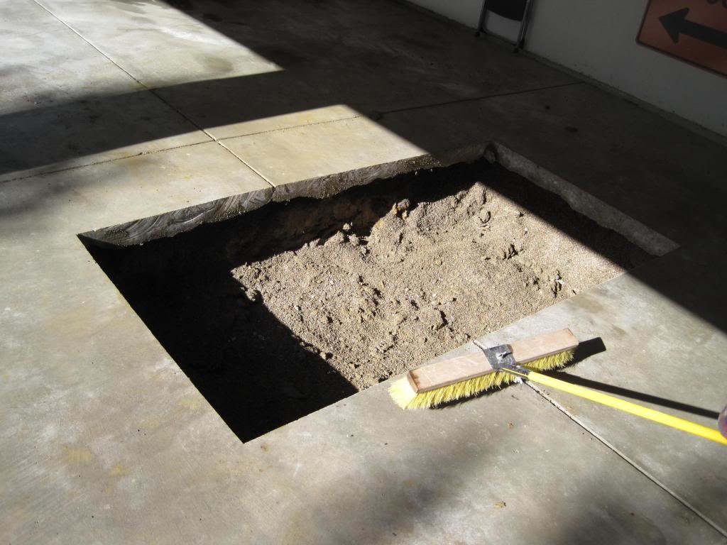

    Cutting the hole
    Jack Hammering out the old concrete

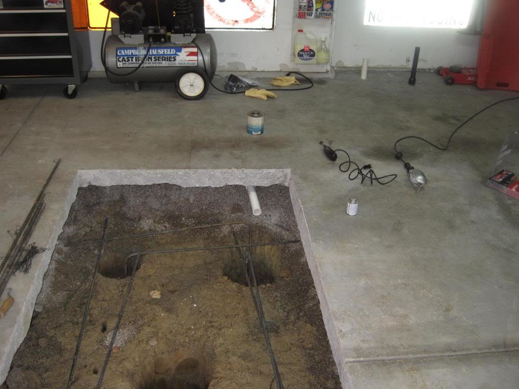

    Digging down to accommodate pad and desired depth
    Digging 5 piers 12" by 36" and running / drilling floor for PVC to hold hydraulic lines

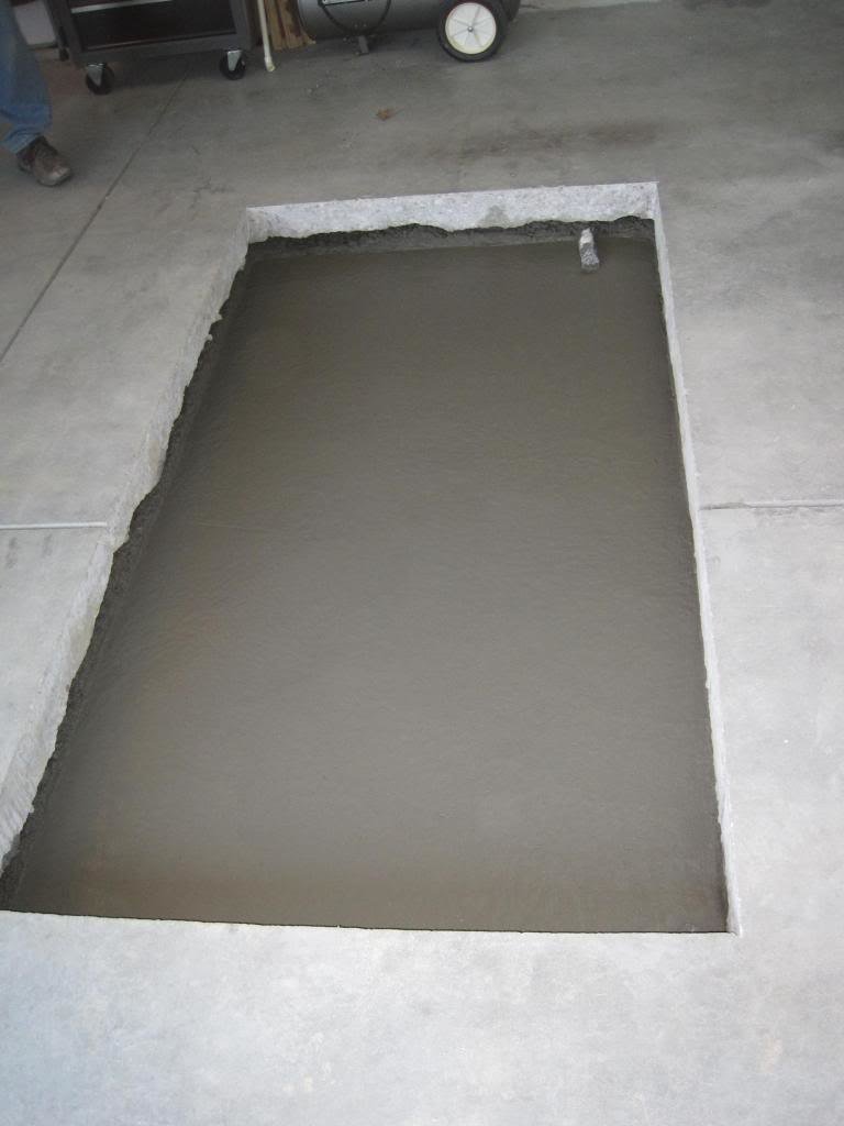

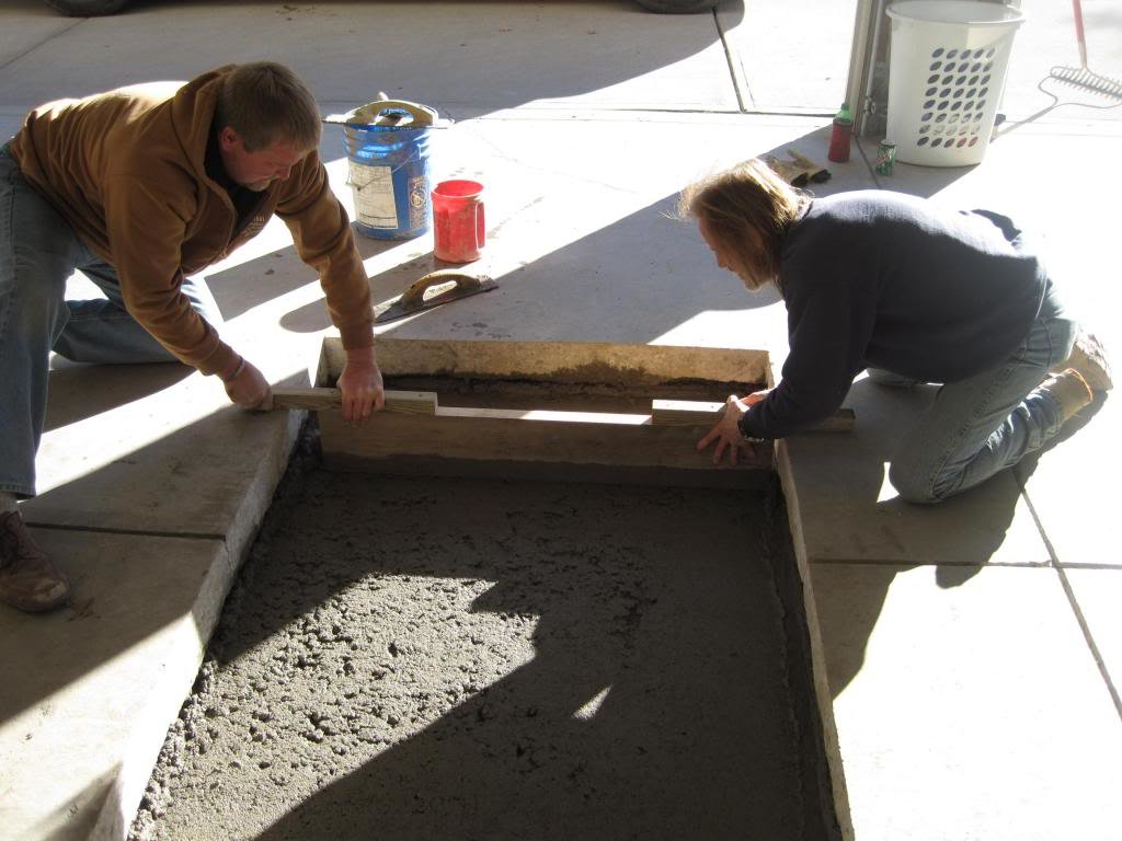

    Pouring / screeding concrete for appropriate depth
    Freshly poured concrete

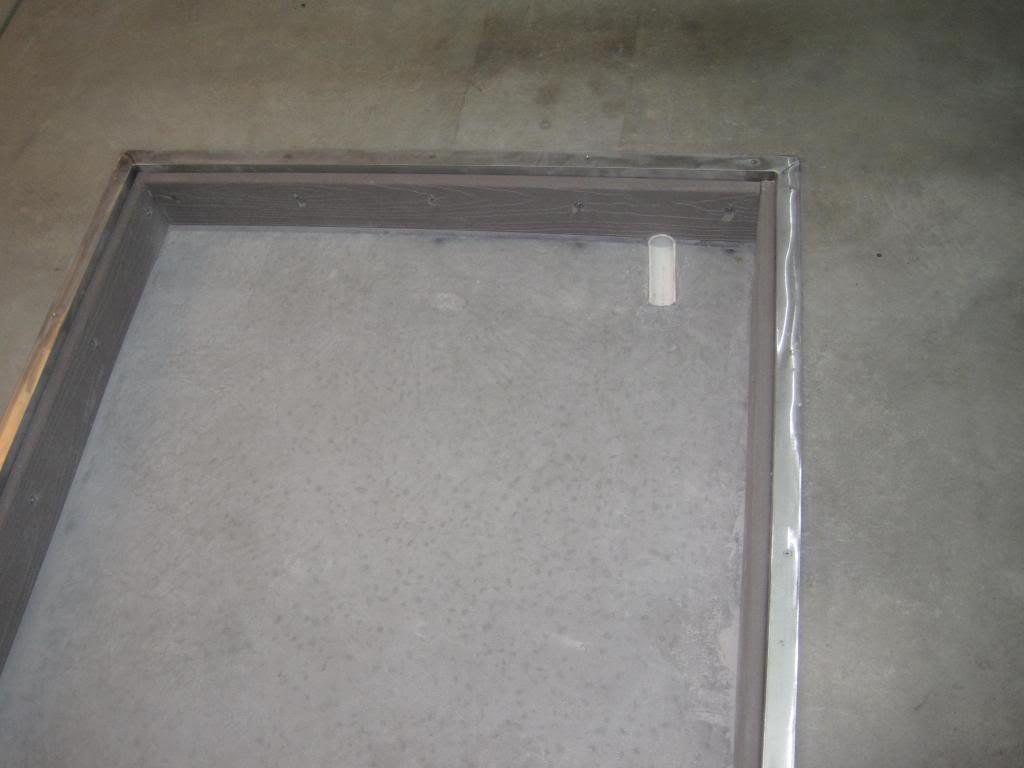

    Finished out the upright sides
    Cut, drilled, beveled, anchored and welded stainless angle that covers the concrete edge, then grounded screw heads flush and went over the whole thing with 60 grit flap wheel, cut and anchored in the composite material that the plywood will rest upon to cover the lift when not in use, also trimmed out the PVC pipes that are drains and under-the-floor passages for the hydraulic lines

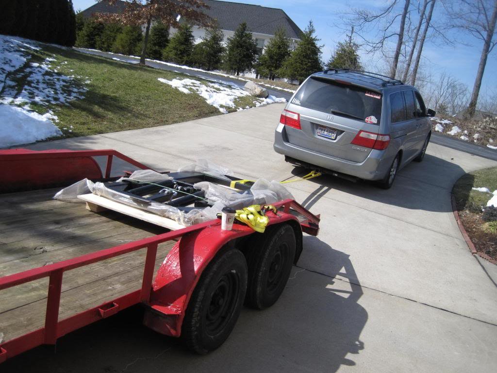

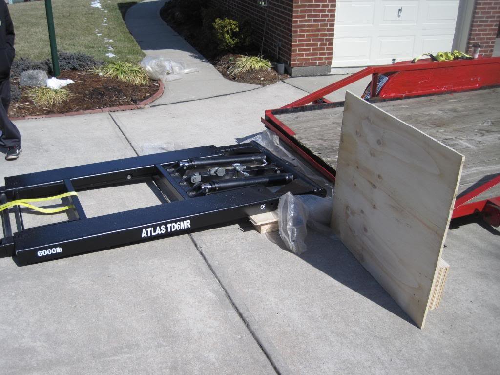

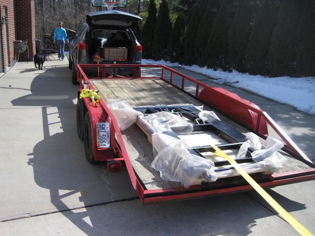

    Brought home the lift, sucker is definitely heavy:
    Drug it gently off the trailer with the wife's van:
    Got the pivot base's wheels on the ground, cut the shipping pallet in half and placed it under the trailer on the driveway for a softer landing:
    Then I pulled it off of the pallet onto an 1/8" thick plywood piece so I could get the transport dolly into the tongue and move it into the garage:

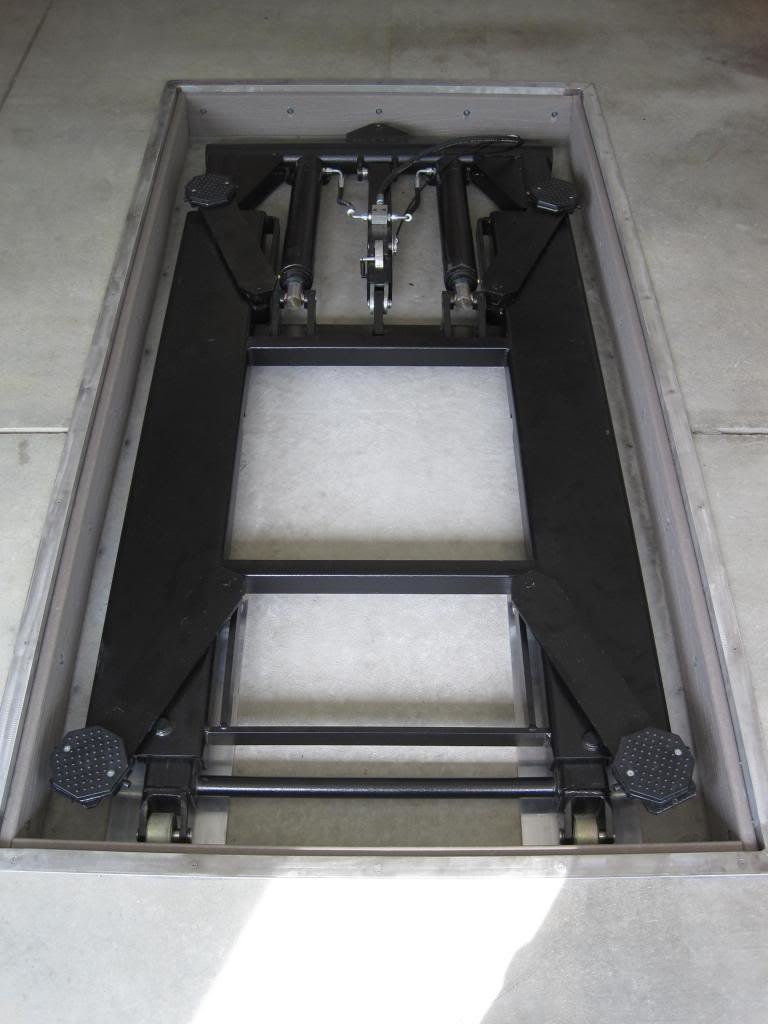

    There it sits, got 3 sizable buddies coming over to help get it into the recess and plumb the lines:
    Have a little tweaking to do on safety release cable, otherwise it fits and works like a charm:

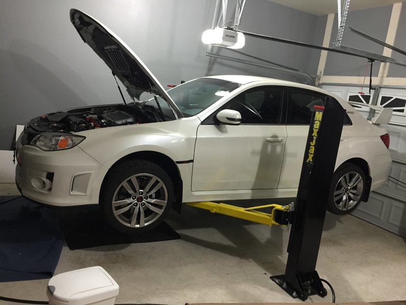

    Nice! I was able to squeeze a two-post lift in mine. Two years later, I still haven't moved the garage door opener out if the way. It gets it high enough that I didn't need to. I should get it done though lol
