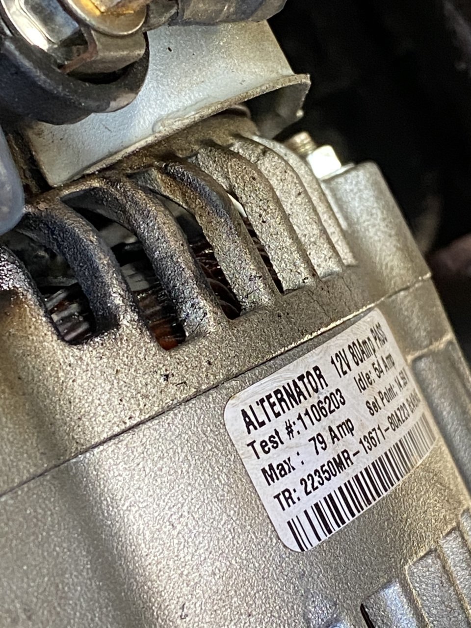

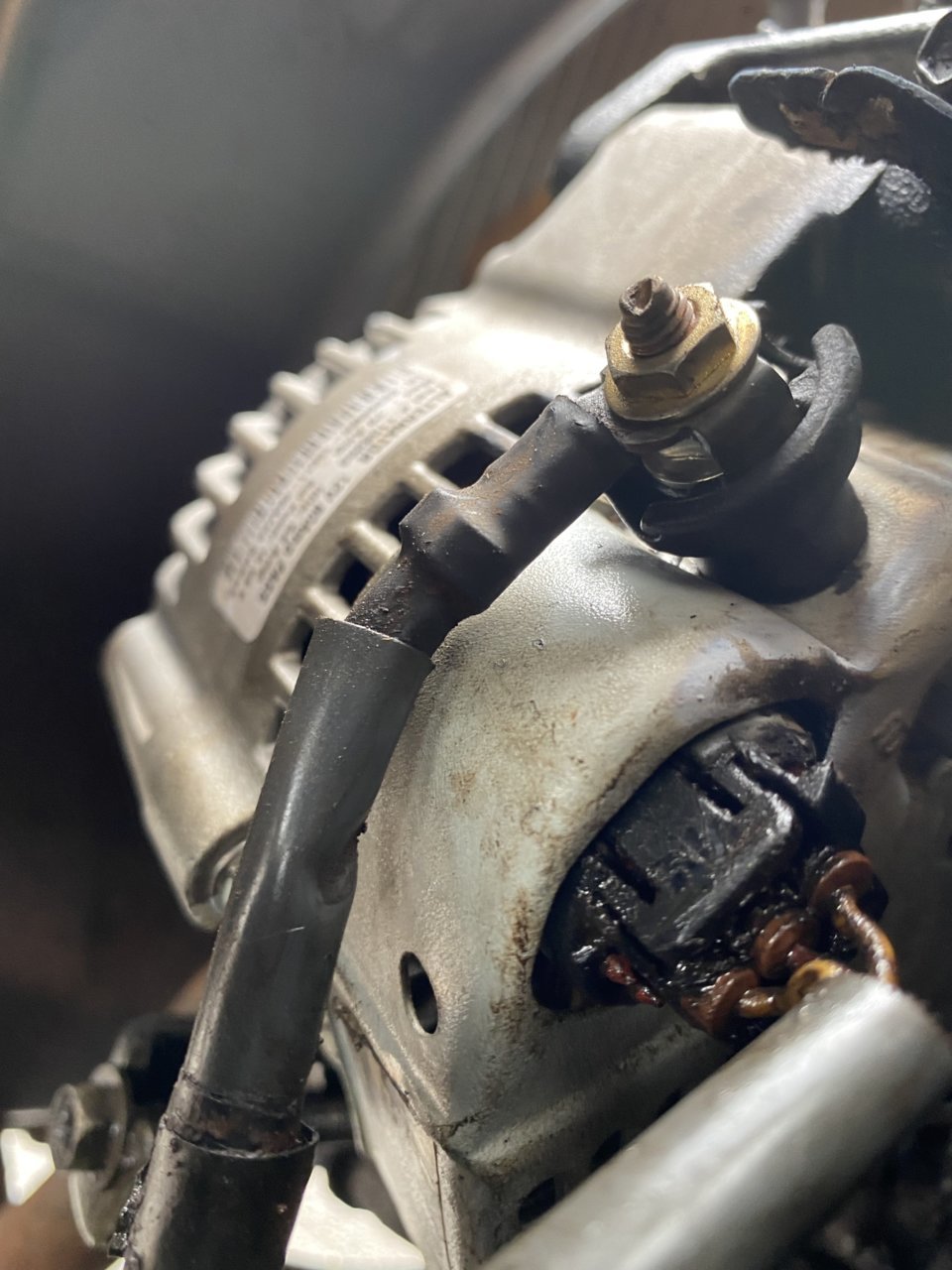

  2. May 18, 2023 at 6:28 PM
    tvrvor
    tvrvor [OP] Member
    May 17, 2023
    #424860
    8
    1999 Evergreen Tacoma SR5
    here’s a pic of the alternator afterwards.
  3. May 18, 2023 at 6:28 PM
    Dan71
    Dan71 Well-Known Member
    Sep 4, 2022
    #405129
    62
    Dan
    1996 Tacoma
    Bone Stock
    Does that rear plug come out of the alternator or is it stuck?
  4. May 18, 2023 at 6:43 PM
    tvrvor
    tvrvor [OP] Member
    May 17, 2023
    #424860
    8
    There’s some slack, but unplugging it at the position it’s in is a bit difficult in general. I’m not sure if this’ll be of any help but the alternator read at 12.6v when I checked it just now. The fire didn’t seem to reach the plug, but there’s also the factor of residual heat.

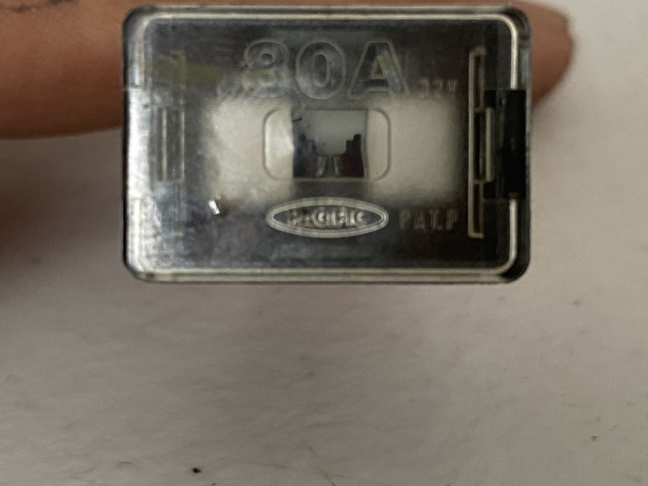

    I checked the 7.5 and it seemed fine, as for the 80 I wasn’t able to take it out since I don’t know how to lol. I can take a look at it.
  7. May 18, 2023 at 7:52 PM
    tvrvor
    tvrvor [OP] Member
    May 17, 2023
    #424860
    8
    I think that may have been the issue lol.
  8. May 19, 2023 at 6:11 AM
    tvrvor
    tvrvor [OP] Member
    May 17, 2023
    #424860
    8

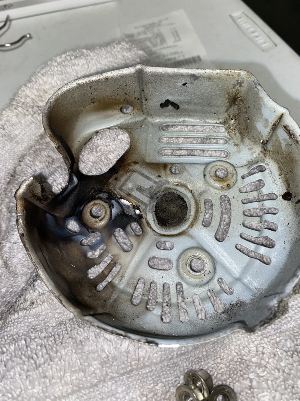

    Update: replaced the 80a fuse and the alternator was still smoking. Just took out the alternator and opened the back to take a look; she is FRIED.
    (plug wires were fine; most of the housing was fine but a little warped on the outside. used to much strength taking it out too lol)8946B45D-6B41-49D7-B3D7-4AC6D4B0418C.jpg

    SR-71A
    SR-71A Define "Well-Known Member"
    Jun 1, 2018
    #255145
    7,900
    Zack
    Southern Maine
    2012 DCSB, TX Baja Edition. Barcelona Red
    255/85/R16 Falken Wildpeak MTs, Mobtown sliders, ARB bar, SOS front skid, Icon RXT leafs, extended & adjustable Kings, JBA UCAs, OVS wedge RTT, dual AGM batteries, Gen2 xrc9.5 winch, CB, GMRS, S1 ditch lights...
    Toasty.. Hopefully Napa will cover that. Seems like some sort if issue with the reman
