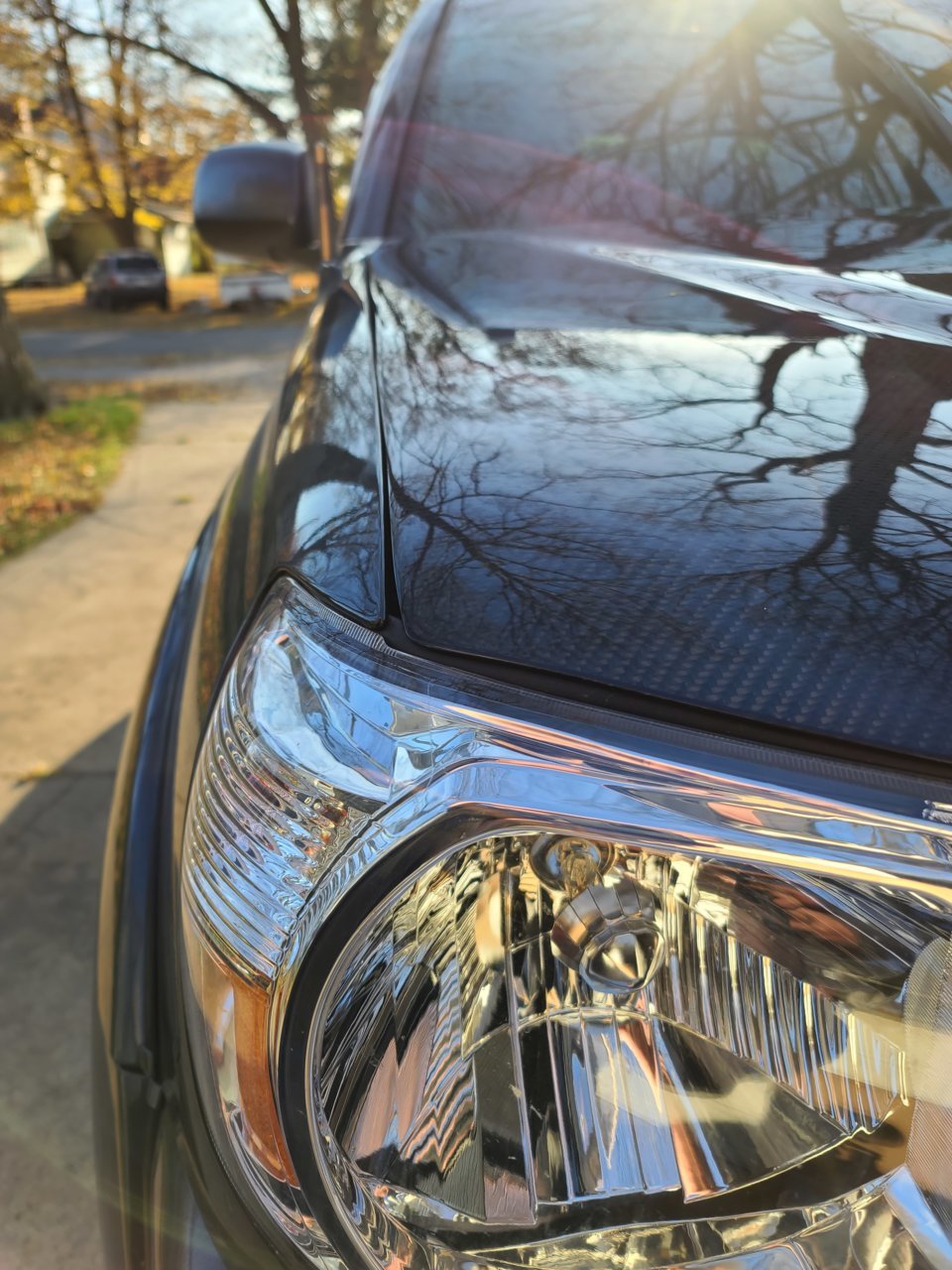

    It looks so good from 10 feet!
    Up close there is a nasty warp on the sides of the hood.

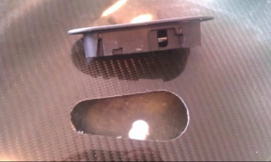

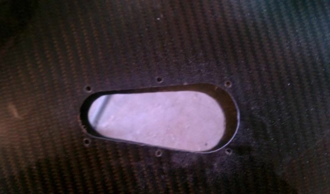

    I have a VIS CF/fiberglass hood. Uses the OEM hood latch. However, it is much more flexible than the OEM hood, so hood latches were installed.
    Used Aerocatch. The more to the center of the core support headlight scre holes were used for the hood pins.

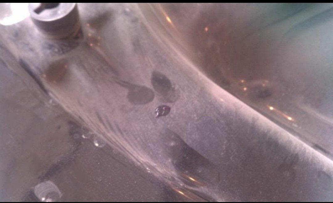

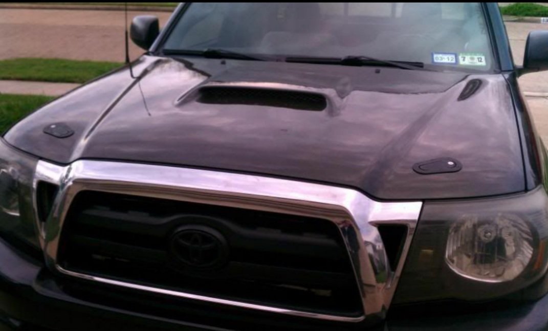

    Torspd Custom Turbo kit [] Borg Warner 9180EFR Turbo [] Haltech Elite 2500 [] TiAL Q BOV [] TiAL V44 Wastegate @ 15psi [] CP Pistons [] CP Carrillo Rods [] ARP Head studs [] ARP Main Studs [] ARP Header - Head Studs [] Ported Heads w/ 1mm oversized valves intake/exhaust [] Brian Crower Forged Stroker Crank [] Darton M.I.D. Sleeved Block [] Kelford Camshafts [] Torspd 160* T-stat mod [] APR Large Fuel Rail [] Walbro 460 LPH E85 Fuel Pump [] FueLab FPR [] APR T56 Conversion Kit [] KP RACING Built T56 [] McLeod Racing Custom Twin Disk Clutch [] One Piece Aluminum Driveshaft [] MGW Shifter [] Custom lowering kit [] Ohlins Front Coilovers [] QA1rear shocks [] Custom Ron Davis Radiator [] Dual SPAL Electric Fans []
    20201105_163955.jpg 20201105_164221.jpg 20201105_164007.jpg 20201105_164024.jpg 20201105_164158.jpg

    That's not much of a surprise, CF (and fiberglass) parts are pretty notorious for poor fitment. When you say "warp" do you mean it's not a clean, straight edge that is parallel to the fender? Or do you mean the hood itself is warped? Hard to tell from your pic but if the edge is not straight and is instead wavy I would have 100% tried to return it - that should have been a factory second.
    I have a VIS CF hood on my Integra and it fit like shit for years no matter what I tried to do in order to get it to line up. Specifically, one edge sat higher than the fender so from one side it looked like the hood was popped. Eventually, I figured out that the mounting locations for the hinge brackets were off. This caused the whole hood to be warped when installed. I ended up slotting the holes in my hood hinges which took the tension out of the hood and in turn the warp as well.

    By wrapped I mean the edge that should be straight has a 32nd to 1/4 to 1/16th to 1/4 and back to 32nd....on the same side.

    Could be smoothed out with a little sanding and a shot of clear.

    Could even play a little with fender adjustment.
