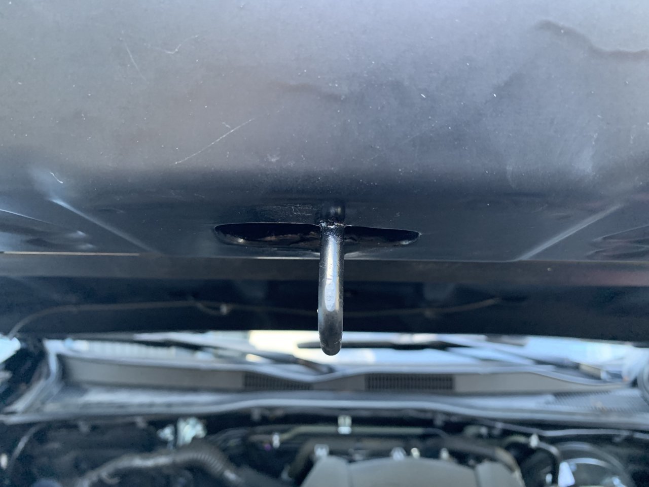

    To be honest, I'm not sure if there is. But, only because I don't know too much about all that. Here's some shots and a video of it latching if that's helpful though. If someone figures it out, I'd love to avoid pins if I could. Not trying to get revved at lights by civic or anything. :rofl:

    Finish looks decent. Latching looks questionable in regards to strength. Its concerning since driving with stock hood you could see the hood fluttering from the built air flowing from engine compartment. Thanks for posting.

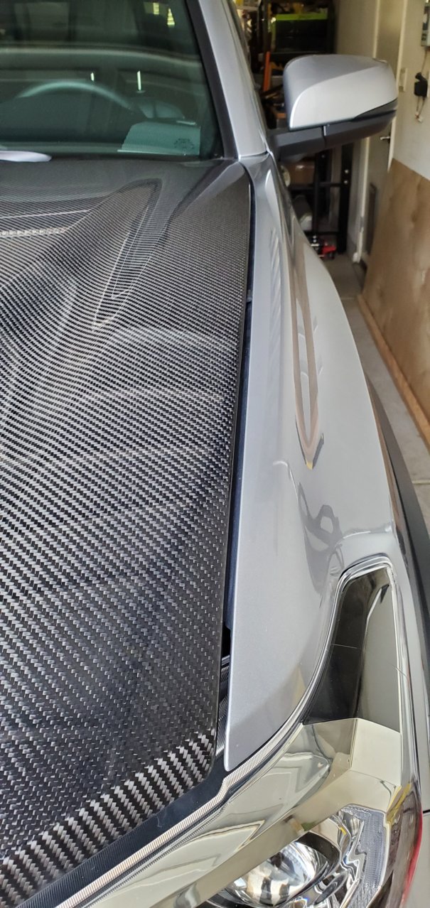

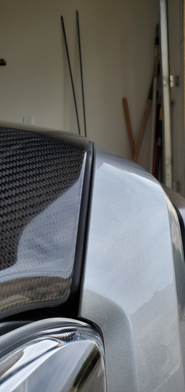

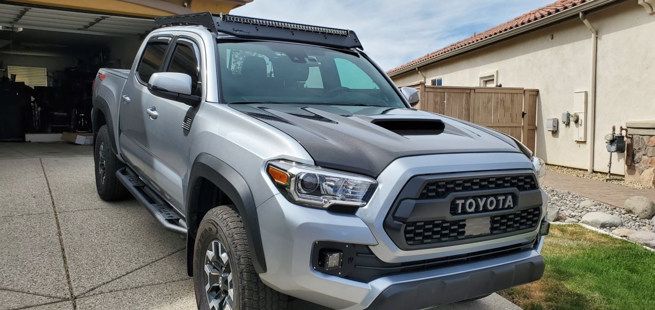

    Here you guys. CF Hood on Silver Taco. What da ya think? Video will come when I get my new headlights and low pro bumper installed.
    * Things to note:
    1. Installation was easy. (Two person job). New bolt supplied. Do use the set that comes with the hood. Do not use the original bolt! Don't over tight them or you will hear the dreaded crack noise. Snug is good enough.
    2. Alignment takes no time at all. 15 minutes top.
    3. Latch perfect to the car. Did not have to play with the alignment at all.
    4. Windshield washer nozzle assembly hooked in place nicely like OEM fit. No play. (I did not get the weird angle spray. It spray perfectly).
    5. Be careful not the push the hood down too hard. It's thin. very thin.
    6. Ripple effect during the drive at 25-90 mph is not a problem. I was actually surprise it handle the way it did. Doesn't give me any sign of worry. Windy day too. (Hood scoop blocked off. I didn't remove the cover)
