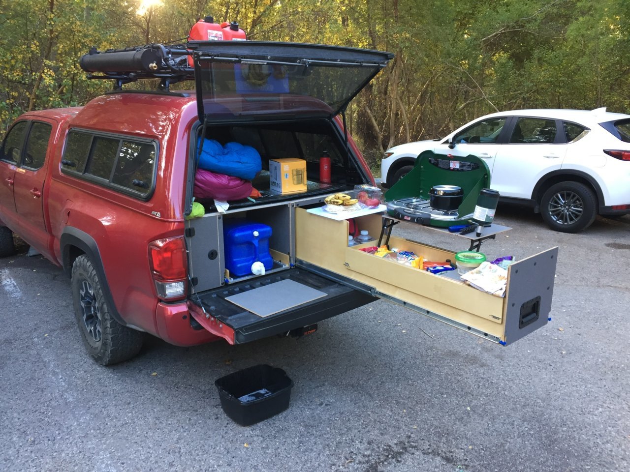

    Has anybody be done any diy drawers for their long beds? I’m just looking for ideas I’m trying to build my own drawer system just for camping purposes.. just looking for ideas and pictures I have an idea of what I can do but building it will be a challenge because it would my first time trying to build it... or just buy a decked system

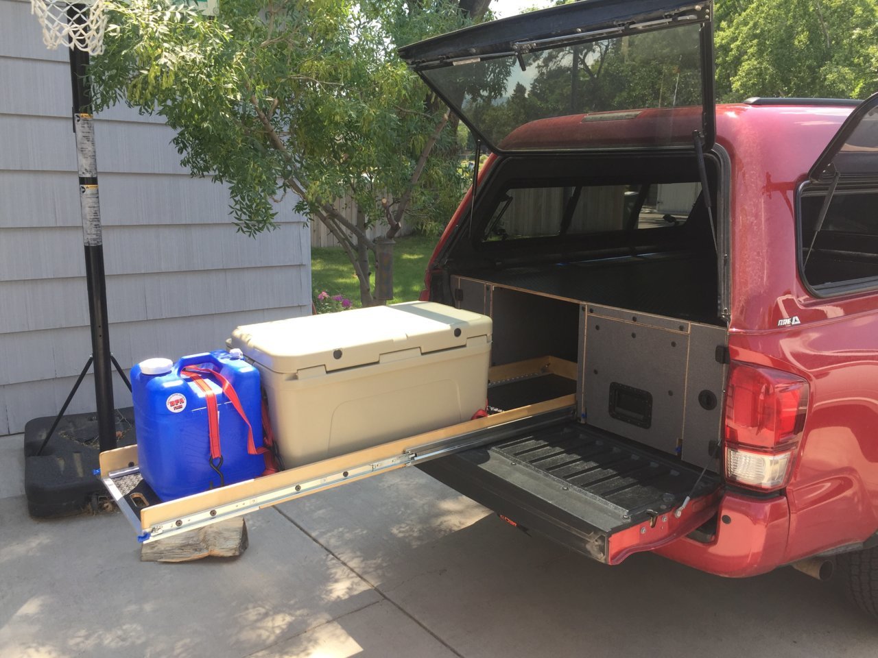

    I framed it out with extruded aluminum and skinned it with 1/4ish ply. Top deck is 1/2 ply with rubber coin flooring on top.
