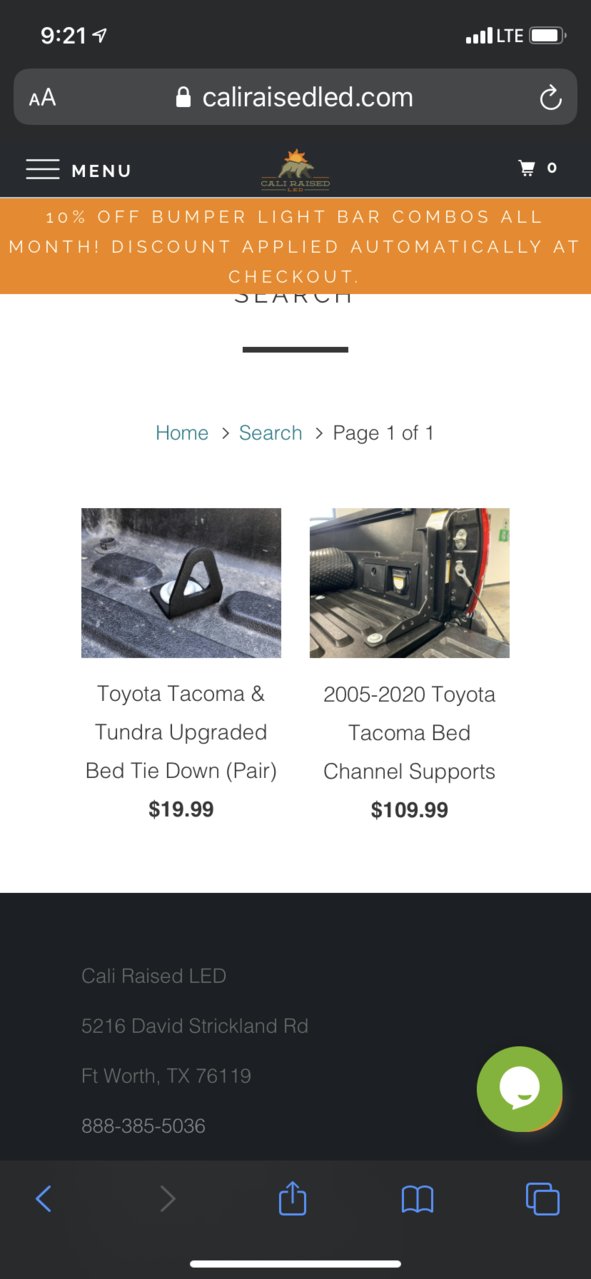

    Those rails are all but useless for tie downs I’m adding these up by the cab I’ll probably put something that will lay flush in the middle. No idea why they only added the 2.76EC6847-A927-4CCF-888D-200764C0D678.jpg 76EC6847-A927-4CCF-888D-200764C0D678.jpg

    Thanks so much for that site! I just bought two sets of the bed rings. No tax and free shipping. Cant beat that!

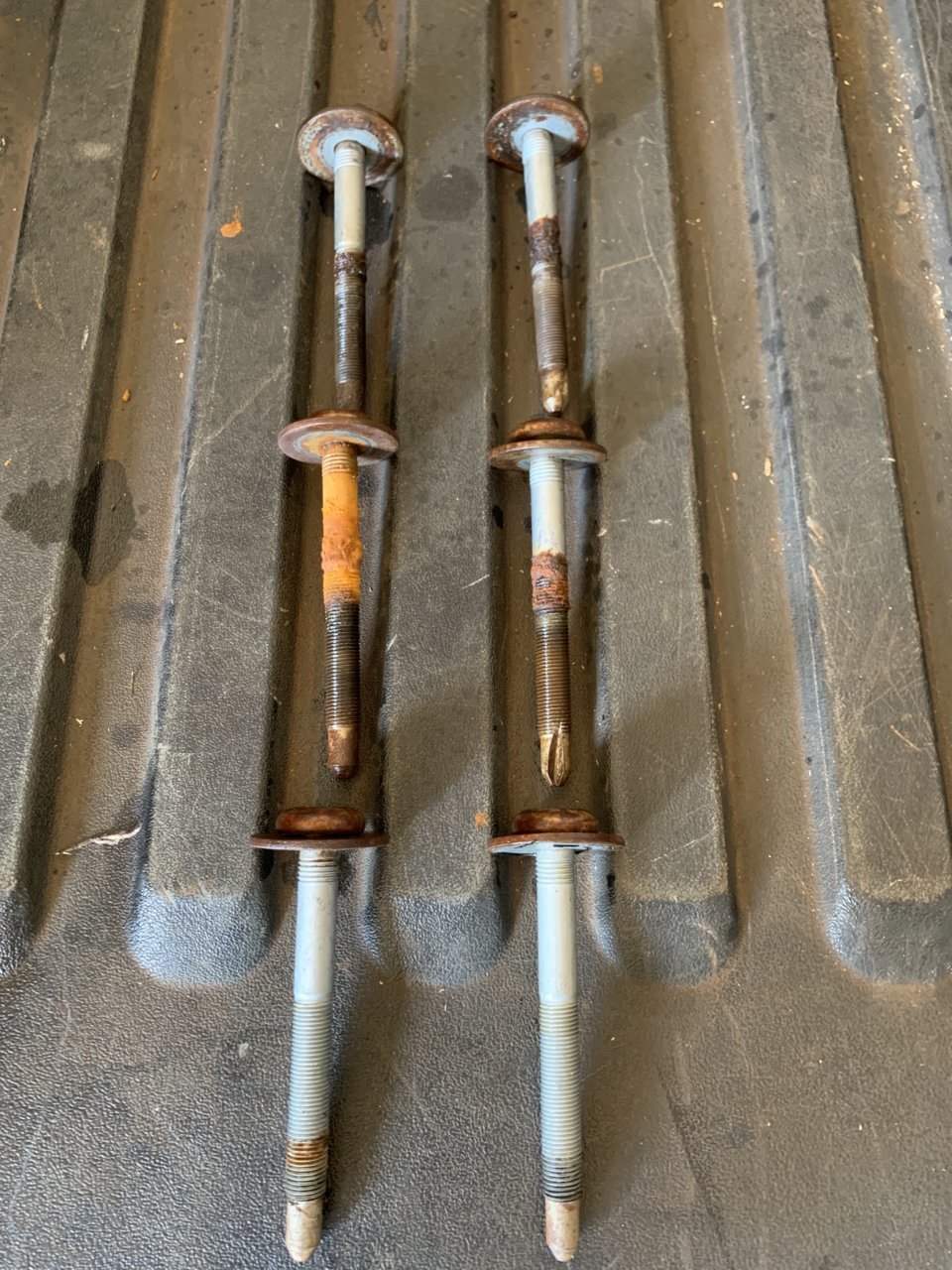

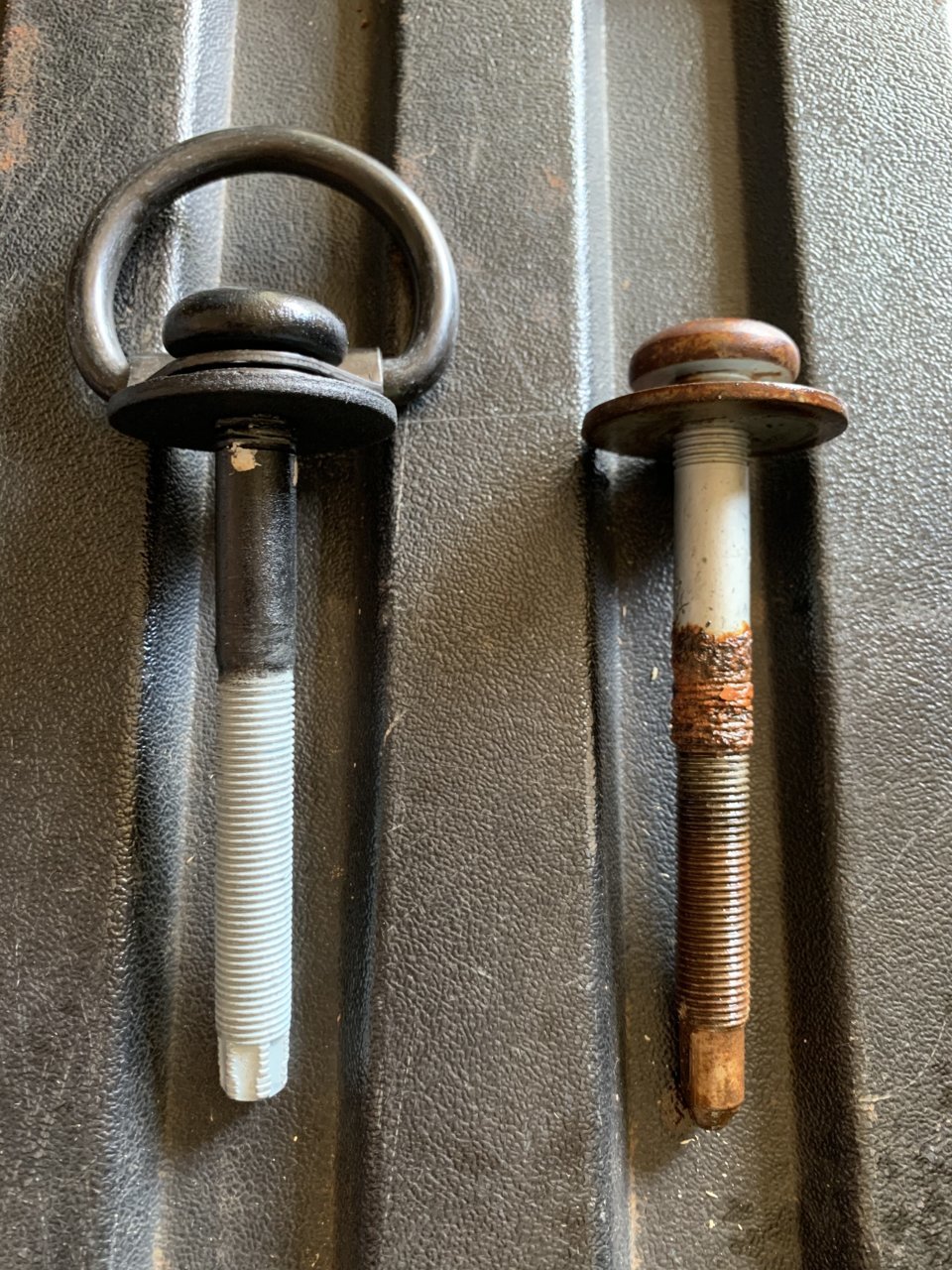

    Speaking from experience, start soaking those bed bolts with PB Blaster from the top(right beneath the bolt head and washer) and under the bed where the threads are. Do this each day until your bolts come in at least. Also, clean up the threads a bit the best that you can. I replaced all 6 bed bolts recently and the 2 bolts by the tail gate were the easiest to remove. While you have them out, put a little anti-seize and if you want to go the extra mile, paint the bolt heads and washers.
    Edit:
    Old ones
    New one in comparison
