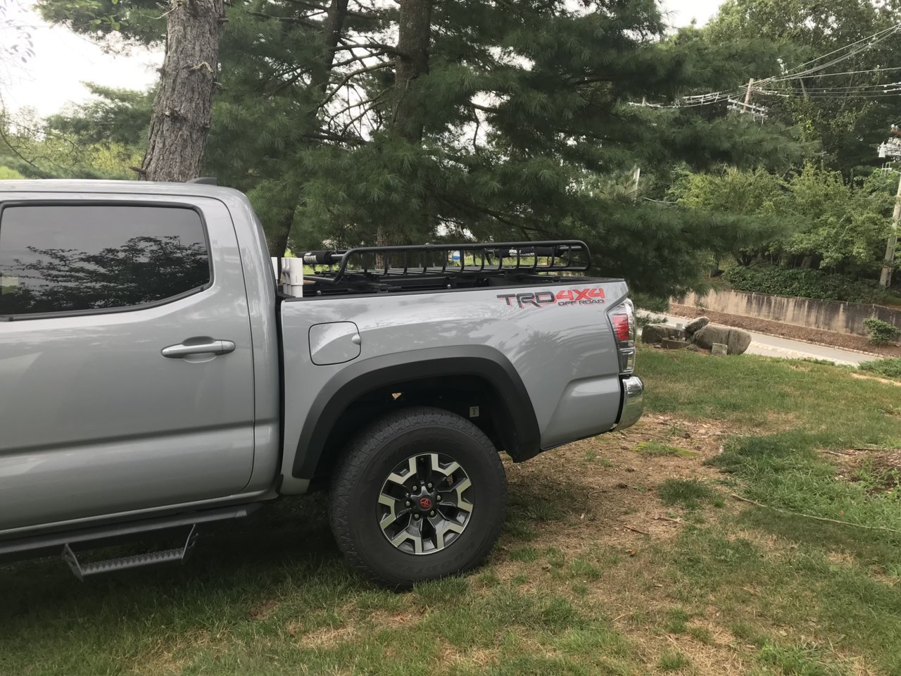

    B9721D8C-B7AD-432C-8FED-4073B7B662BE.jpg This is how I manage camping gear I use bins on top and underneath I was lucky and found the basket on Craigslist cheap. Yakima mega load warrior just about covers the whole short bed.

    Thanks for the input. Unfortunately I don't think that style of bed rack would work for my purposes. Hoping somebody has come up with some alternative mounting options for bed racks that don't have typical cross bars, for accessories like a cargo carrier that require typical cross bars.
