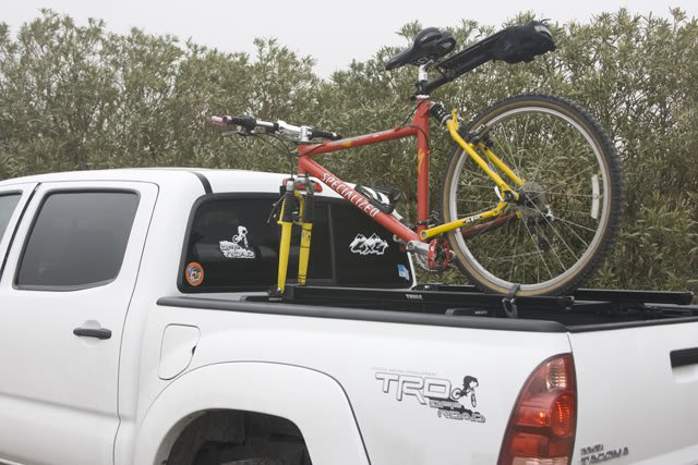

    Problem you have with that kind of setup when using the Toyota cargo bars is the fact that there are no real bar ends. You're almost better off getting a Yakima (or Thule) roof rack and using their parts entirely.
    Here's my setup for my bike. You can see how the cargo bars attach. Thinking about it though you MAY be able to use the loop straps if you get another set of the large tie downs and use that as your loop attachment point.

    Thanks for the pic. Helps me think through this a bit more.
    The one end is fixed and attachs to the middle, so no concerns there.
    I was thinking one of two options for the loop. Either drop it down the hole on the end of the rack and loop it around the round handle OR try to find/make something that'll attach to the rack itself and work as a hook. If there are any spare parts out there that would work, I'd love some ideas.

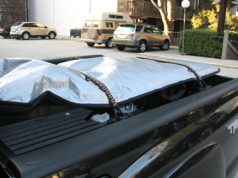

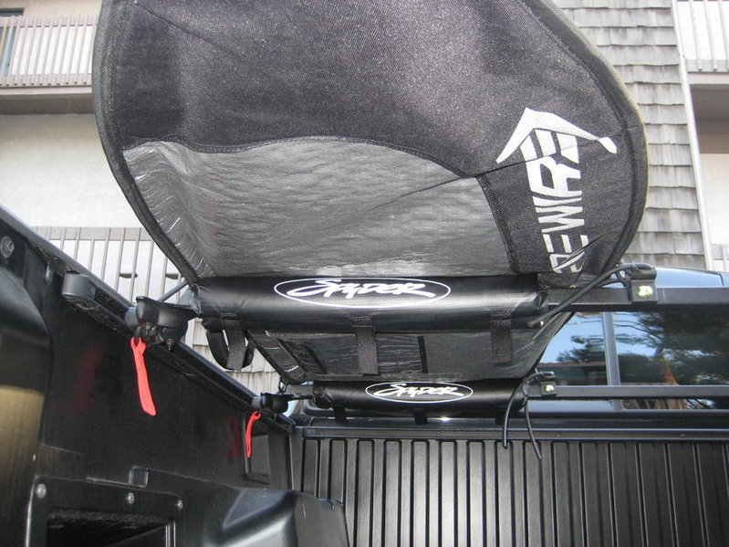

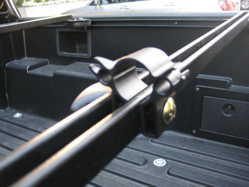

    Well I did some work on the Cargo Bars and bought the Strap Thangs, against the saleskids advice. The fixed attached side is made to fit Yakima bars ONLY, because they are round (Thats why he didn't want me to buy them). Well, I tinkered around with it, and was determined to make it work. I took off the end cap and slid the piece into the groove of the crossbar. Then I drilled a hole through the cross bar so I could secure that side of things.
    Here's a picture of the set-up with a board on it:
    This set-up works, but I could use some ideas on where to hook the looped side of the cord. I'm currently using the bottom groove of the D-ring, but I'm thinking that something else might work better. Any ideas?
