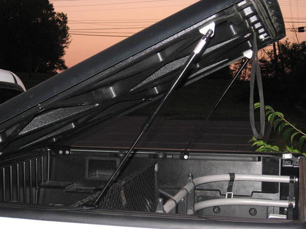

    I have an Undercover, but not a bed divider. I believe the bed divider would work, but you would be limited on where you can put it because the Undercover attaches to the rails in 4 spots.
    Here is a pic of how the Undercover attaches:
    You can see the three silver bolts, which is where the brackets are. Since I think the divider has to slide into the rails from one of the ends (someone correct me if I'm wrong), then you would have to remove brackets closer to the bed if you wanted to move the divider from one side to the other.

    Also note the cargo divider would probably have to go behind the strut mounts, as the struts will probably hit it when down.

    This would appear to be the case, with the cover in the closed position, the gas struts use all the space from their connection forward (to the tailgate). You are limited to using the OEM cleats behind the strut connection point on the rail and to the back hinge connector. Not a lot of usable space. If you were wanting to use a bed divider and have it easily accessible from the tailgate, this setup won't work well.
    I'll also note that KB Voodoo's cargo management basket also relies on the OEM cleats, and thus would also be relegated to the same small area of use as the bed divider. (middle area of bed).
