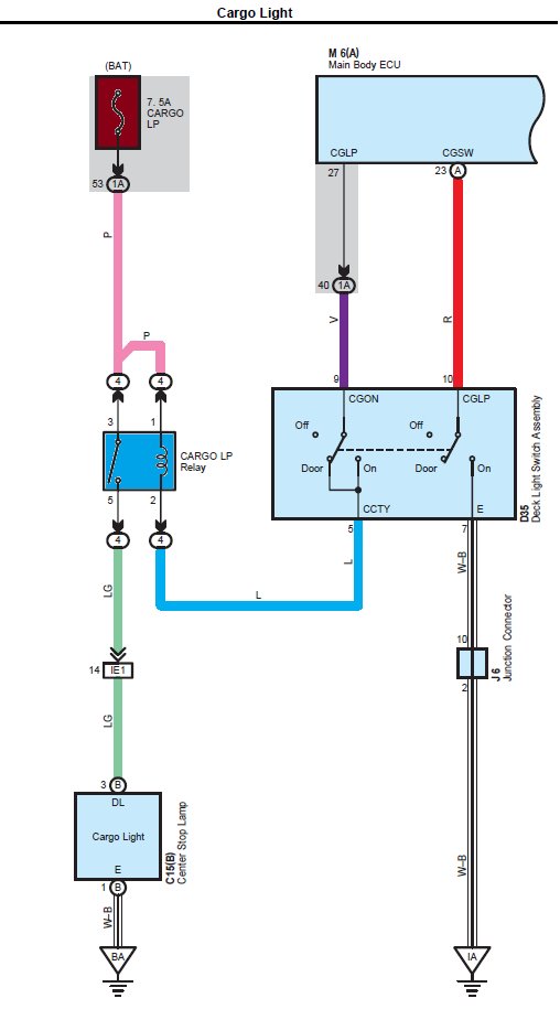

    No...the Cargo Light Relay has constant positive...the switch provides ground to relay, this goes into the Main Body ECU (if switch is DOOR or ON) if switch is on DOOR then Main Body ECU provides path to ground via purple wire (closing relay coil = light ON); if switch is ON, then switch provides ground via another wire (red)
    This is a simplified view of circuit, there are other components to it. (door sw's, unlock detection sw's, door lock control receiver)

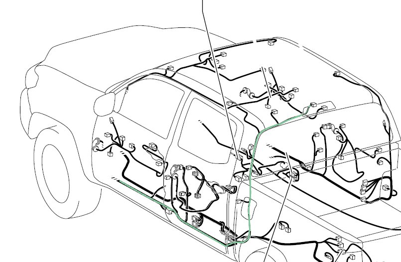

    upload_2019-5-12_4-24-7.jpg route of Cargo Light green wire
    OP, this dimming and flickering is always while vehicle is ON? Cargo Light stays this way as you drive?

    Are you sure the green wire is the cargo light? Seems like the next wire over is since it is probably connected to the cab lights in some way, you can make the cab lights/cargo light come on with doors opening closing by switch position. Just a thought.

    I'm assuming the blue describes your headlight switch; red and green describe the cargo light switch.
    If so, my thought is the blue wire in the wiring diagram is grounding out, poorly; causing the cargo relay's coil to 'chatter'. The cargo is not supposed to be on with the headlight switch alone.
    When the relay receives a clean ground from the ECM/cargo switch, it works like it should.

    I'd pull the relay and check resistance to ground on the socket for pin 2.

    No..the blue is the ground wire coming from the relay to the Cargo Switch.

    Yes..it's the green to the Cargo Light
    jmauvais[QUOTED] likes this.

    Blue refers to what I highlighted in OP's post.

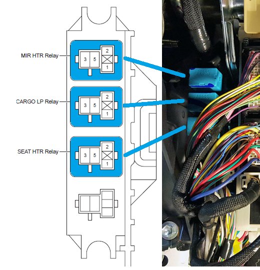

    Remove the Cargo relay and the Mirror Heater Relay. Place Mirror Heater relay in Cargo spot. Verify.

    There's no relation between the headlight switch and the cargo switch except the vehicle power source and ground. :rofl:

    I know...I say as much; "The cargo is not supposed to be on with the headlight switch alone."
