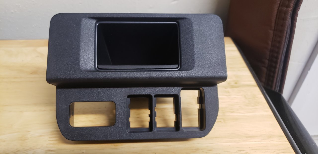

    Above the cab fuses, you'll need to remove the lower dash panel steering side.

    Some have removed the whole relay block out thru the cubbie without removing the lower dash panel...
  6. May 12, 2019 at 9:57 AM
    #26
    caribe makaira
    caribe makaira Well-Known Member
    Feb 13, 2011
    #51121
    11,786
    Caribbean, Puerto Rico
    05 PreRunner TRD Offroad AutoTrans
    Hood Struts, My version Fogs always ON, Map & Overhead Light Mod,
    That's the "cubbie"

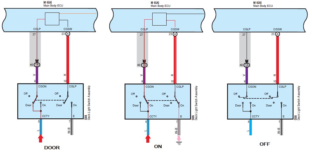

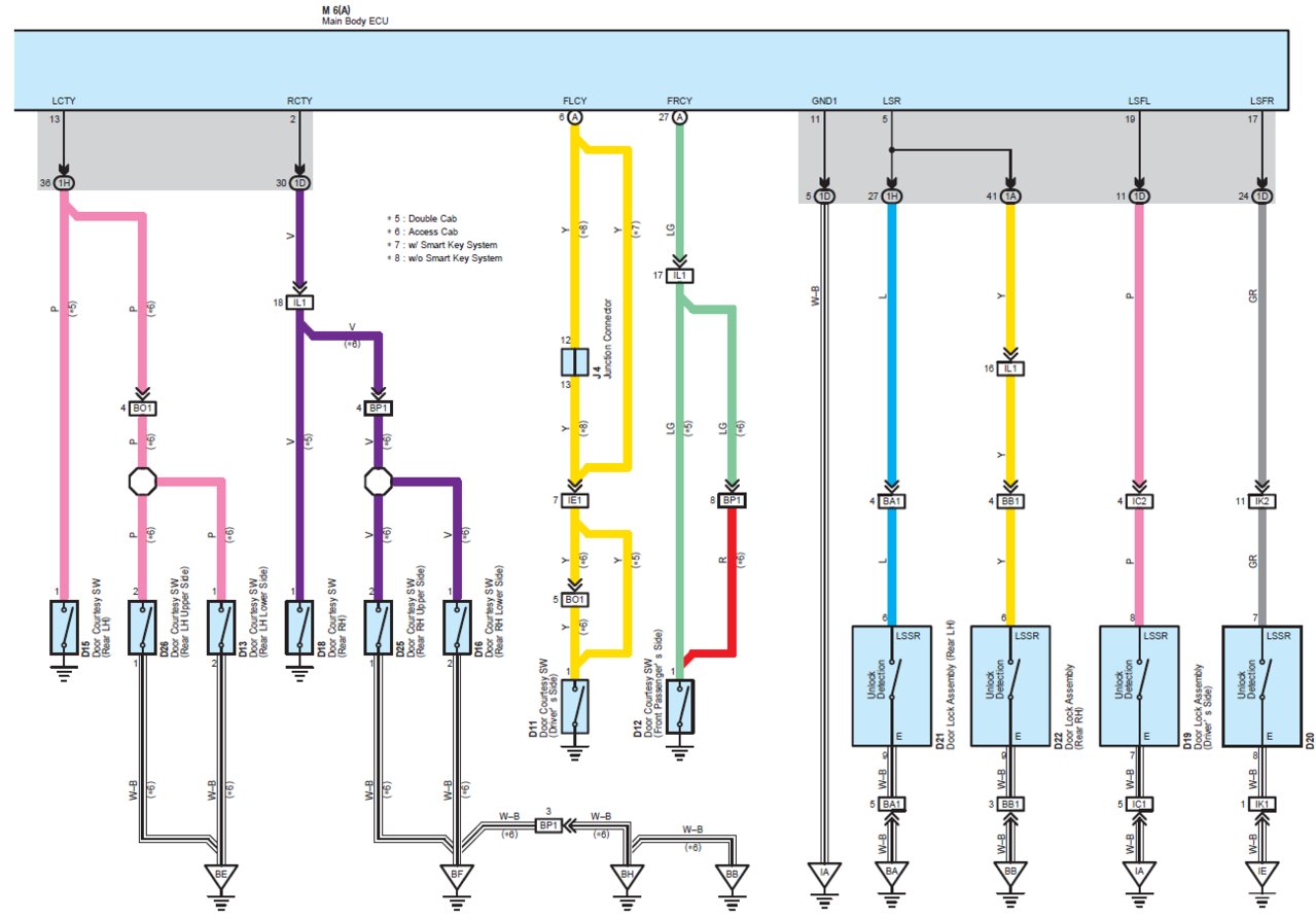

    So it's not the relay or the switch. Next level, without getting too expensive, the door shut pins. But if it were them the inside cab light would do similar quirk...so it's pointing again to the Body ECU...$$$
    These are the related switches to the Cargo Light circuit, they also are tied into the cab illumination.

    Cargo Switch at DOOR Body ECU manages ON/OFF...Cargo SW at ON bypasses Body ECU... Cargo SW at OFF=OFF
