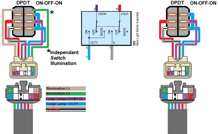

    Yes, from relay wire to mating connector. They left out the pin and wire on the receiving end.

    That switch will not do. It'll give you ON - OFF. You need an ON-OFF-ON type, with independent switch illumination.

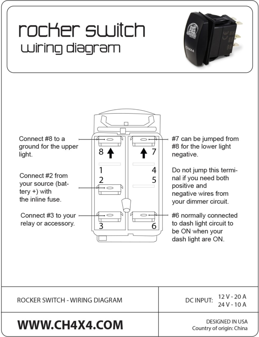

    maybe I screens hotted the wrong diagram

    Or they have the incorrect information on that switch. It's missing pins for a DPDT type.

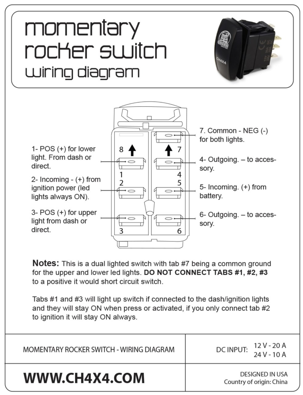

    this is the diagram (both diagrams under the switch I ordered) for a MOMENTARY DPDT switch, though mine is not supposed to be momentary. ill cancel the order asap if this isn't right and maybe maybe pay more attention while ordering another. its the weekend, I highly doubt they've started etching it for me lol

    The OEM switch doesn't illuminate to indicate position, only to find it at night. For that pin setup you'd place the positive of the LED's 1 & 3 to positive switch illumination wire (Green) and the shared negative 7 to negative switch illumination wire (Beige)

    The switch you have posted is a MOMENTARY type (ON)-OFF-(ON)...incorrect one. ON-OFF-ON is what you require.

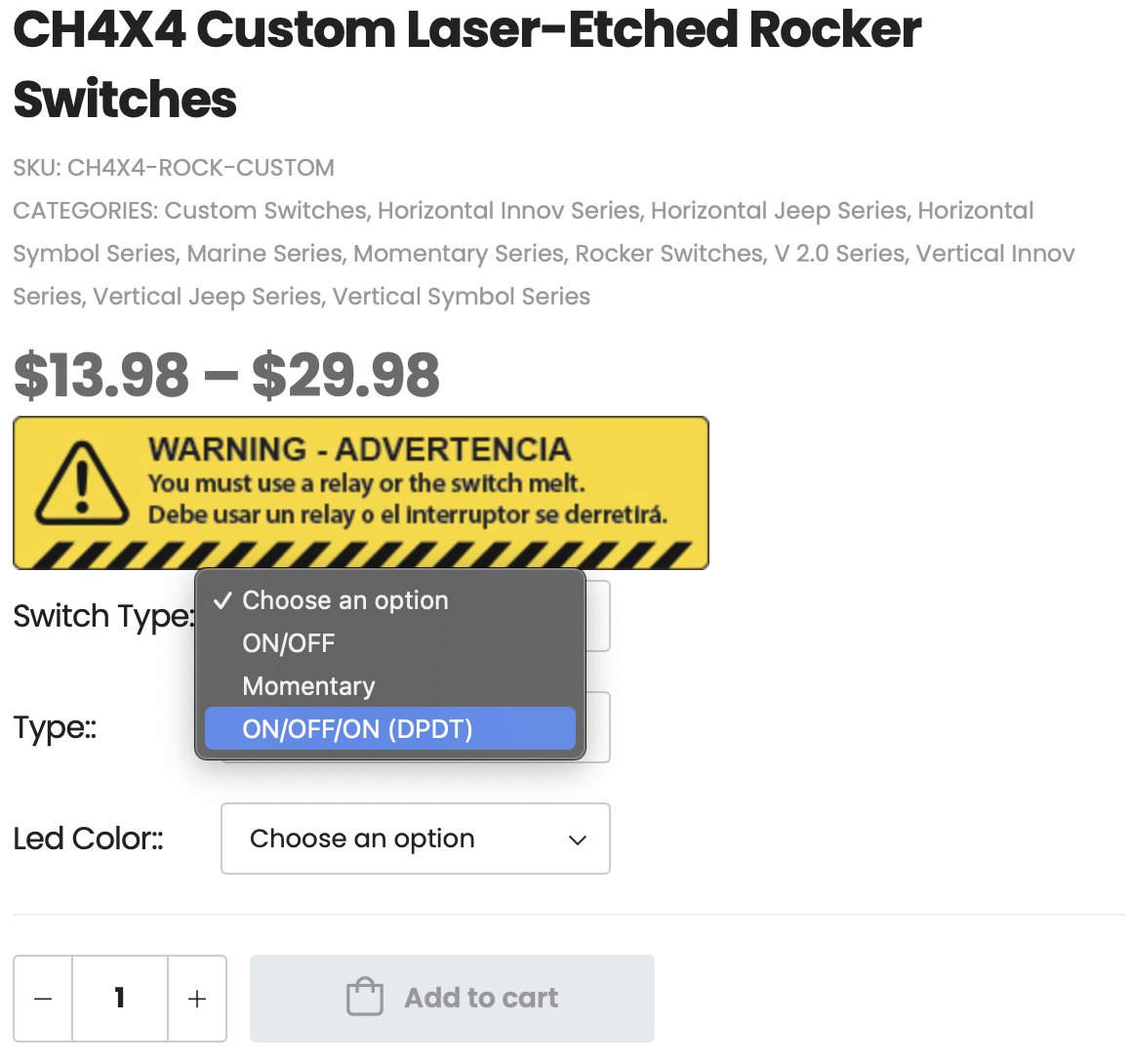

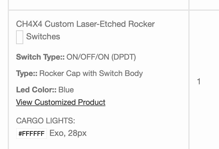

    yeah I noticed. Here's what I clicked when making the custom switch. I see lots of links to CH4X4 on here so I assume they do good work. Despite the diagrams on their product pages, Id think they'll send what I selected. also, the confirmation email shows it as ON-OFF-ON (second picture)Screenshot 2023-04-01 at 5.40.19 PM.jpgScreenshot 2023-04-01 at 4.32.00 PM.jpg

    The switch I linked has the Toyota Small form factor, blends in to the other dash switches. It's a shame they don't have selection for customization of the switch face. The CH4x4 will stick out from the panel hole not like the OEM switches.

    Don't connect the ground to the select position, look at the drawing. It shows it's not use. You'll only connect the switch illumination.

    Think of the reason the OEM switch is a Single Pole Double Throw. One circuit -OFF- the other circuit function.

    Switch came in, I ended up ordering a six pin non illuminated DPDT switch. all black and the lines and shapes of it kinda match the truck. doesn't look like aftermarket so I'm fine with it. I saw this in another thread, this is how I should be wiring it, correct? this diagram just makes more sense to me than the one you created on page 1. not to say I understand why 7 and 10 need to connect at the same time as 5 and 9, and only 5 and 9 when switches the other way. to my understanding 5 and 9 gives you door lights, 5 and 7 keeps them on... like I said I have 5 and 9 jumped until I wire the switch, out of curiosity the other day I jumped 5 and 7 and that turned the lights on regardless of door so on one side of the switch I "could" have 5 in the middle 7 on top (on) and 9 on the bottom (door). I'm sure there's something I'm missing?

    In order to duplicate the missing Toyota OEM switch it is so. Or find out the expensive way..:burp:

    I don’t understand the diagram but I will mimic it exactly. This is the way.
