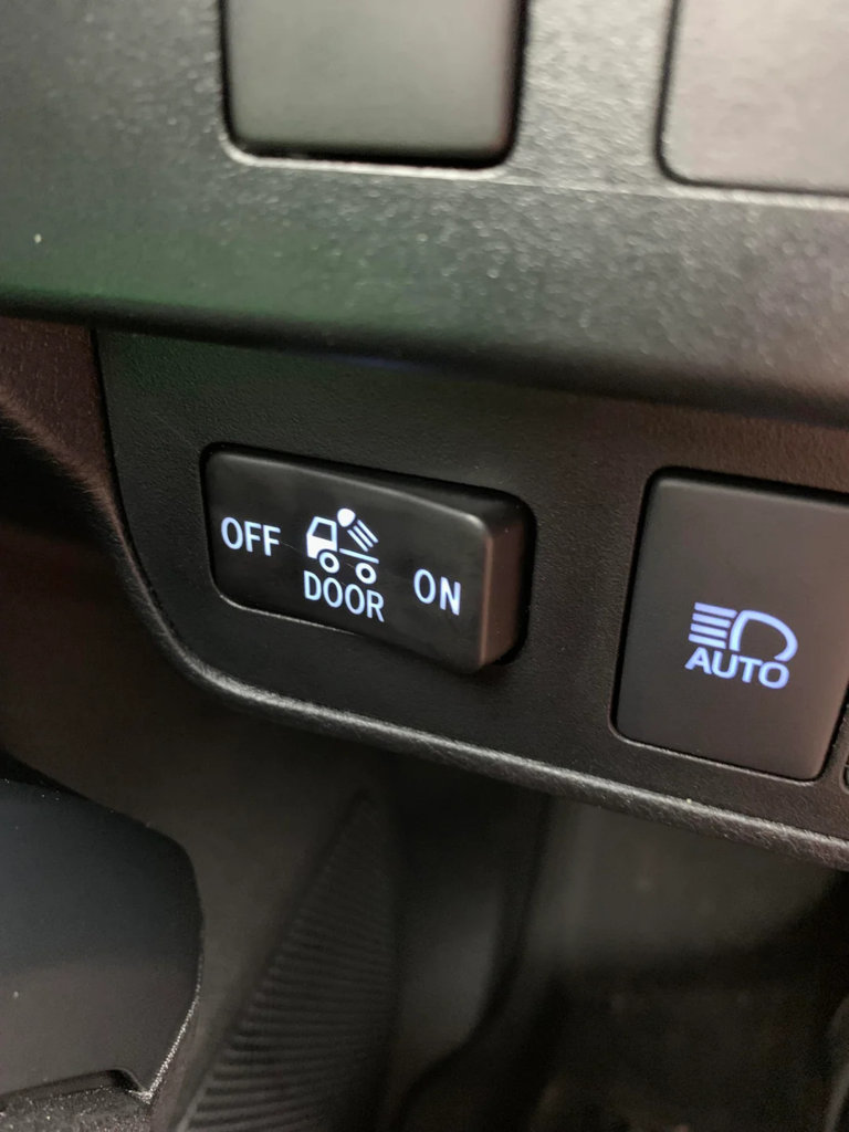

    Howdy. A few weeks back I noticed the cargo lights embedded into the 3rd brake light housing were on after I last drove it a 2 days prior which ended up draining my battery. After hooking up a brand new TrueStart everything worked flawlessly until today… I last drove my truck last night (Thursday) and tonight (Friday) I went outside and noticed my cargo light is on AGAIN. I normally have the switch set to the middle DOOR position but no matter what position the switch is in, the lights won’t turn off even after pressing the lock button on the fob over and over again. Setting the switch to OFF won’t turn them off either. I haven’t done a single electrical modification and have owned this truck since new. 2021 Sport with 13k miles. Any input is greatly appreciated, thanks!

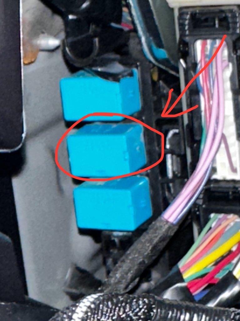

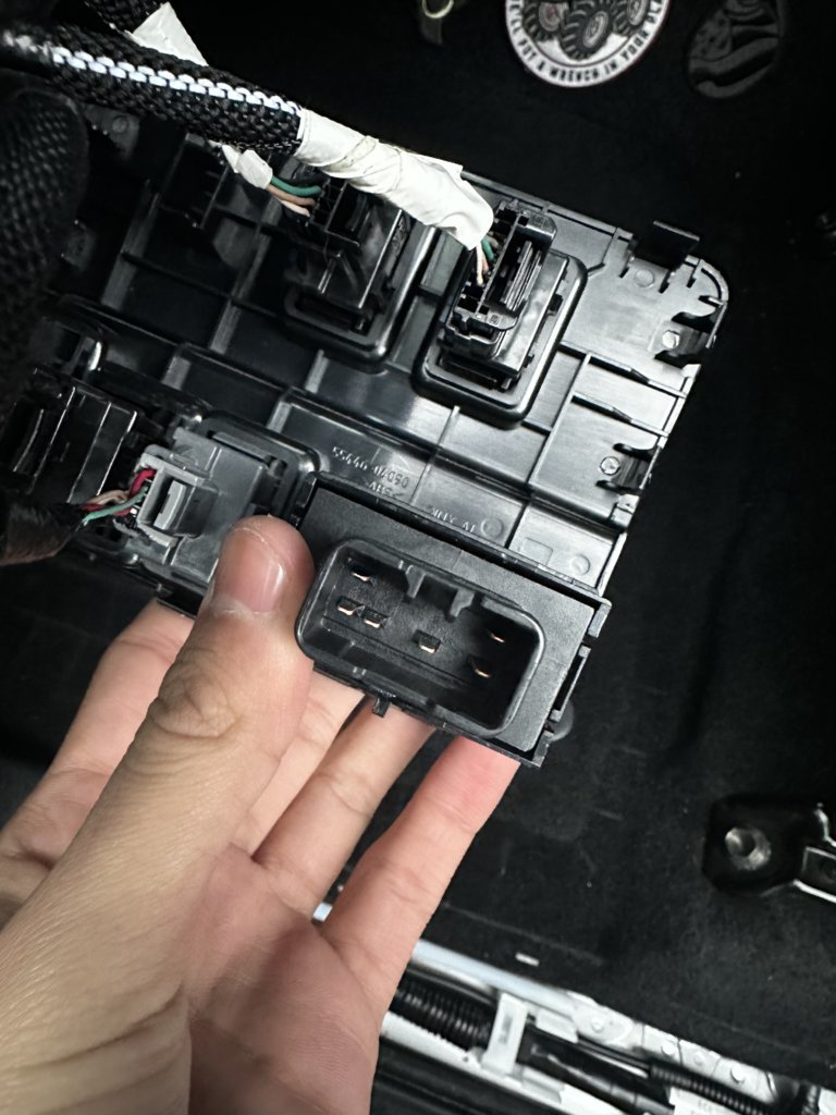

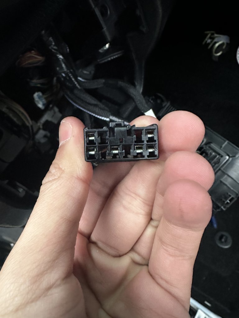

    I can’t seem to get the relay out, I did notice the lights turned off and are now working normally after disconnecting and connecting the switch. I posted they somehow turned off last night and they were on again today without touching the truck.

    Found the lights on again this morning (Sunday) so I just disconnected the switch to prevent it from occurring. Plz help master @caribe makaira

    Did you get the relay out? It sounds like a bad relay as mentioned.

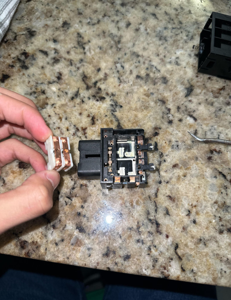

    I did dissect the switch and everything is normal inside, still works after I put it back together. Was surprised to find some KY lube in there.

    The relay should come out fairly easy...sounds like it might be the culprit unless the problem completely goes away if you remove the switch...which is equally as weird.

    Hooking and unhooking the switch fixes it temporarily, I did that Saturday afternoon and by Sunday morning the lights were on with the switch left on OFF.
