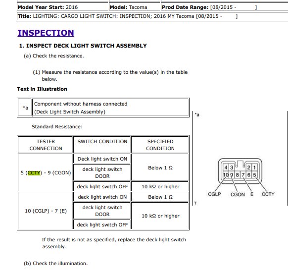

    • CL.pdf
      File size:
      193.7 KB
      Views:
      8

    got multimeter?
    the picture is the back of the switch. Apply multimeter's probs to pins to test the resistance at different positions to rule out the switch
    Switch in Off position should turn off Cargo light. If lights are on with switch in Off, something wrong with the switch or the blue wire gets grounded somewhere after the switch and energizing the relay

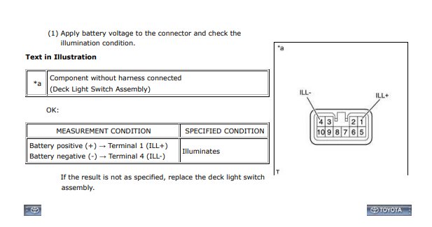

    follow this.
    • cl2.pdf
      File size:
      414.5 KB
      Views:
      7

    CGLP reads 003 with the multimeter set to the 20k ohm setting.
