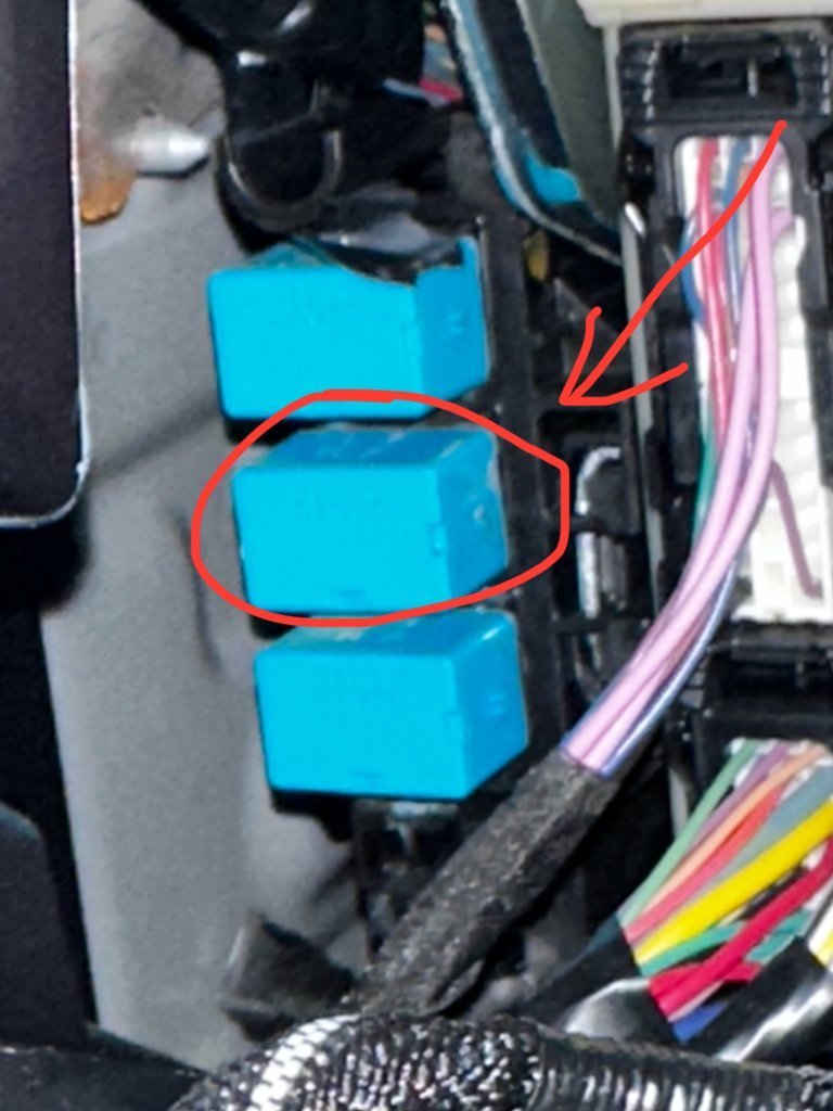

    Have you replaced the relay?

    Will do that shortly, had my battery charging.

    I can’t for the life of me remove it. Pulling on it brings the whole panel out. I installed a new switch and problem persists. For a minute the lights were on without the switch even connected.
