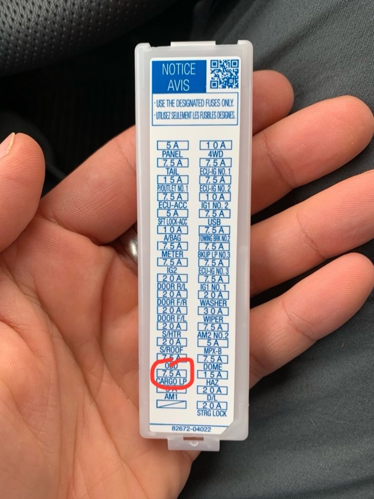

    Stupid side question, but which fuse is it for the cargo area light? TIA.
  7. Feb 28, 2025 at 7:31 AM
    #67
    ALI3N_123
    ALI3N_123 [OP] ( -_・)ᡕᠵ᠊ᡃ່࡚ࠢ࠘⸝່ࠡࠣ᠊߯᠆ࠣ࠘ᡁࠣ࠘᠊᠊ࠢ࠘
    Dec 10, 2017
    #238195
    26,897
    Eric
    Austin, Texas
    2021 Silver TuRD Squirt DCSB 4x4 // 2008 Black Rusty Shitbox DCSB PreRunner
    7.5 right above a 5 at the very bottom towards the driver and away from the brake pedal.
