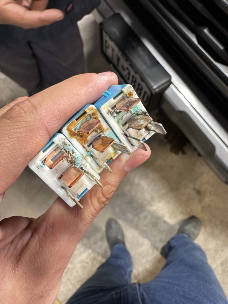

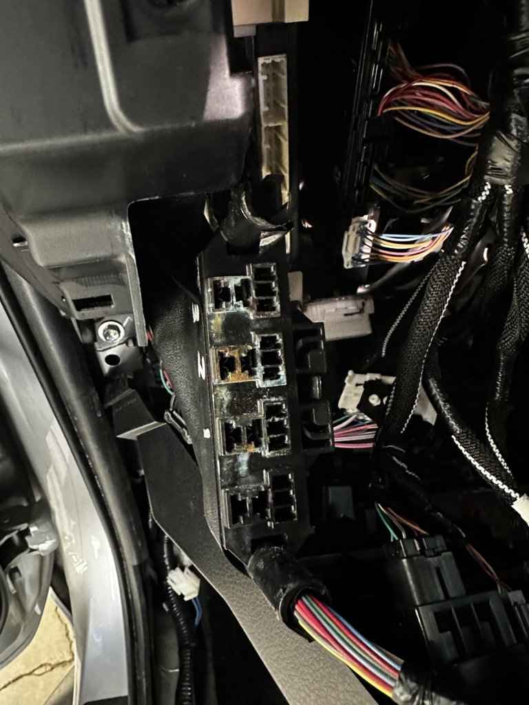

    Yikes. What a mess!!!. Is the box clean of green crusties?

    Yeah he cleaned it up.

    Still need to address a leak?

    I’m taking it to an independent shop so they can remove and reseal the windshield. The glass is OE Pilkington brand same as factory except it doesn’t have Toyota markings. No Fuyao or other China stuff.

    It’s not the brand but the installer! Believe it or not Pilkintons chip very easy. My Son got a new windshield non Pilkinton and it is legit. $265 installed from a friend who does glass install for the dealers and body shops in our area. I had one installed in my Wife’s 4Runner and no issues. Keep in mind if you don’t unplug any of the sensors you don’t need to recalibrate anything.

    Yes definitely a craftsmanship issue, I’m glad it didn’t mess up anything else too bad. I had a Fuyao windshield installed on my 2nd Gen and so far it’s holding up pretty good.
