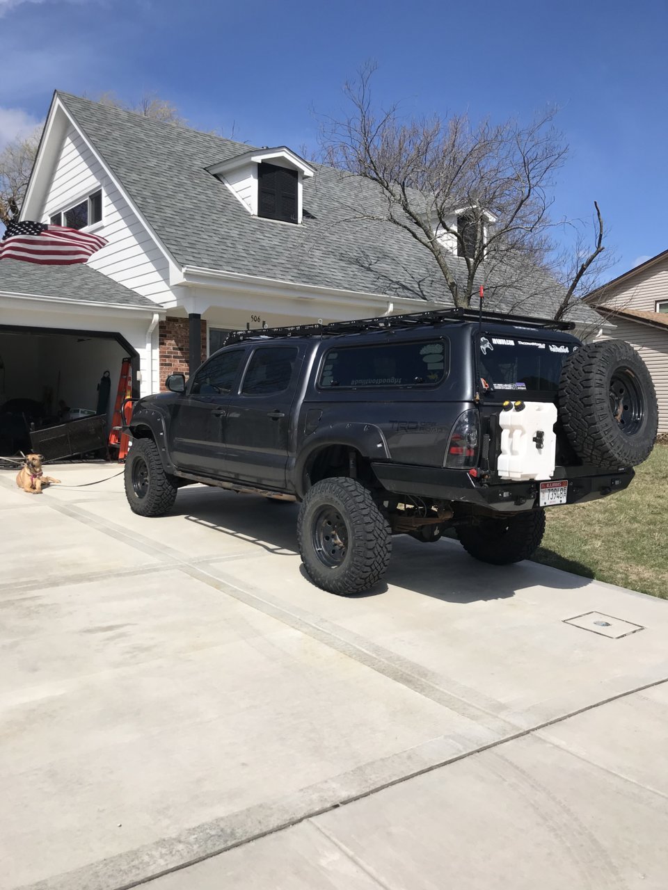

    20190531_124525.jpgI put a front runner tray on my snugtop hi-liner (with sportsmans). I'm not into RTTs, just like the versatility of the rack.
