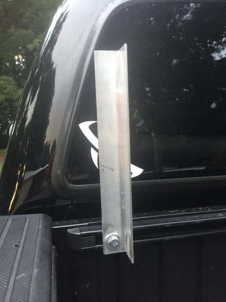

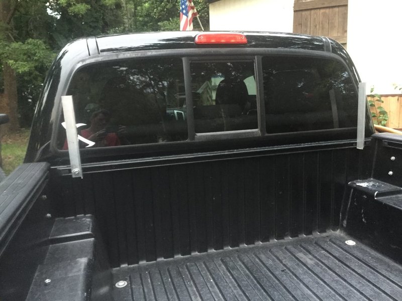

    With that being said, I didn't really want to spend too much money on different bed mounted light bars or roof racks and I kind of wanted to utilize the track system in the bed. So I went to my local Home Depot and started MacGyver-ing up a storm. I grabbed 3 foot of 1.5"x1/8" angled aluminum, black spray paint, two 3/8 speed nuts, two(I think)3" long bolts to go with them, and four 1/2" washers.
    After cutting the aluminum at 1 foot lengths I drilled holes for the bolts to go through and mounted them to the rail and this is what it looks like so far:
    I have two 18w LED flood lights and a wiring harness ordered that should be in tomorrow afternoon. If they don't get in too late I'll try to install them then. I also plan on painting the aluminum black after I drill holes to mount the lights.

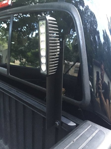

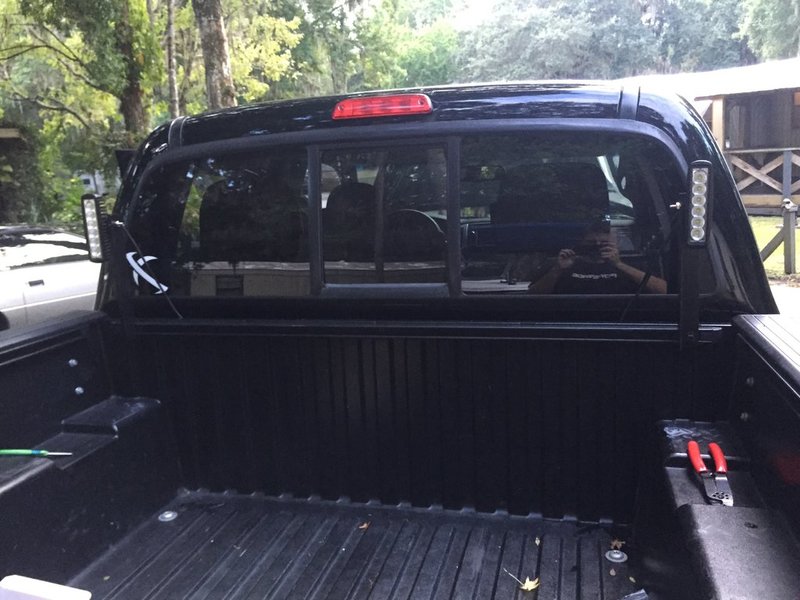

    --UPDATED--
    Got the lights put on. I like how they turned out with the Aluminum painted black. I think I need to make new brackets though and mount the lights higher.

    Should give you plenty of light, plus you if you use a rubber or plastic washer you should be able to rotate the aluminum pieces down to run parallel with the rail when not in use.

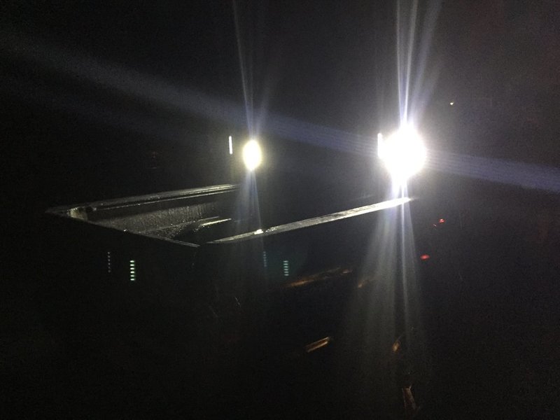

  5. Jun 24, 2015 at 7:33 PM
    Ohlertaco
    Ohlertaco [OP] Active Member
    Jun 13, 2015
    #157333
    31
    2013 Black 4x4 DCSB
    Pics are posted of the final product. Any thoughts?

    Plenty of light! Looks pretty good. Are you going to secure the wires to the bracket? Also, now you can rear flash someone riding your bumper. :)

    31
    2013 Black 4x4 DCSB
    I thought I might have to tie down the wires somehow but I checked under the truck and they don't hang down low enough to worry me at all; So they'll just be hanging around for now. And yea! I don't plan using them against people but I'm sure somebody will make me change my mind.
