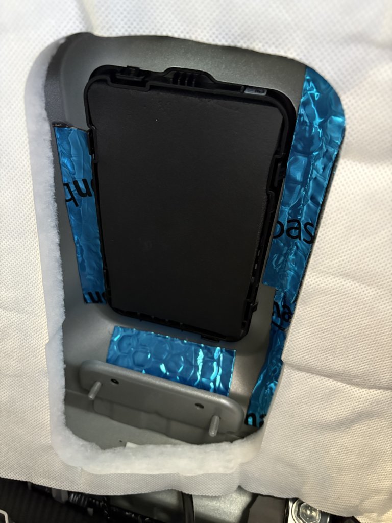

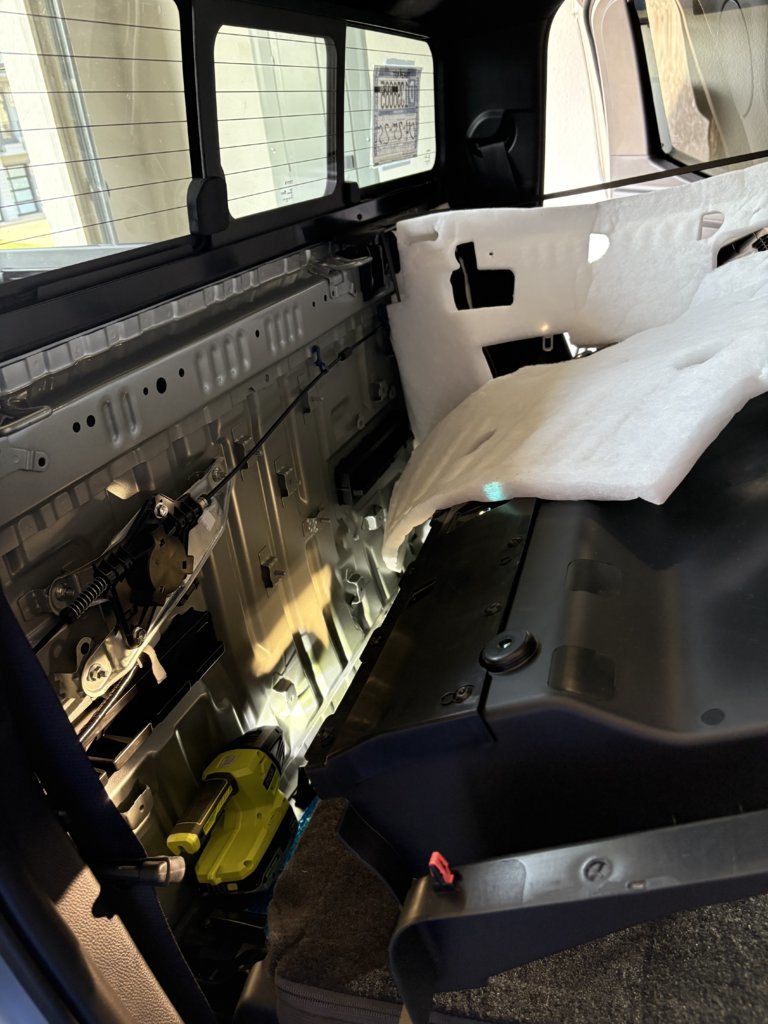

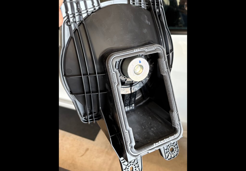

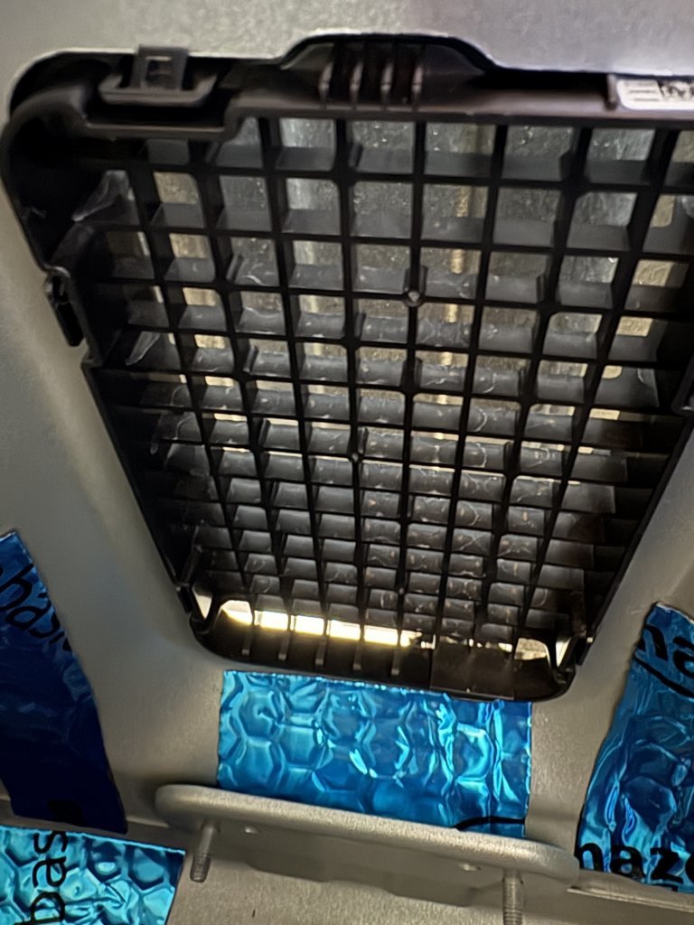

    With the JBL sound-system, there is a 3.5x 7 inch hole in the back wall of the truck. That hole or opening is covered by a plastic grate and a duct that leads to the back of the subwoofer inside the cab.
    So, the exhaust pipe and muffler will easily send noise up between the bed and back wall of the truck, into the opening at the rear wall, through the duct and in turn through the paper subwoofer into the cab, especially with the rear seat-back in the lowered position.
    The grate covering the opening will allow thousands of bugs to enter the back of the subwoofer if they so choose, and set up a home/condo in the subwoofer enclosure.
    It's an interesting design, either to let the subwoofer move freely, or to allow exhaust noise into the cab.
    I cut a piece of 1/2 inch thick exercise mat to size, plugged it and sealed it with silicone.
    The exhaust noise I noticed from the left rear of the cab is now gone.

    Did you cut a hole into the surround foam of the sub? How are you allowing the sub rear to not build air pressure now?

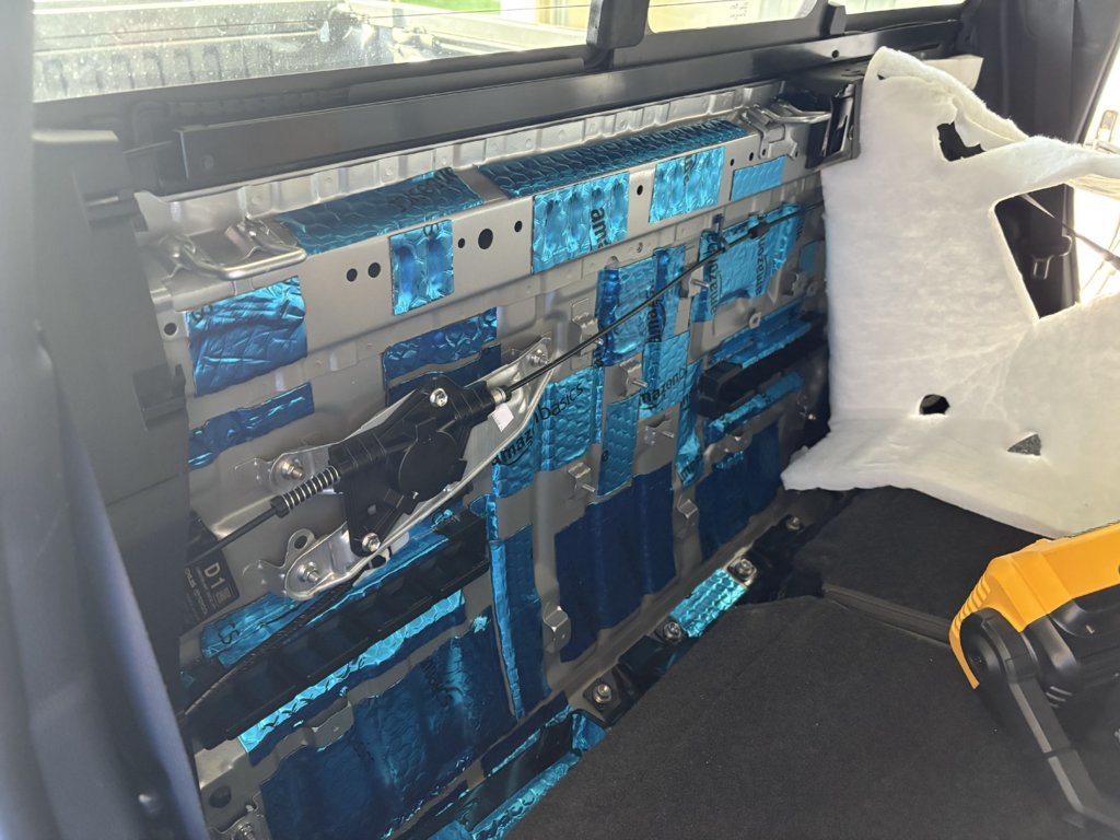

    Was it hard to pop off the back panel to access? That’s one area that I never finished sound deadening
