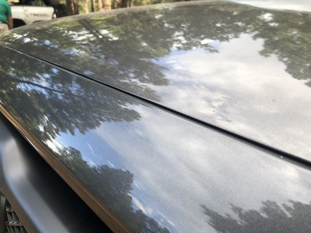

    THIS WAS WHEN I FIRST BOUGHT THE TRUCK WITH 60,000 MILES AND NOTHING DONE TO IT. NO RUST OR NOTICEABLE DAMAGE. AND MY FIRST NEW VEHICHLE WHICH WAS A BIG DIFFERENCE.
    FIRST THING I DID WAS LAY ON SOME CERAMIC WAX, SOME PEOPLE SAY THIS STUFF IS A GIMMIC BUT I THOUGHT IT WORKED VERY WELL AND BROUGHT SOME SHINE BACK. I CHOOSE THIS WAX TO TRY AND AVOID THE NOTORIOUS ARIZONA PIN STRIPING.
    SUPER SHINY!!!

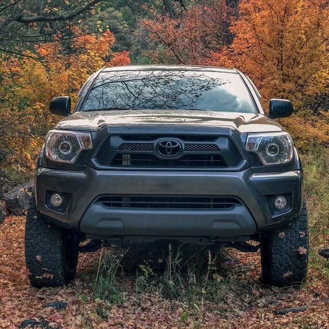

    AFTER GETTING THE MOD BUG I FELT OBLIGATED TO START DOING ALL THE BEGINNERS 2ND GEN TACOMA MODS. I STARTED WITH THE ANYTIME FOG LIGHT MOD.
    AFTER THAT I DECIDED SOME AFTER MARKET LIGHTING WAS A MUST, THANKFULLY I HAD A GOOD FRIEND WHO WAS knowledgeable ABOUT THIS STUFF AND WAS A MAJOR HELP. I ENDED UP WITH THE RETROFIT SOURCE MINI H1 KIT. LATER ON UPGRADING TO PRECISION BULB HOLDERS AND GOING THROUGH A WIRING HARNESS BECAUSE OF CORROSION IN THE LAST ONE. I ALSO ENDED UP GETTING SOME 4500K BULBS, I DO NOT CARE MUCH FOR THE NEW WHITE LOOK ON MOST VEHICLES. IT JUST REMINDS ME OF PEOPLE WHO STICK PURE WHITE LED BULBS IN STOCK HOUSINGS. COUGH COUGH NOT ME.:anonymous:

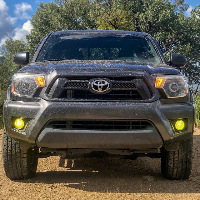

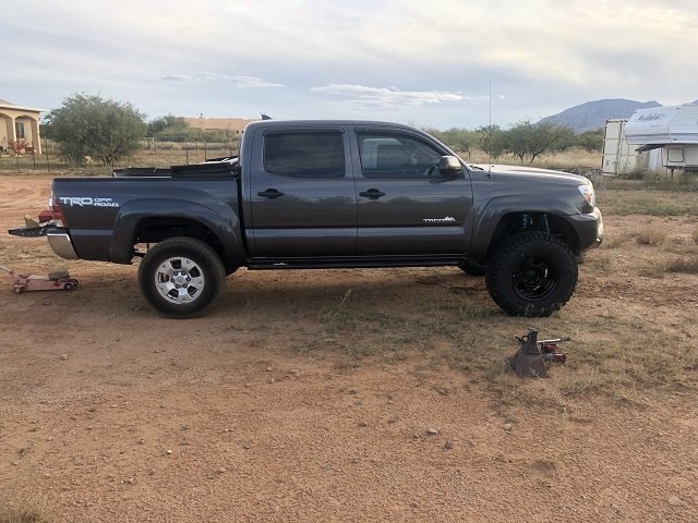

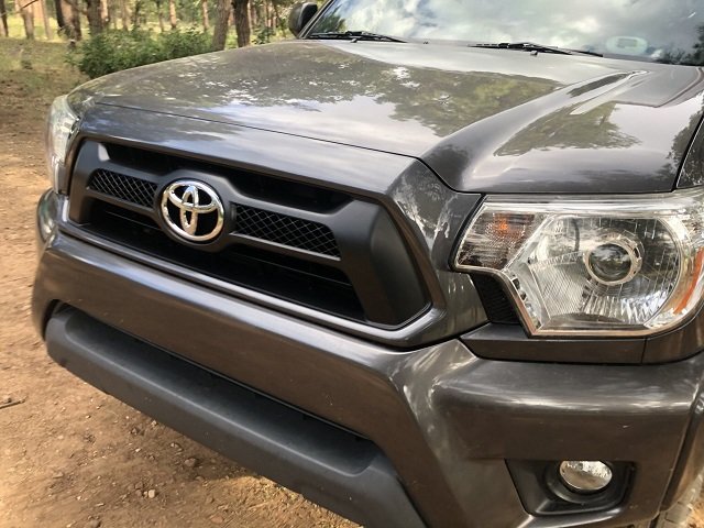

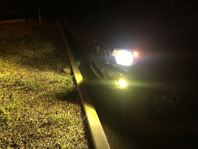

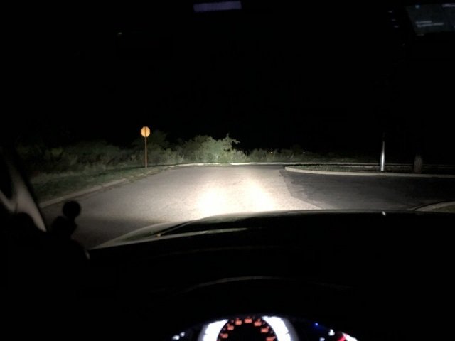

    NEXT I HAD TO THROW IN SOME HID AMBER FOG LIGHTS GIVEN TO ME BY A FRIEND. THEY WORK GREAT AND I LOVE THE COLOR.

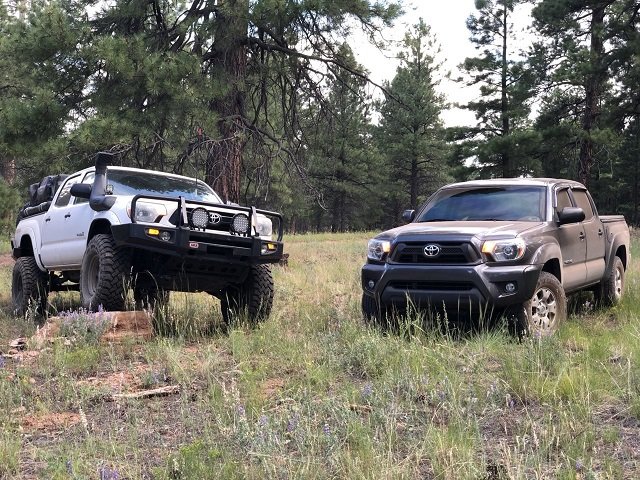

    MY FIRST TRIP OUT I HEADED UP TO THE GRAND CANYON TO MEET UP WITH MY BROTHER WHO HAD BEEN TRAVELING ACROSS THE COUNTRY FOR THE PAST COUPLE OF DAYS. I WAS REALLY GRATEFUL FOR THE GOOD GAS MILEAGE COMPARED TO MY OLD TRUCK THAT GOT ABOUT 12MPG.
    WHILE I PASSING THROUGH PHOENIX I STOPPED AND PICKED UP A COLOR MATCHED TRD SPORT GRILLE FROM CAMELBACK TOYOTA. DEFINITELY STRUGGLED IN LUNCH TIME TRAFFIC. YOU CAN SEE ITS A PERFECT MATCH AND I THOUGHT IT WOULD BE WORTH BUYING A NEW ONE OPPOSED TO PAINTING MINE AND IT JUST GETTING CHIPPED IN A COUPLE WEEKS.

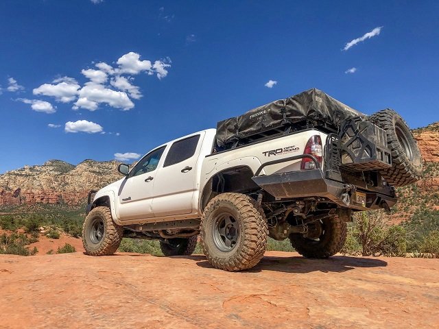

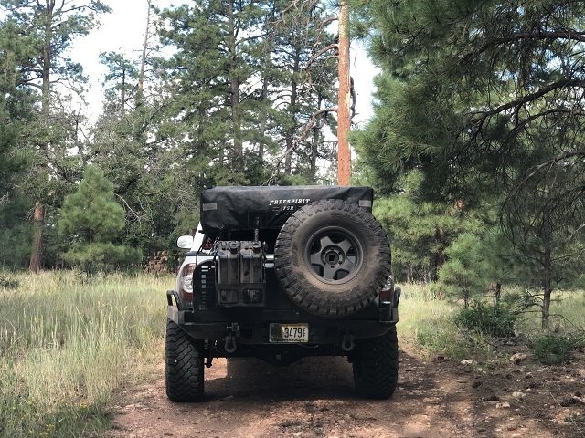

    HERE IS A HEAVY PIC DUMP OF OUR ADVENTURE FROM THE GRAND CANYON TO FLAGSTAFF AND SEDONA.

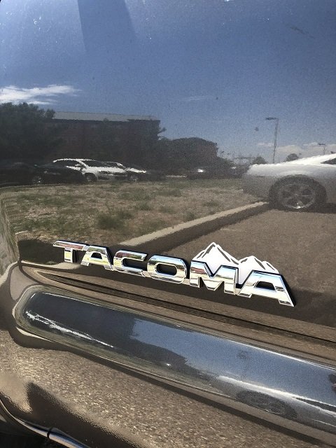

    GOT BACK AND MY DECALS CAME IN! I LIKE THEM BUT THEY ARE NOT FOR EVERYONE.

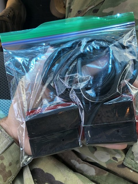

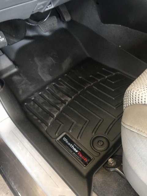

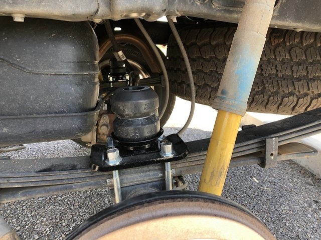

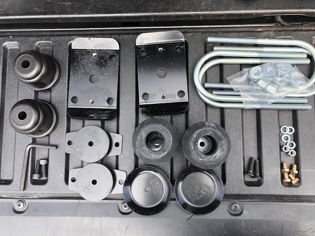

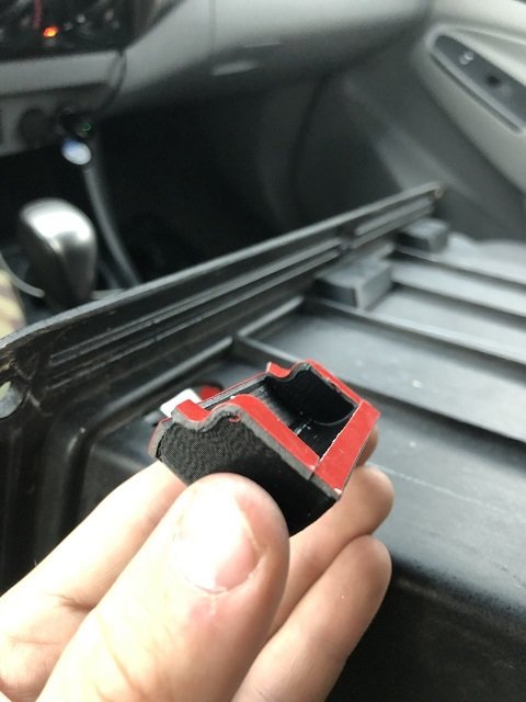

    STOPPED BY 4 WHEEL PARTS AND GOT SOME WEATHERTECH FLOOR LINERS. I PREVIOUSLY HAD HUSKY LINERS AND DIDN'T LIKE HOW THEY FOLDED UP AND GOT BENT. SO FAR THESE HAVE NOT DONE THAT AND I LIKE HOW THESE DO NOT SLIDE AROUND WHAT SO EVER.
    MY BUMP STOPS CAME IN, I ORDERED THESE BASED ON MY BROTHERS EXPERIENCE AND ANOTHER TW MEMBERS ADVICE. I LIKE THE MOUNTS AND THEY WERE NOT TOO HARD TO INSTALL. THEY WERE VERY TALL FOR A STOCK VEHICLE THOUGH AND WOULD NOT RECOMMEND FOR A STOCK TRUCK.

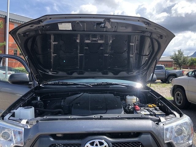

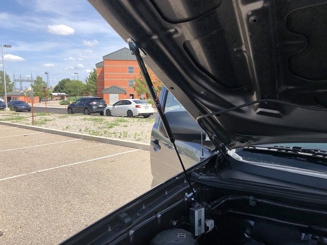

    REDLINE HOOD STRUTS INSTALLED AND THESE THINGS HAVE BEEN A BLESSING!

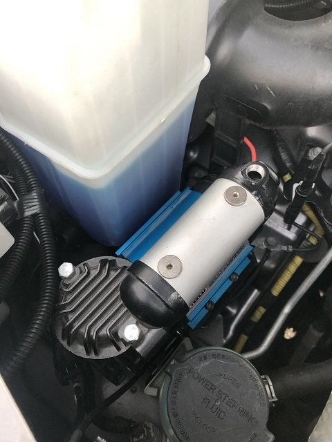

    SLEE OFFROAD AIR COMPRESSOR MOUNT FOR MY ARB SINGLE AIR COMPRESSOR. EVERYTHING LINED UP GREAT. OVER ALL A GREAT MOUNT OTHER THAN THE PRICE $$$.

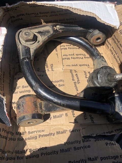

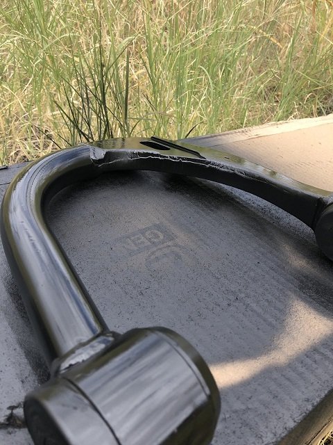

    GOT SOME SPC ARMS ON TW, THEY WERE WAY WORSE THAN PICTURED IN THE AD BUT I JUST DEALT WITH IT BECAUSE OF MY BUDGET AND DID NOT WANT TO WASTE MONEY ON NEW IF I AM GOING TO UPGRADE ANYWAYS DOWN THE ROAD.
    AFTER GRINDING ON THEM FOR A LITTLE BIT, MOST OF IT WAS SURFACE RUST AND THEY CLEANED UP PRETTY GOOD. I USED VHT ROLL BAR AND CHASSIS PAINT. THAT IS MY GO TO PAINT FOR ANYTHING I NEED TO BE DURABLE. I WILL USE STEEL-IT ON MOST OF THIS TRUCK BUT I WAS NOT WORRIED BECAUSE ILL BE GETTING RID OF THEM WHEN I GO LONG TRAVEL. ALSO WENT AHEAD AND POLISHED THE BALL JOINTS AND REPLACED THE BOOTS.

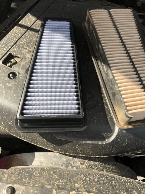

    INSTALLED SOME SOUND DEADENING IN THE DOORS AND BEHIND THE BACK PANEL, I WILL EVENTUALLY DO THE FLOOR AND LAY DOWN SOME MASS LOADED VINYL AS WELL BUT I HAD SOME OTHER FINANCIAL PRIORITIES WITH THE TRUCK.
    GOT MY AFE PRO DRY S FILTER IN AND CAN FEEL THE ENGINE IS RUNNING A LITTLE SMOOTHER, MAYBE CAUSE MY LAST ONE WAS PRETTY TRASHED. I LIKE THE PRO DRY CAUSE IT IS OIL FREE AND STILL WASHABLE. SO IT KEEPS THE THROTTLE BODY A LITTLE CLEANER.

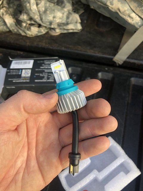

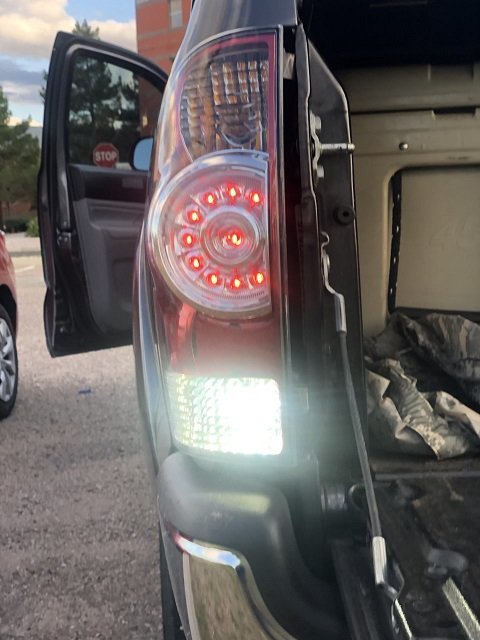

    ALSO GOT SOME AMAZON LED REVERSE LIGHTS, THESE THINGS ARE CRAZY FREAKING BRIGHT.

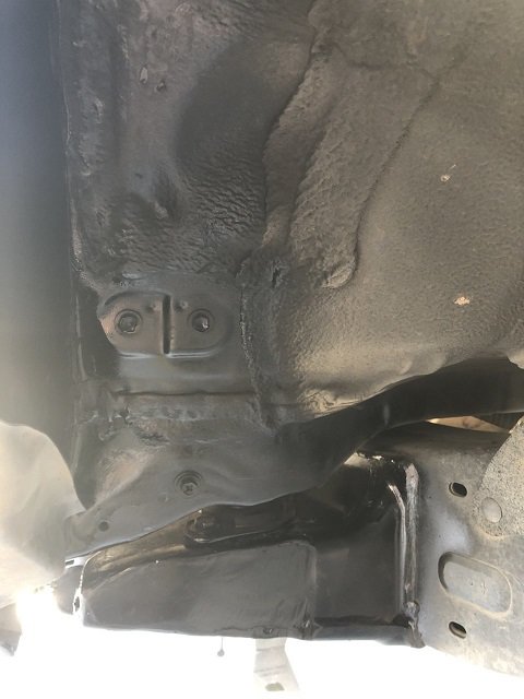

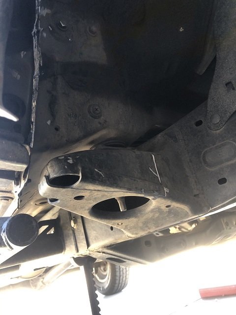

    WENT AHEAD AND DID MY CAB MOUNT CHOP AND GOT MY KIT FROM BAMF. EVENTUALLY I WILL RELOCATE CAB MOUNT AS A WHOLE BUT FOR NOW THIS WAS A GREAT WAY TO GET INTO WELDING. I KNOW THE WELDS LOOK LIKE TRASH BUT CLEANED UP I WILL NEVER SEE IT AND I WILL REPLACE ANYWAYS IN TIME.

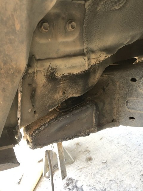

    DECIDED TO ORDER THE BAMF SHOCK RELOCATION WHILE IT WAS ON SALE AND DID BETTER ON MY WELDS BUT STILL NOT AS MUCH PENETRATION AS I WANTED. BUT IT DIDN'T MATTER BECAUSE I ENDED UP NOT EVEN GOING THIS ROUTE ANYWAYS.

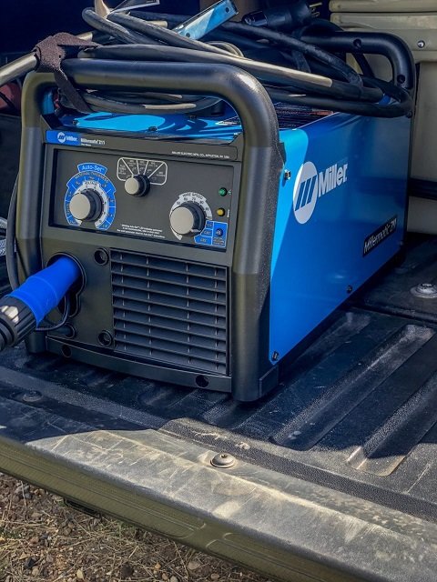

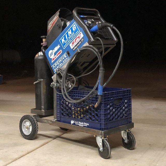

    AFTER I REALIZED I WILL BE WELDING MORE ON THIS TRUCK I WENT AND PICKED UP A MILLER 211, SO FAR THIS MACHINE IS A BEAST! I REALLY WONT NEED ANY MORE THAN THIS EXCEPT MAYBE A DEDICATED TIG MACHINE IN THE FAR FAR AWAY FUTURE.
    ALSO MADE A SMALL KART WITH SOME SCRAP AND SOME HARBOR FREIGHT CASTORS.

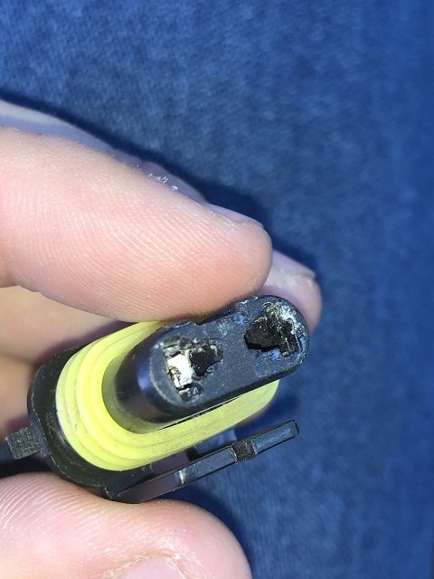

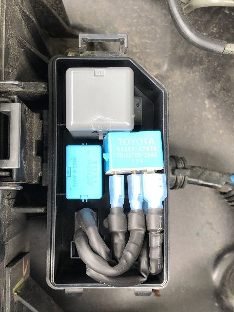

    HAD A WIRE CONNECTOR GET CORRODED FOR MY RETROFITS, RTS REPLACED THE HARNESS BUT ITS FRUSTRATING AFTER JUST PUTTING THESE IN AND ALREADY HAVING PROBLEMS. I ALSO INSTALLED SOME PRECISION BULB HOLDERS WHILE I WAS DOWN THERE SO I AM NOT CUTTING MY HANDS TAKING THE BULBS OUT. ALSO THIS TIME I USED A METRIC SHIT TON OF DIELECTRIC GREASE.

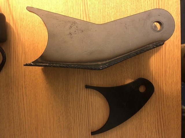

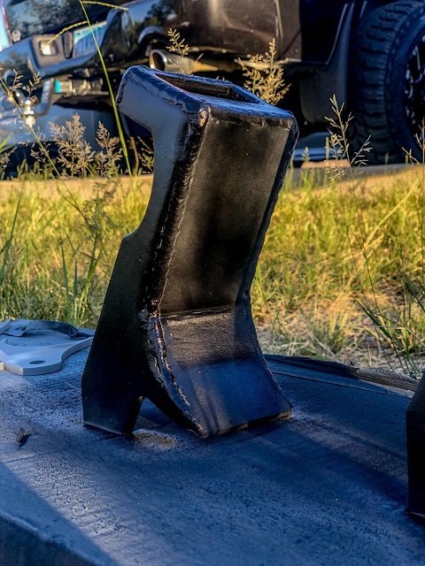

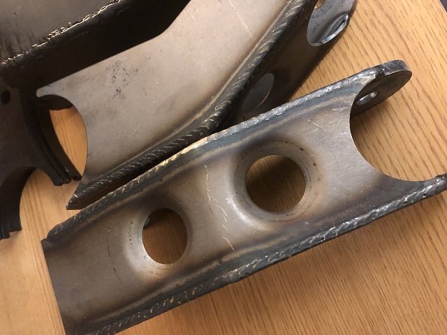

    ORDERED SOME TOTAL CHAOS MOUNTS FOR THE LOWER SHOCK MOUNT. THE GOAL WITH THESE ARE TO FIT A BIGGER SHOCK IN WHILE COMPROMISING GROUND CLEARANCE BUT THESE MOUNTS HAVE A BUILT IN SKID AND ARE 1/4" THICK, SO ID SAY THEY ARE GONNA BE PLENTY STRONG.

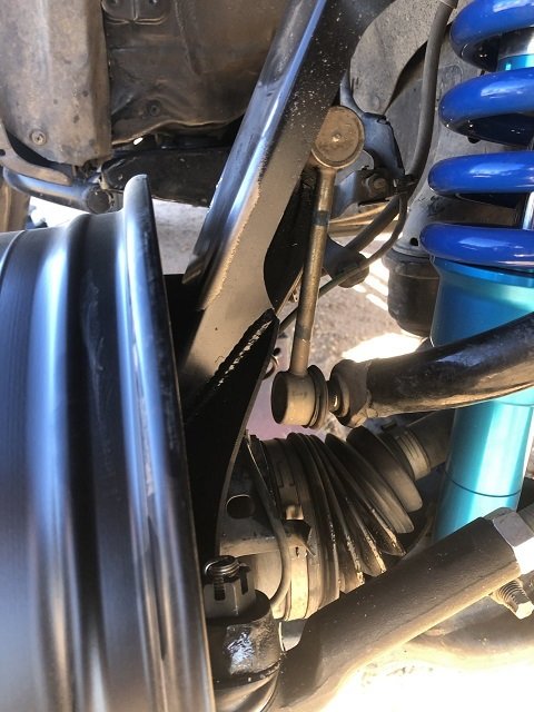

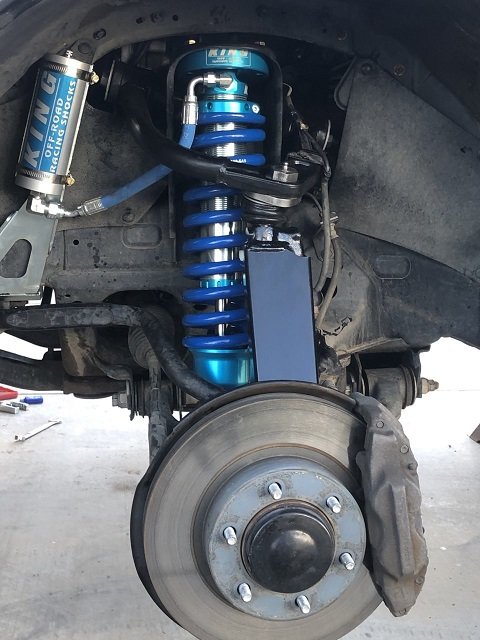

    STARTED MY SUSPENSION INSTALL WITH SOME KING 2.5 REMOTE RESI 650 LB COILS AND SOME TOTAL CHAOS GUSSETED SPINDLES FROM @glorifiedwelder . FOR THE REAR I INSTALLED SOME ALL-PRO STANDARDS WITH SOME HAND ME DOWN BILSTIEN'S FROM A FRIEND.
    INSTALL TOOK ME ABOUT 2 DAYS FOR THE FRONT BECAUSE OF PAINTING AND STUPID MISTAKES GETTING THE TIE ROD OFF. SO FAR THESE SPINDLES ARE SUPER STRONG AND I DID HAVE A PROBLEM WITH IT HITTING THE WHEEL SO I GOT SOME SCS WHEELS WITH MORE BACK SPACING.
    EXPENSIVE MISTAKES BECAUSE I ASSUME THINGS WILL JUST WORK BUT RESEARCHING IS A BETTER OPTION AND WILL END IN LESS HEADACHE. DON'T JUDGE MY MISTAKES LOL. I PUT A SMALL BEAD ON THE BAD AREAS AND USED A FLAP-DISK TO SMOOTH IT OUT, STUCK SOME PAINT ON IT AND IT LOOKED NEW AGAIN.
