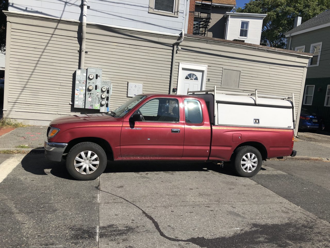

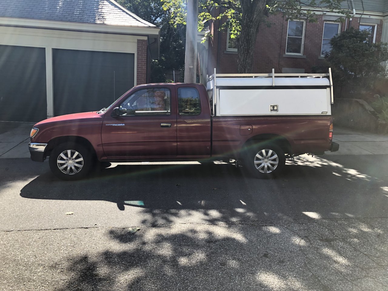

  10. Oct 13, 2019 at 4:05 AM
    Electric Nurse
    Electric Nurse [OP] Member
    Jul 30, 2019
    #300707
    10
    Jamie
    1996 Tacoma extra cab
    Much better!!
