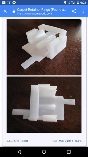

    I need this part pictured here, it's the part that snaps into the floor of truck, that the cables run down through, and also that the carpet clips snap into.
    This might be what Herculean is referring to.
    Anyone know this part number? The are white on one side (passenger I think) and black on the other.

  9. Jun 8, 2010 at 4:24 PM

  10. Jun 8, 2010 at 6:01 PM

    No, doesn't look like it, but thanks. My only concern is what if Toyota doesn't sell this part separately....
    I'll just have to run by the dealer and see I guess.

    I'm sure they will have it. Just go to the service center and show them where it came from.
    If not, your best bet would be to call a few salvage yards. I doubt that would be a high demand part and I would think that all 2005-2010 Tacomas (heck..and maybe even a 4Runner) would have the same clip.

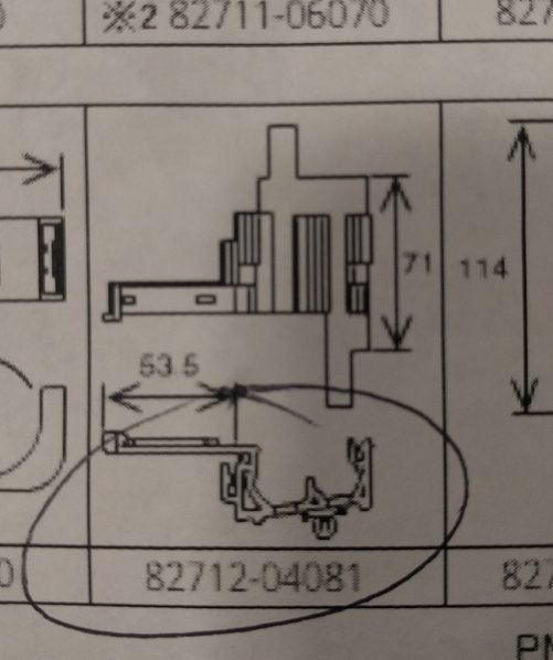

    Bumping this thread. I believe I have found a part number for the white square retaining clip that secures the carpet and sill plates in our trucks.
    My parts guy was immensely helpful. I have 4 of these on order but I believe they are what I have been after.
