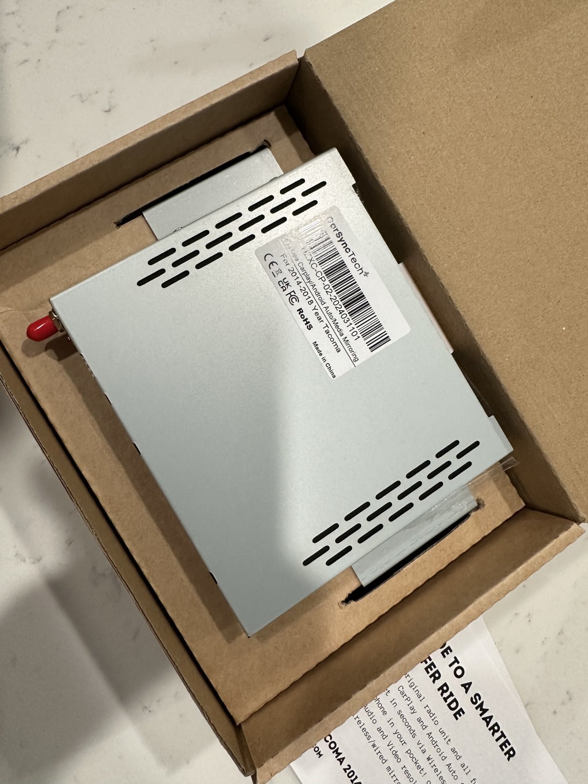

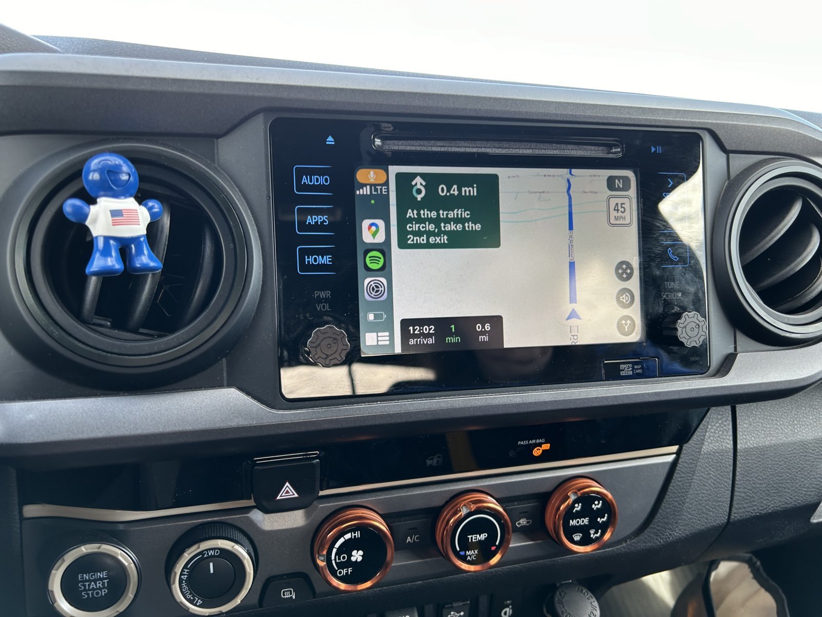

    Found the CarSynch Technology module on Amazon and decided to give it a try. The install is a bit tedious and requires some patience and attention to detail, but overall pretty straight-forward.
    Short story - it works great and I retained all factory features. Wireless connection works great too. The vendor has a good install video on YouTube and is very responsive to support questions.

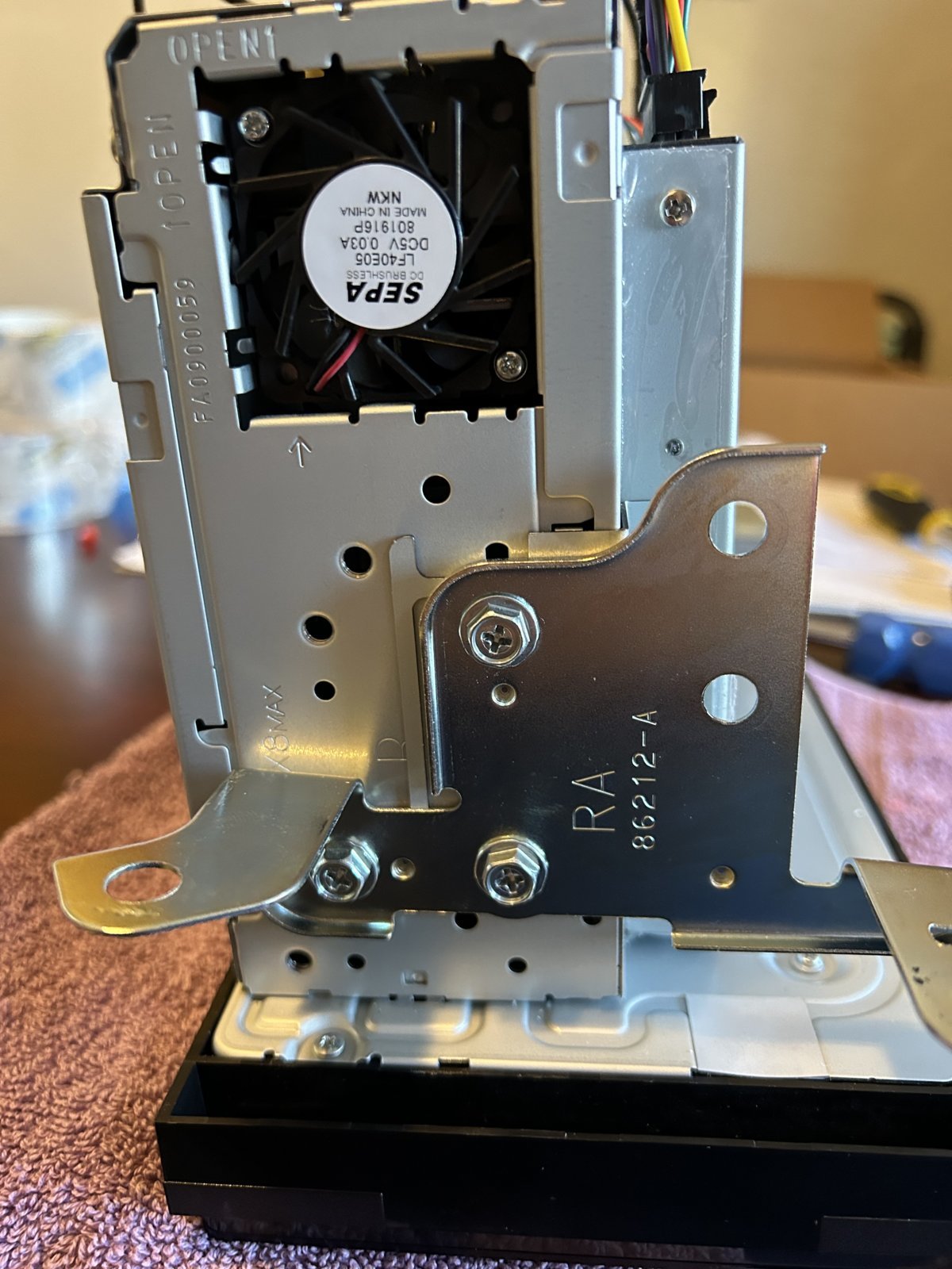

    1. I have factory nav with XM. I removed the XM module as I’ll never use it, but if you want to retain it you can. Based on my mounting ears, I would have had to mount the CarPlay module under the head unit, then put the XM module under that. Doing so shortens the available length of the large ribbon cable that connects the CarPlay module to the screen which would make reconnecting it challenging.

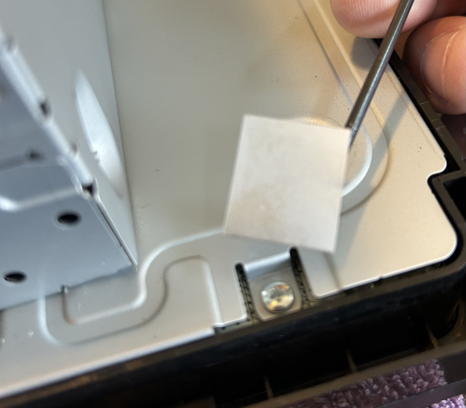

    2. When removing the screen, 2 of the 5 screws are hiding under silver stickers (or were on mine anyway)

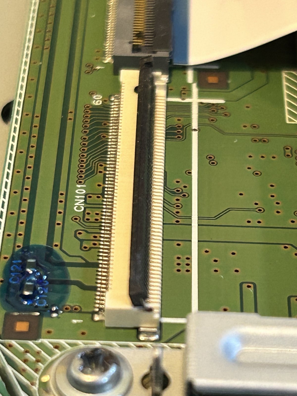

    3. Take your time disconnecting the ribbon cables and DO NOT use anything metal or you could damage the cable. The black tab holding the cable down can be gently prayed up with a fingernail or a very thin plastic automotive pry tool.
    4. After feeding the ribbon cables through the metal faceplate hole, be sure the tabs at the top edge of the faceplate are fit into the holes at the top of the head unit. Be aware that the larger of the two ribbon cables will have a portion that is under the faceplate so just bring as much slack through the hole as possible.

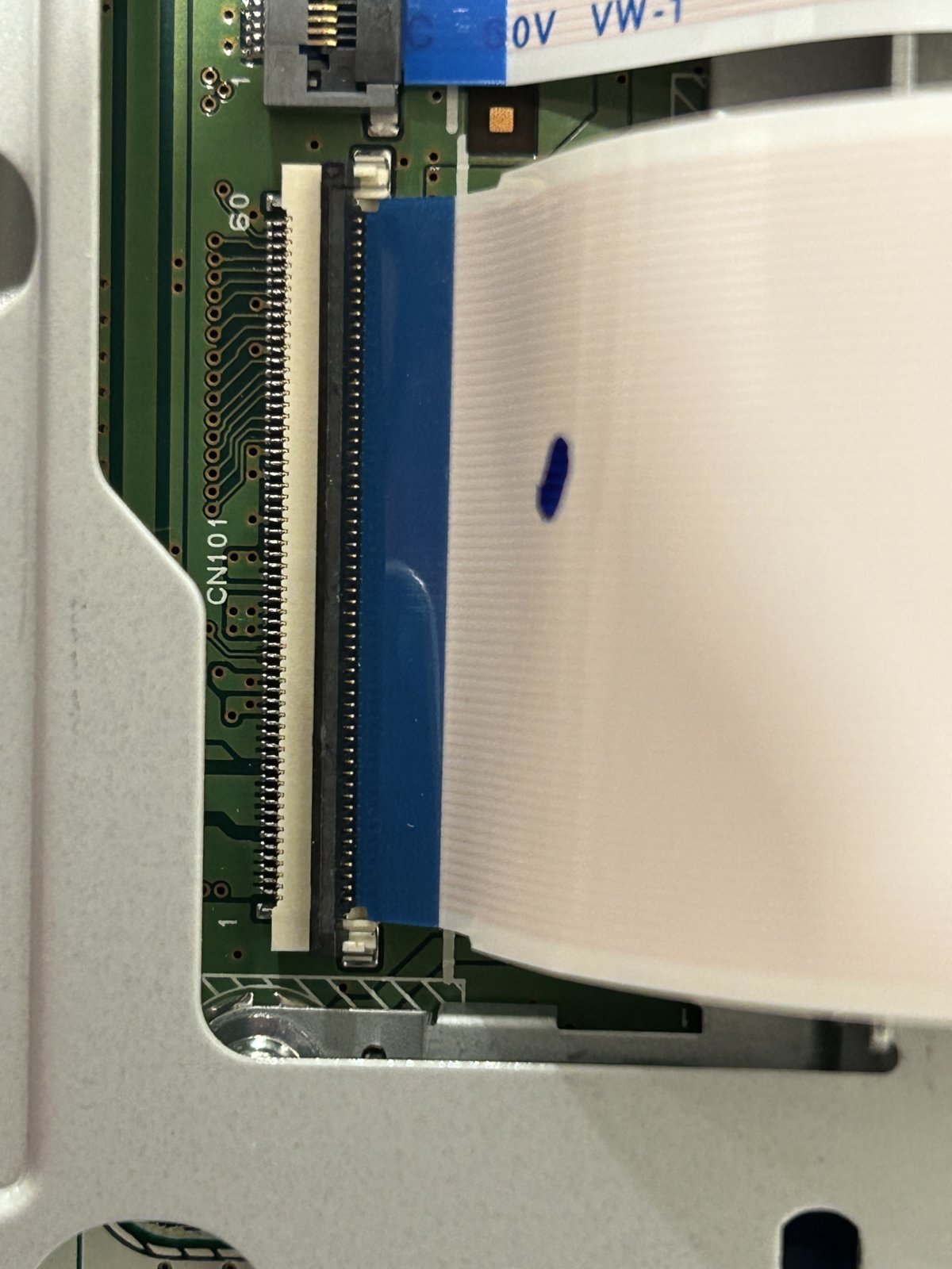

    5. When reconnecting the ribbon cables, take your time and be sure they are fully seated noting the alignment notches are around the white plastic tabs:
    The smaller of the two ribbon cables is key to the screen functionality so it’s important that it is seated properly.
    6. After reassembly (without the XM module) the mounting ears will look like this:

    It's a wireless connection. Just requires your phone is connected to your truck as you normally would. After setting up first time connection it connects automatically thereafter and opens CarPlay. I'd say it takes about 5 seconds to start up....no issues operating the truck normally before it starts up.
    Only issues thus far is when trying to connect to my Garmin mini 2 wifi the connection with the CarPlay module gets in the way. Not a big deal as I only connect to it when needing to re-aim the camera via live view. I have also noticed when 'playing' text messages the volume is very low. I suspect this may be an issue with my phone notification settings but have yet to dive into it.
    ivanjo3l likes this.
  13. Apr 2, 2024 at 9:09 AM
    TXsandyTaco
    TXsandyTaco [OP] Well-Known Member
    Jul 15, 2021
    #371367
    127
    Meridian, ID
    2018 Quicksand TRD Sport
    Not sure I'm following exactly what you mean by "....regular radio (AM/FM) while using the CarPlay...for maps" but if you're referring to turn-by-turn directions announced over your speakers this works seamlessly and via the same audio source your HU is set on (Bluetooth) for the CarPlay module to display/function.
    Switching back to the trucks native audio functions is achieved by pressing and holding the "Home" button on the HU for a couple of seconds. Quick back and forth and not clunky.
