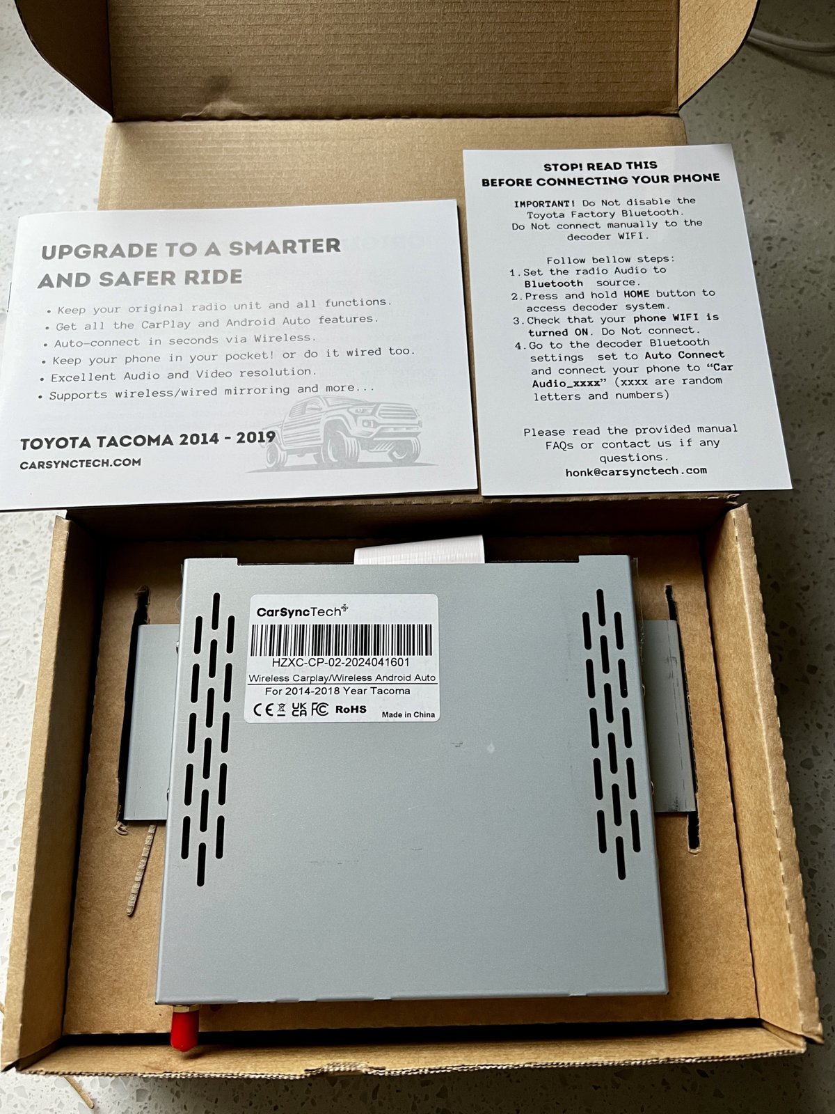

    In the first post, I think the OP mentioned that it goes underneath the CarPlay module. Also, a quick email to honk@carsynctech.com should result in a quick reply.

    I left the XM module where it was and installed the CarSync module on the bottom. I did modify my front metal plate to keep the ribbon cable from getting pinched. However, I felt that even if I had the XM module on the bottom the ribbon cable was subjected to getting damaged by the front plate. So installing on the bottom under the XM module seemed like the best fit. The ribbon cable just barely fits length wise but everything came together just fine.

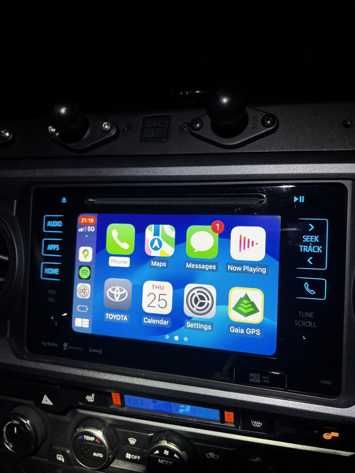

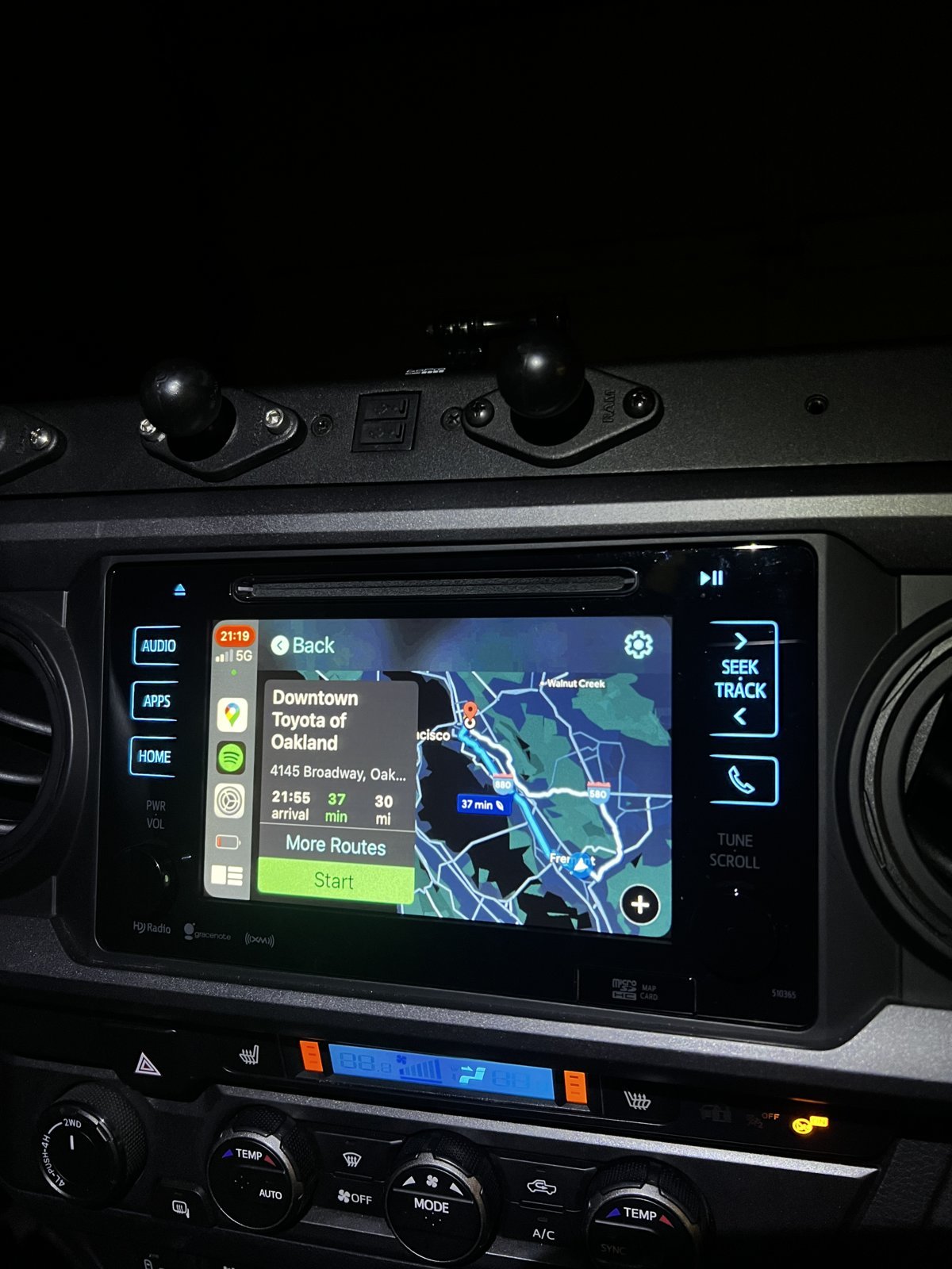

    Install went pretty straight forward (hardest part was probably removing the head unit from the truck due to my Expedition Essentials mount). Instructions are very easy to follow; there’s even a QR code for a YouTube tutorial if needed. I did remove the XM radio module since I’ve never used it.
    As mentioned before, CarPlay takes a few seconds to boot up. Otherwise, it has been running great with no hiccups. The screen quality far exceeded my expectations.

  15. Apr 26, 2024 at 7:24 AM

    My buddy has a 2019 SR5. Post a pic of your head unit. From my understanding (my buddy has the Entune plus head unit and confirmed with the vendor), this unit works on all Headunits from 2014-2019.
