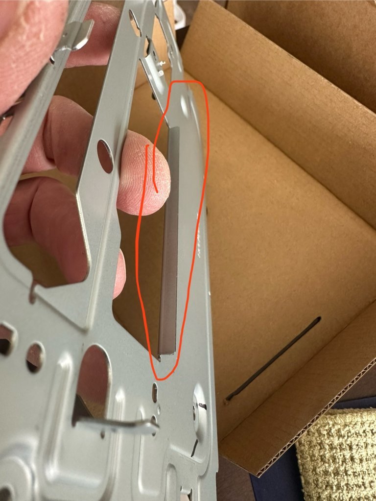

  13. Dec 15, 2024 at 12:13 PM
    #113
    Desertdogs
    Desertdogs Active Member
    Sep 23, 2015
    #164988
    29
    Curt
    Northern Nevada
    2017 TRD OffRoad DBCB
    Does this tab need to be removed? I noted some did.
  14. Dec 15, 2024 at 12:34 PM
    #114
    poopshute
    poopshute Well-Known Member
    Jul 7, 2009
    #19385
    814
    Colorado
    2017 Tacoma TRD Pro Storm Trooper
    I didn’t remove anything with my 2017 non-Jbl Entune system (came in my TRD Pro)
  15. Dec 15, 2024 at 2:31 PM
    #115
    Desertdogs
    Sep 23, 2015
    #164988
    29
    Curt
    Northern Nevada
    Got ahold of CST support. No need to remove lip. Was a bear to hook up one ribbon, cause on the Toyota side, the locking bar for the small ribbon came off. A few patient minutes and it finally clicked back in.
    Left the XM module out. I never use it.
    Buttoned it all up and tested - Everything works great!!
    Thank you CarSyncTech and Tacomaworld.
