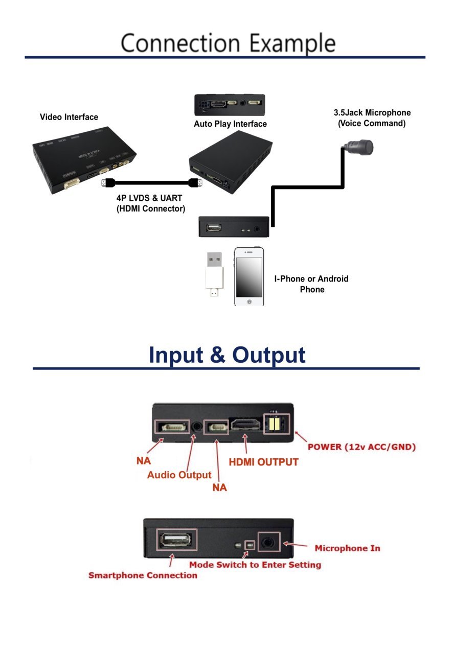

    It shows Android and iPhones in the instructions so I assume it does both. This is a page from the instructions. I have not tried an Andriod personally.

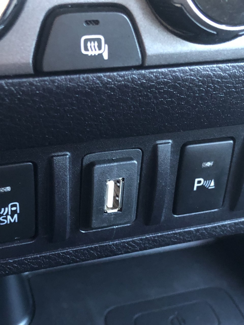

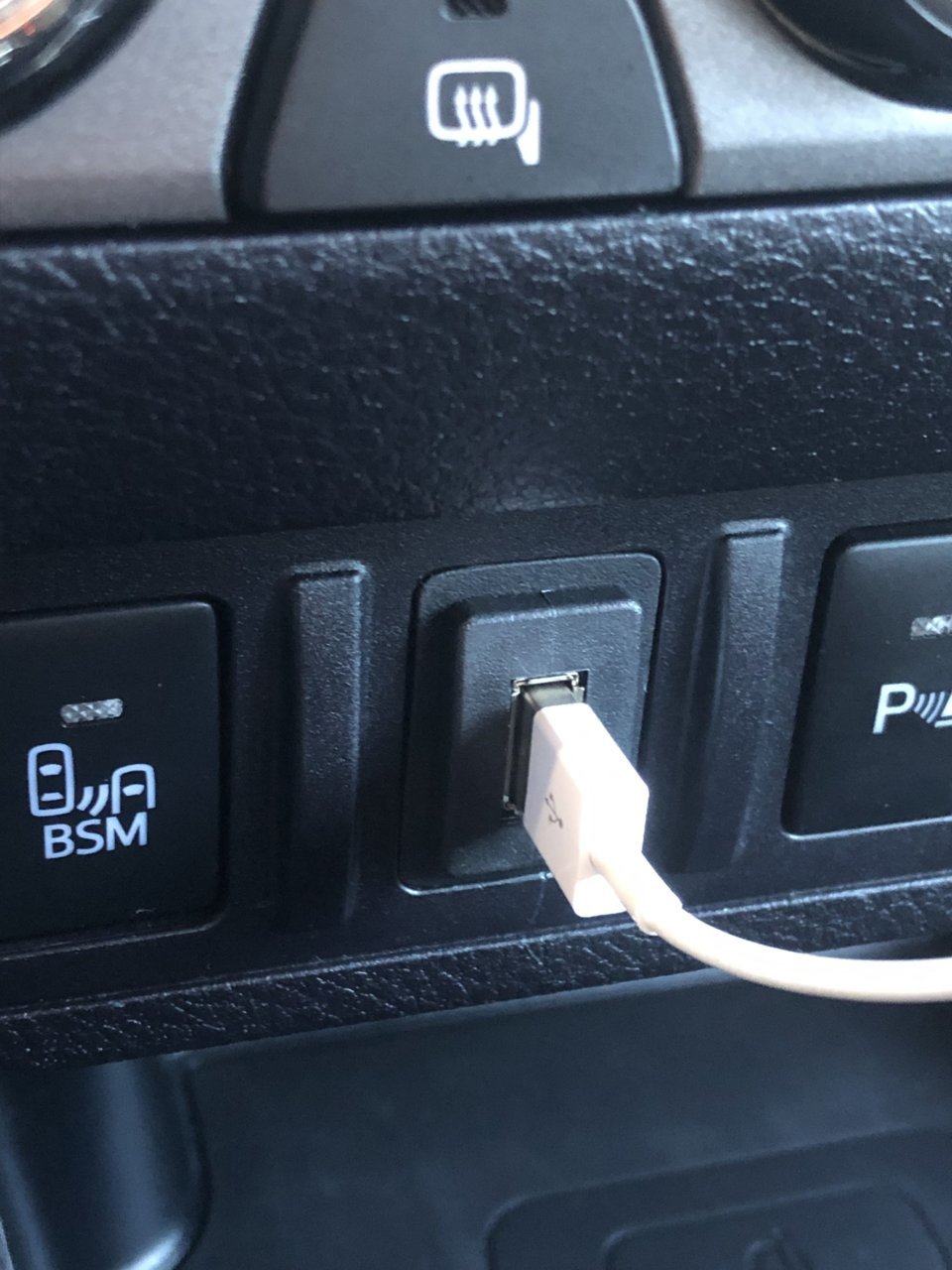

    Doesn't the OEM USB connector work instead of having to add another one in order to use this CarPlay system?

    Not to use apps like WAZE, google maps, etc. For that you need something other than the oem usb connector.

    As a side note. I really wanted my OEM USB port to act as the Carplay USB port. So I unplugged the USB connector from my factory radio and used one of these to adapt it to the CarPlay module (https://www.amazon.com/gp/product/B00QF01H2E/). It seems to be working well. It loses the OEM usb capability but I prefer that it works for Carplay.
