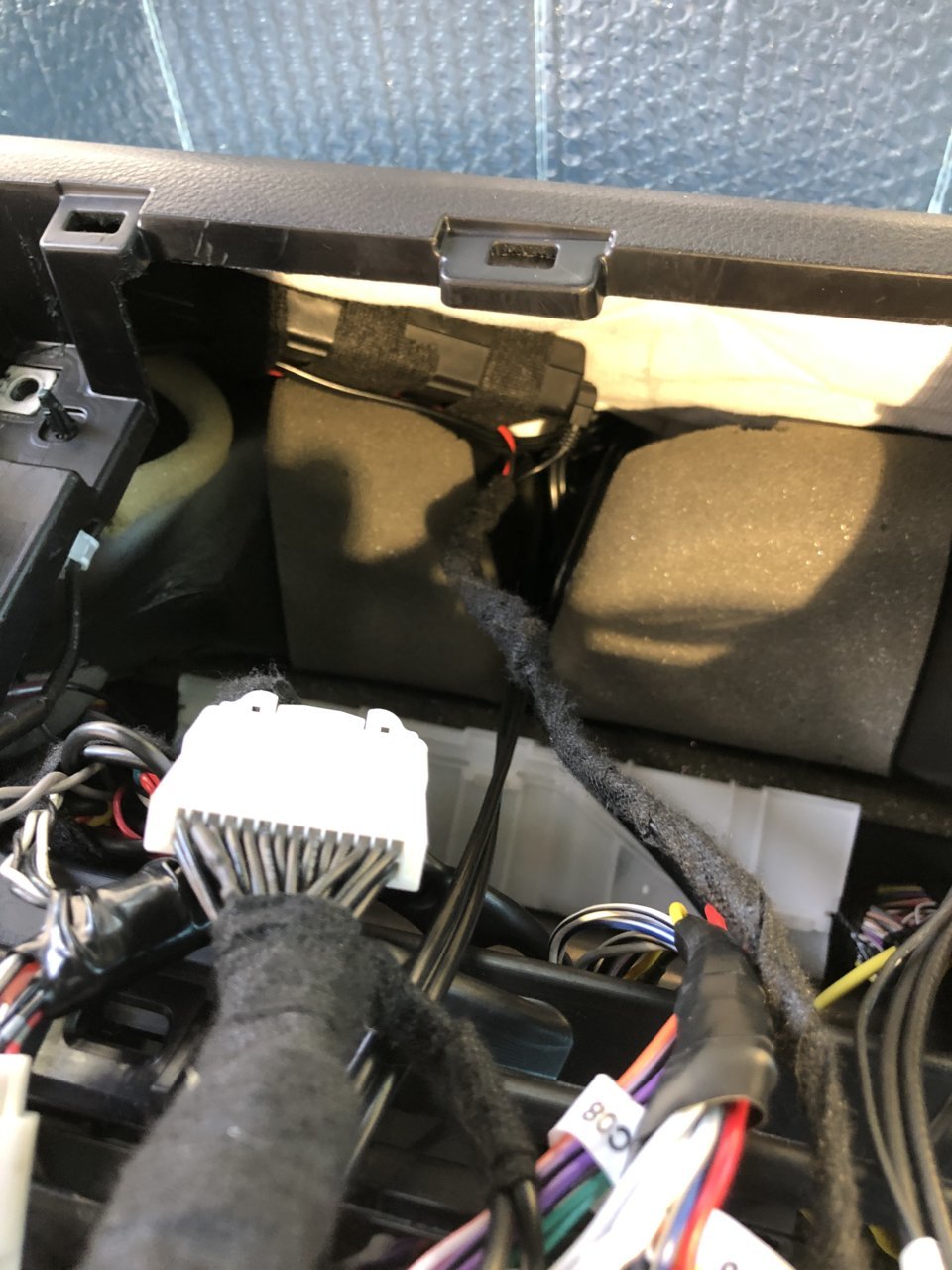

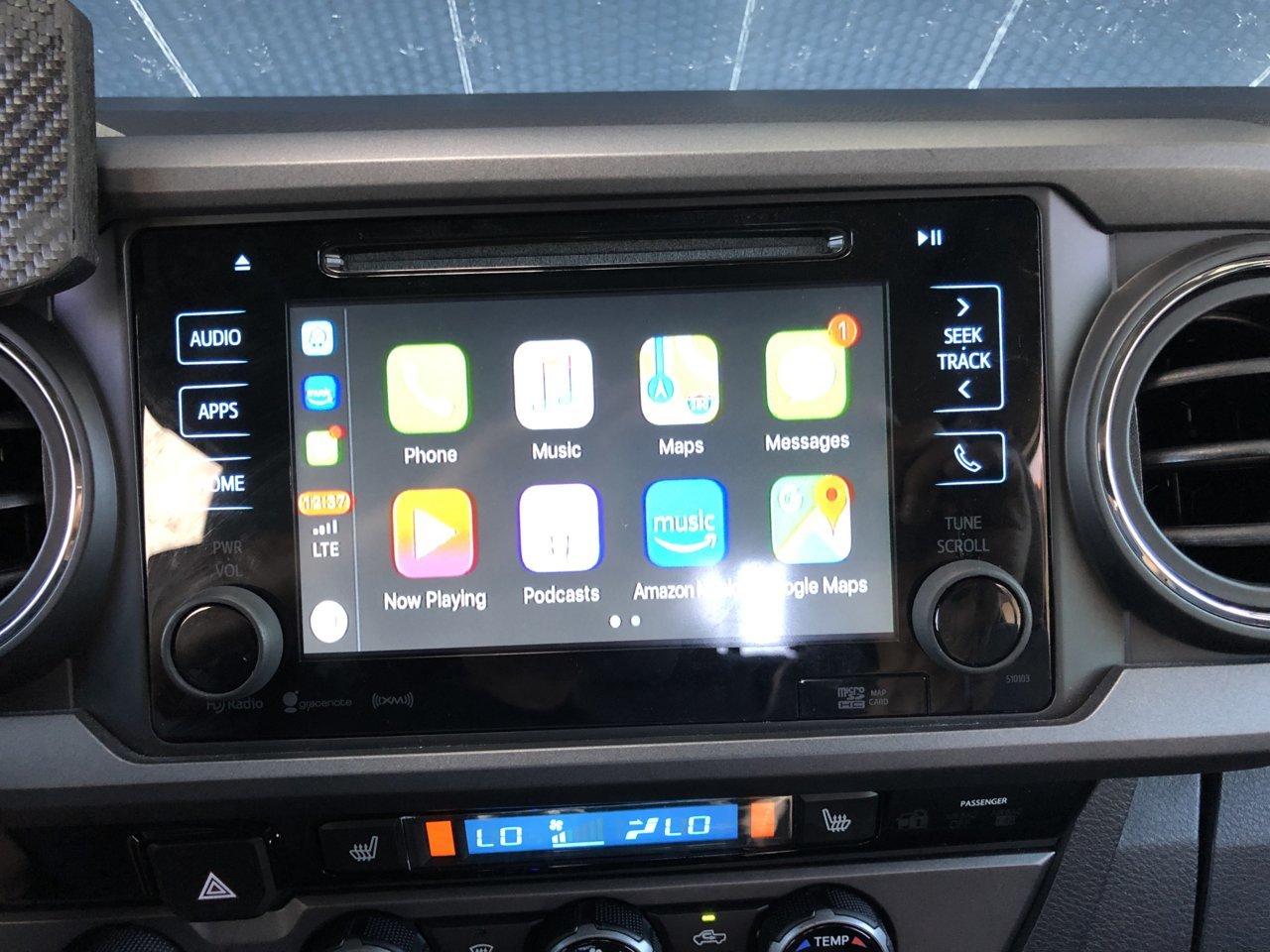

    zerospeed
    zerospeed Well-Known Member
    Jan 18, 2016
    #175290
    272
    After seeing the OG post, I became curious. Thank you @tonylop33
    Jumped on the Beat-Sonic CarPlay system as I had their iPhone mirroring system and it worked very well.
    Installation was plug and play and there is room for the to tuck the 2 control boxes out of the way.
    The cables are insulated very well.
    Here are a few pics. So far the system operates as intended...I mainly use it for messaging and Waze
    USB to iPhone is via the factory USB and uses the factory Mic.
    Note* I wrapped the harness with tesa tape and have a lead for my front and rear backup camera.
