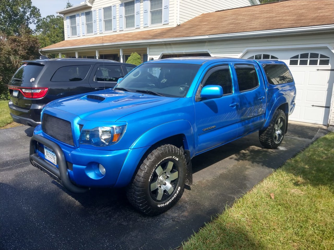

    To beat the heat (it was still 81 degrees at that time) of the "heatwave" the East Coast is going thru right now, I started at 5:45 am this morning. Washed & clay bared the entire truck including the glass , and then sprayed on the Carpro Hydro2 coating.
    This is pretty amazing stuff, and the spray on, spray off application couldn't be any easier. No issues to report. Worked just like it was suppossed to, and the water beads were jumping off of the paint....
    So far I'm VERY pleased with the results. This is not my daily driver any longer, so it will be interesting to see how it holds up without having the abuse from road grime67406686_2435952339849676_6117852060391047168_o.jpg . I also bought Beadmaker based on a lot of recommendations form other users of Hydro2, but have not put that on yet.

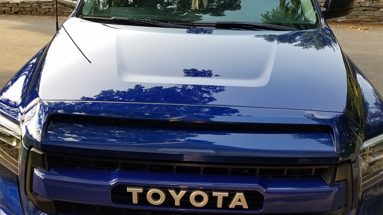

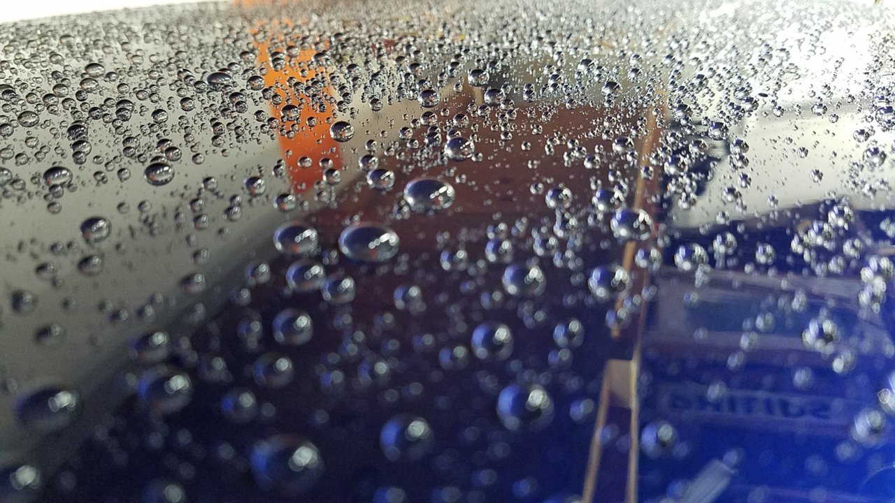

    Beads up really well. I love carpro stuff. This is hydro2 that is about a months old. I recently wiped the truck down with ech2o, which also has some sio2 in it so it's very shiny and protected. Ech2o doesnt get talked about enough, it's an awesome product.
