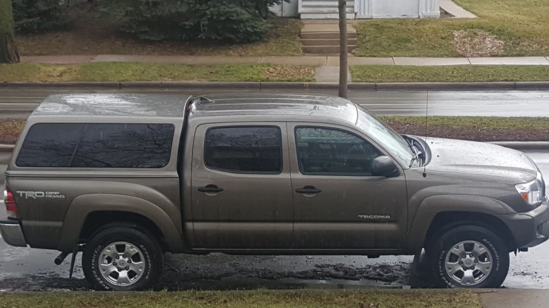

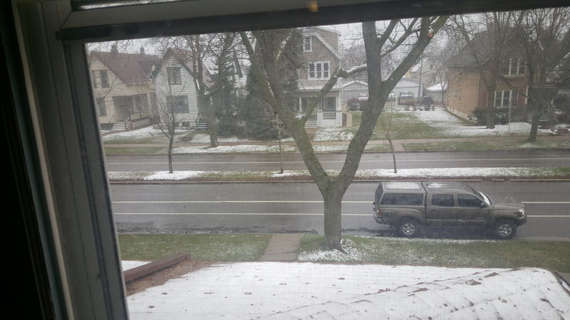

    Here she is.

    I Looked at LEER, Snugtop, and ARE caps but chose to buy local and got the Lakeland Renegade. So far, I have no complaints. Leak free and the key fob remote lock is awesome!

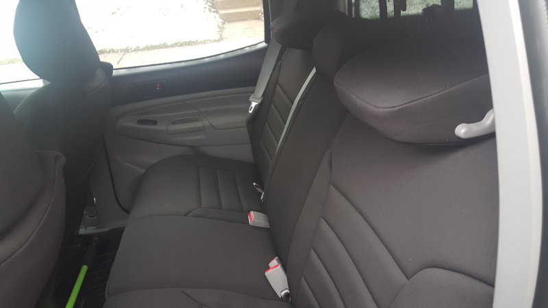

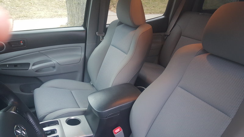

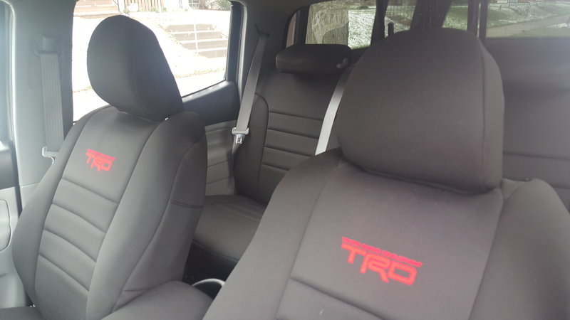

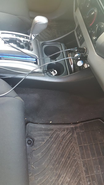

    Thanks to the recent 2016 Wet Okole Group buy, I now have heated seats.
    Before (like you all haven't seen Tacoma seats before)
    After
    I almost didn't finish my online Calc 2 class because I was trying to decide all black vs taupe middle with black on the outsides. The all black look good, but do a great job attracting dog hair.
    You wouldn't think I need heated seats in April... but you know.. Wisconsin

    Looks great!
    I keep a lint roller in my truck for that exact reason: freaking dog hair.

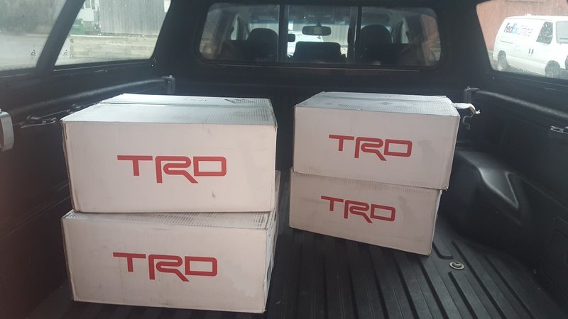

    I know pretty much errr body got em but I really like how the SEMA PRO wheels looked when I saw them at the Mil Auto Show. Gonna wait till the lift is on. trying to decide between 275 70r17 or 265 70r17. Leaning towards the 265's since I don't want to chance anything rubbing on the fancy new Camburgs.
    Edit: Ended up with 275's

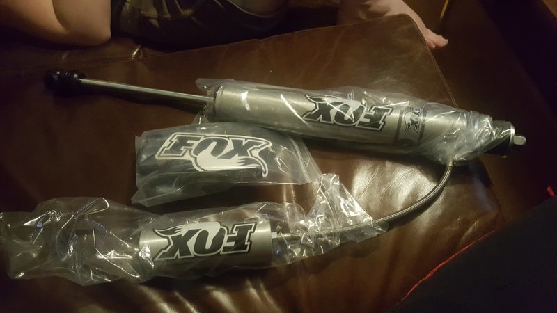

    The anticipation is palpable
    Thanks so much to Marie at Headstrong! She made sure I was ordering exactly what I needed and the shipping was super quick. Excellent comms.

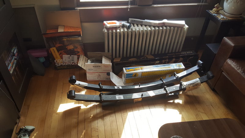

    Progress

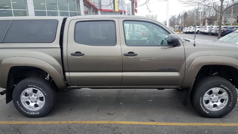

    I ended up taking the truck to the dealership to have the parts installed. The upside is that I only had to lift my credit card, the downside (besides cost) is that I couldn't be there when the lift was going in. I told them (based only on reading TW posts) that I wanted the billy's set at 0 and maybe remove the top overload on the Dakars. They ended up not removing the overload and they set the Billy's at .85. :facepalm:But hey, they do this for a living. I'm just a guy that spends too much time online staring at trucks. :taco:
    Center hub to fender well is 24" on driver side both front and rear (with 1/4" top plate spacer to correct taco lean). On the passenger side, I get 24" rear and ~25" front. I will remeasure later. Hoping everything settles kinda even. If not, it will bother me until I buy Fox adjustable shocks to match the rear.
    My CV boot angles look kinda shitty. Will definitely slide em over a bit. I bought some smooth band clamps, hope they work:
