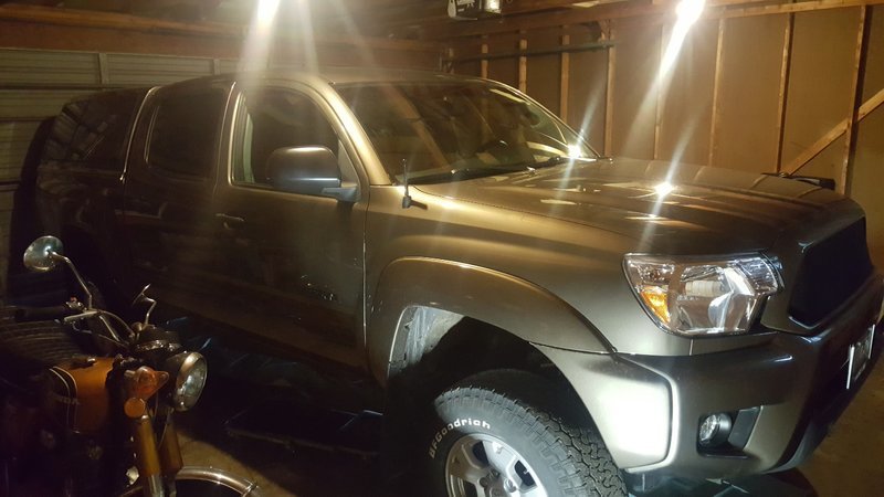

    Tires! Thank god the 275's don't rub. Shrockworks needs to ship my sliders.
