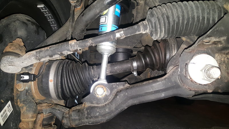

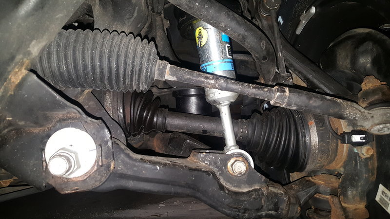

    First off, thank you RogueTRD, you saved my ass once again. Hope I can pay it forward to someone else later. It sits perfect now. 24" hub to fender on both passenger and driver side.
    I could feel the truck sink/settle the first time I turned the steering wheel left and right. Rides super plush now too.
    Here are the CV's after a trip down the freeway.
    Driver
    Passenger
    I started the boot slide on the passenger side the other day. I stopped because I wanted to see how my boots looked after I dropped the front end. I think I'll do the rest of em. I managed to get the truck up to 70 mph on the freeway. No vibes. Didn't even feel like any were going to start. I'm pretty happy how it all turned out. Alignment tomorrow and the dents above the doors are next.
