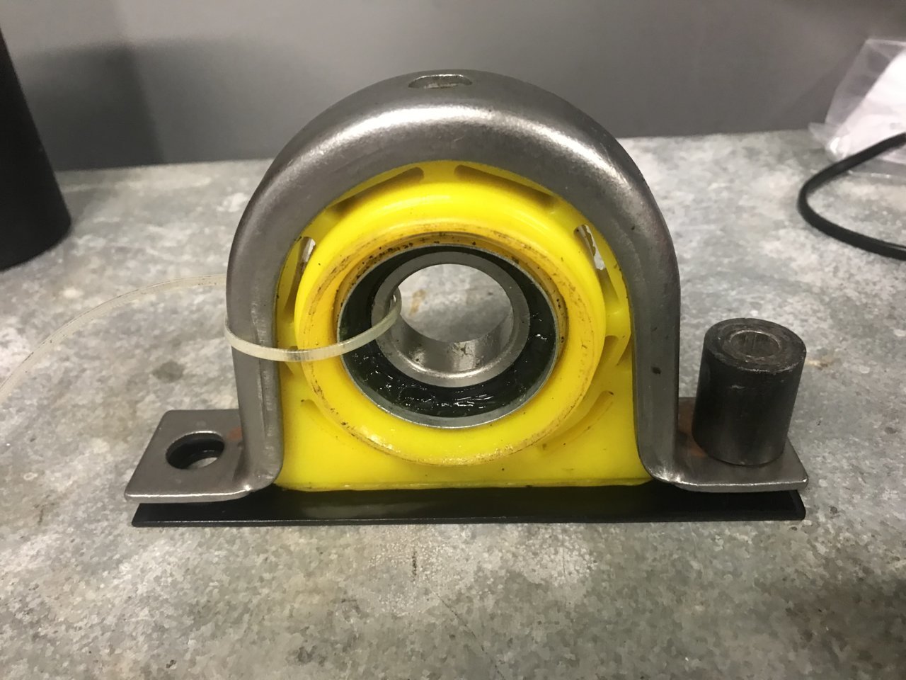

    Yeah i have a piece (see black piece at bottom in photo) but i wanna use a thicker piece of metal which i can fab. I think it’s just about getting the spacer right between the factory mounting point and where that bar will be and getting some longer bolts

    Just what you said. That's exactly what you need to do is get the spacing right, but most people cannot run it like I do with the carrier bearing open end facing upward.
    I run 1/8" thick flat stock on the open end and run nearly 400HP through my otherwise OE driveline. Anything over that is overkill and not necessary honestly unless you already have it lying around.

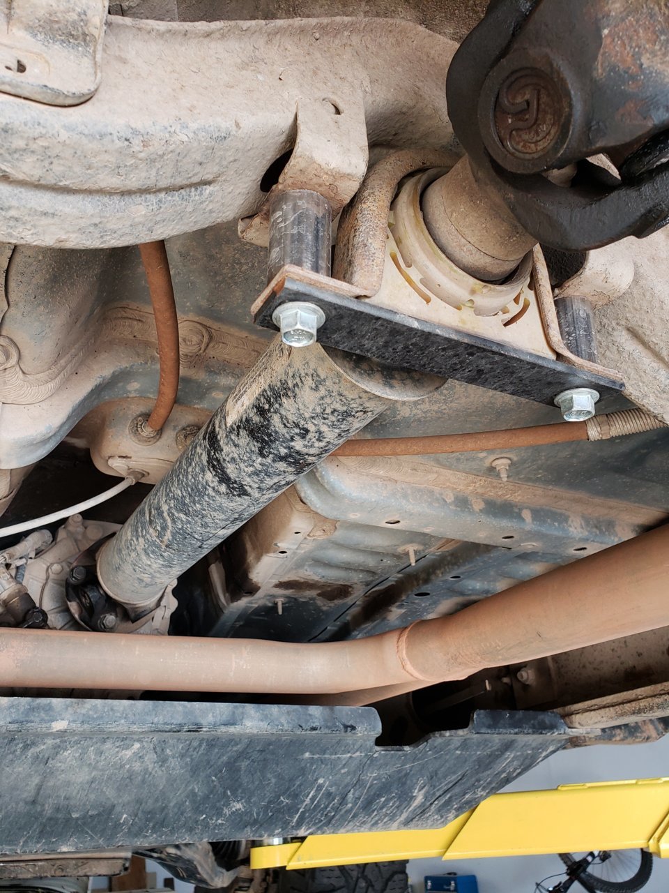

    I am sitting under my truck right now just checking stuff when I saw a notification for this thread and thought I would post a picture haha
    It's been running perfectly smooth. I have vibrations, but they are from wonky driveline angles, not the cb

    Thanks, the 1/8 was exactly what I was thinking. I can probably get everything together, set the height of of the driveshaft with a screw jack and then cut the spacers as needed based on that. This stock CB carrier is so sloppy for only 36k with no offroad use.

    This is exactly what I was envisioning, thanks for the photo.

    Where did you get those spacers? Thought I was gonna have to have something made but if you can make it any easier.:notsure:

    It's just a chunk of 1" round tube I had in the scrap bin that I cut two small pieces from. Nothing magical.
