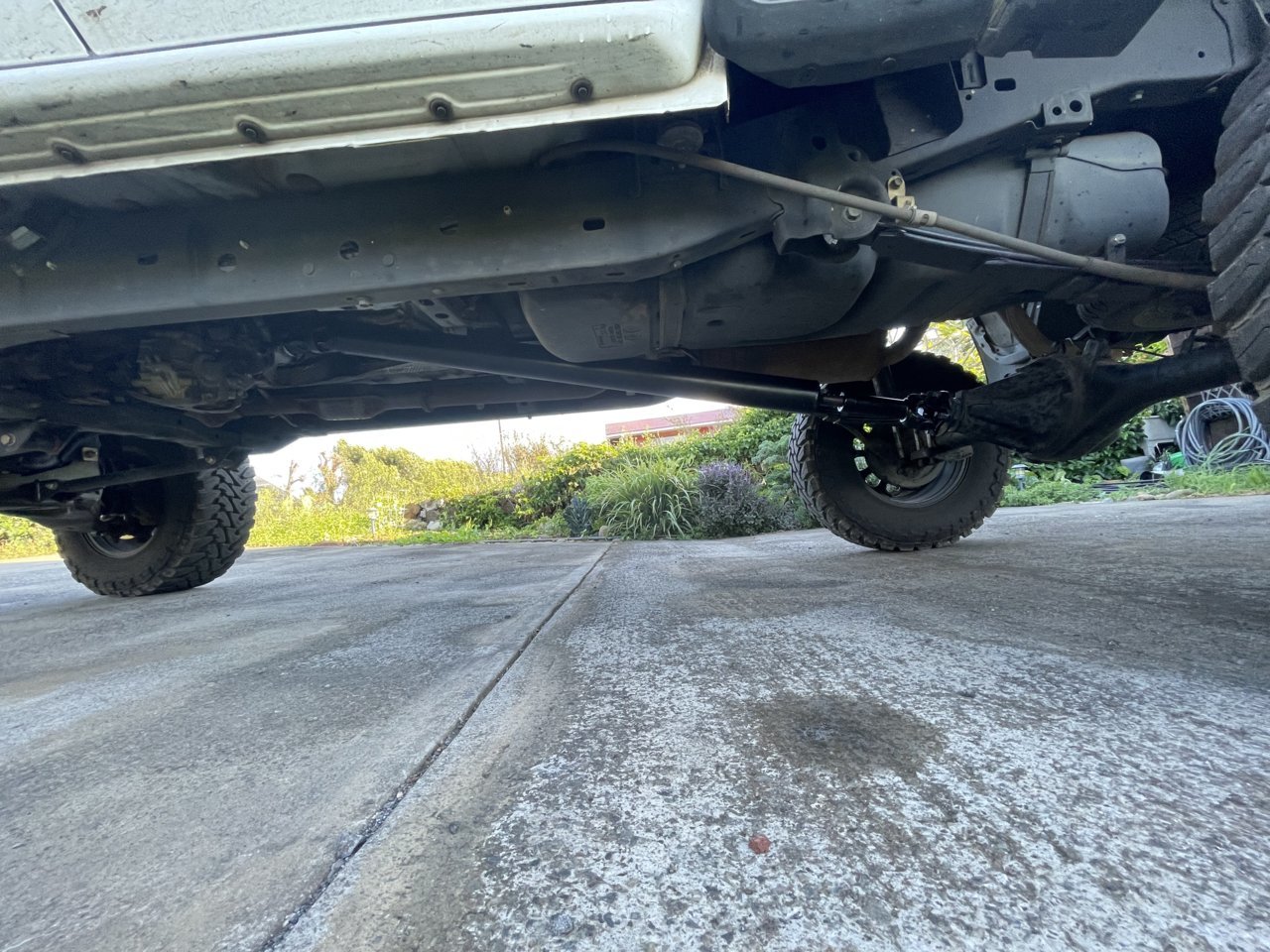

    I got a 1 piece Tom woods rear drive shaft and def the best option instead of replacing all that bearing stuff. I’ve also never hit the drive shaft off roading.

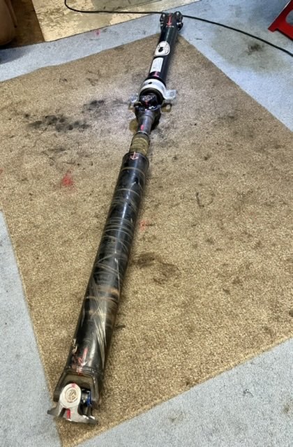

    Not sure what kind of wheeling you do but damn if I wish I didn’t hit mine. This is my second shaft. Just did a refresh on it last night with all new u joints, carrier, and flange yoke as it was cracked.

    With lifted trucks Ive seen people change out carrier bearings, all the u
    Wow thats the most beat up Driveshaft Ive ever seen! I do a lot of just 4x4 on the coast in hawaii.... not sure how it compares to where you are.
