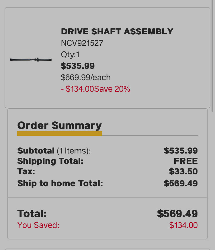

    trying to replace my Ujoints was just a waste of time and money. i wish i just ordered this napa driveshaft first. for $569 total with promo code & it is fine so far . trucks back on the road after sitting for 2weeks

    Not gonna lie I wish I knew about this, do they use Spicer joints?

    idk if the joints are spicer or napa but its been great so far . i noticed the joints are sealed, theres no grease fittings on them, theres only a grease fitting on the slip yoke (i think that's what its called) / part that can slide . it was a easy install anyway right in the driveway
