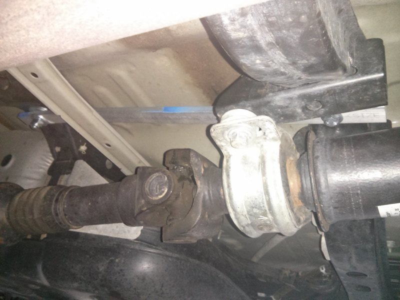

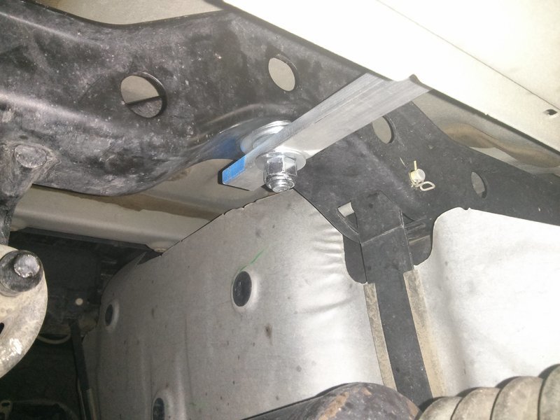

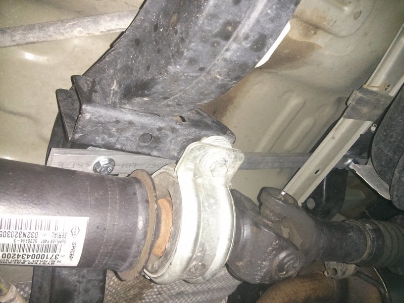

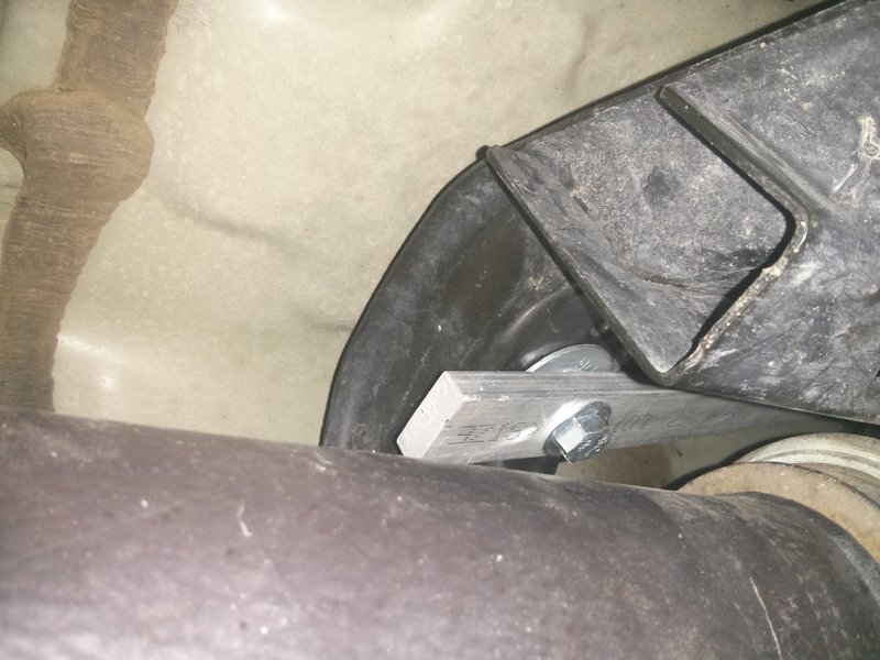

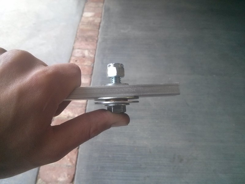

    Alright i made a brace to connect the CB cross member to the one about a ft n a half behind it. Seems to of helped a bit with my take off vibes at about 5 mph. I will always have vibes with this setup though due the mentioned above 1/4in of play the actual bearing has in the mounting rubber itself.
    I just used a 3/8ths x 1in flat bar and two bolts. Big fender washers were used to span the holes in the cross member, but the key was to find a thin proper sized washer to fit inside the hole to center the bolt. You can see my sandwich of washers below.
    Holes were right around 19.5in apart.
    Rear mount:
    Front mount... there is plenty of clearance between the driveshaft and extra aluminum bar, i was just lazy and didnt feel like cutting excess off
    Another angle.
    Like i said it seems to of helped the bigger lumping vibrations around the 5-10mph mark i got when i lifted my truck (you can see washers spacing down the CB to try and combat this). In the quick jaunt around the block those vibrations under normal driving seem to be reduced some, which makes sense they were a bigger vibration caused by the actual flexing of the cross member back n forth.
    My other vibes around the 25mph mark are higher frequency and are attributed to the 1/4in of play i have at the CB rubber.
    12TRDTacoma[OP] likes this.

    Interesting. So all you did was tie into the front member and the rear member where the CB is located and just vertically tied them both together from what I can see in the pictures?
  12. Mar 5, 2016 at 7:26 PM
    #32
    nd4spdbh
    nd4spdbh Well-Known Member
    Oct 7, 2013
    #114055
    14,605
    SoCal
    13 DCSB TRD OR v6 Auto
    yes, i simply made it to where the top center of the cb cross member can not move forward or backward

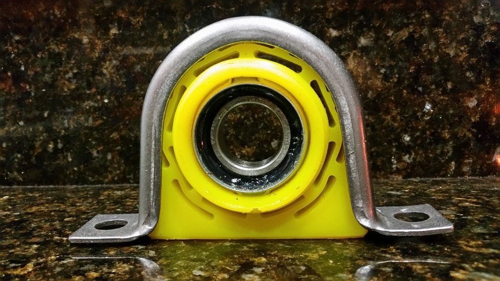

    Just replaced it and mounted it up. No more take off vibes. No more vibes period. It feels nice and solid! Pics soon.

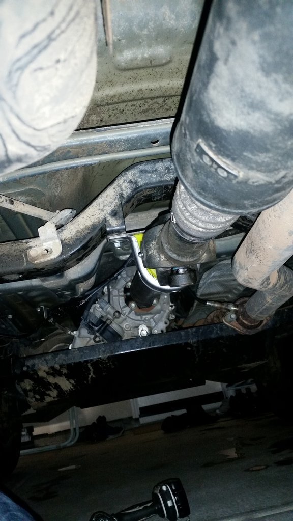

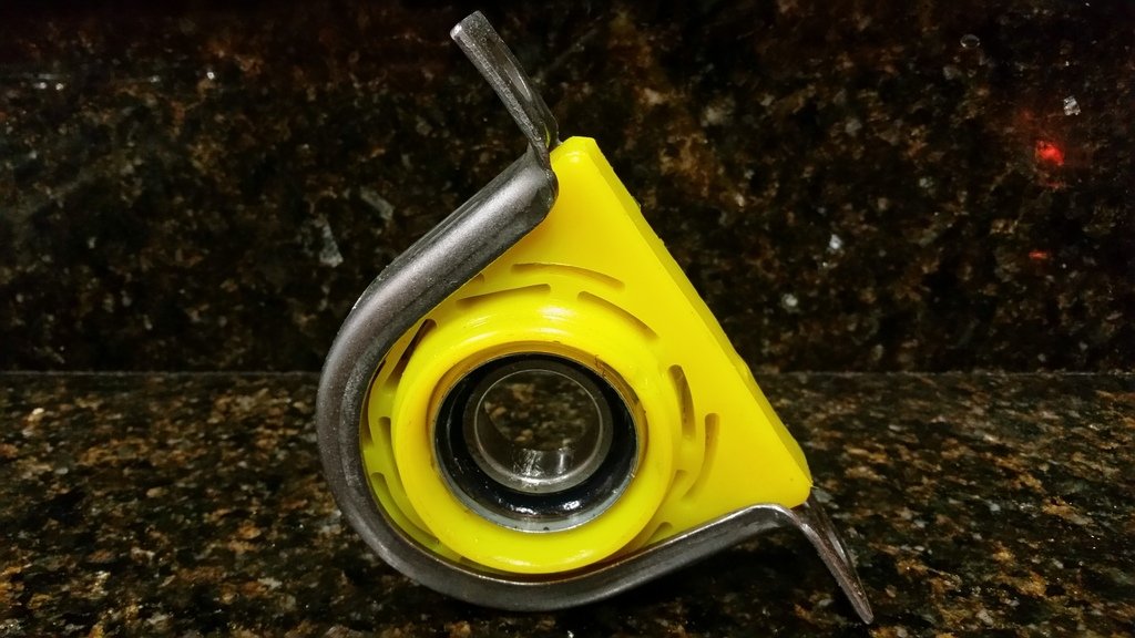

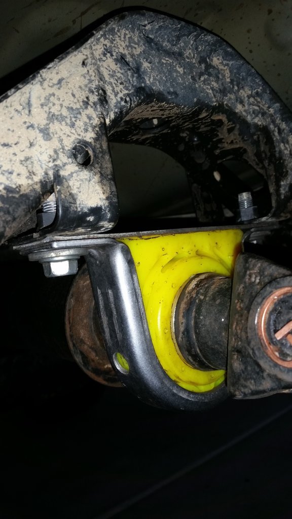

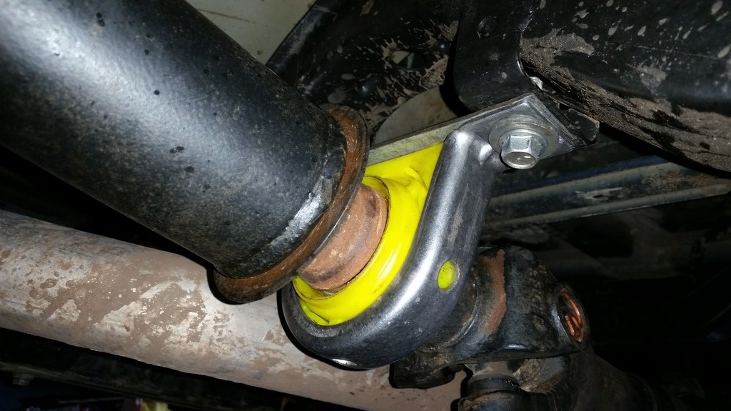

    Here you go! Bolted right in. I did use some spare 1/8 plating up top to create a upper "casing" for the carrier bearing. Pretty easy to do, I love this mod!
