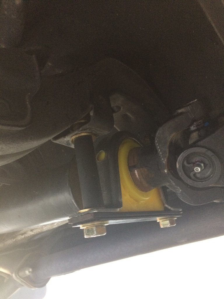

    Finally got my bearing installed. I have a DCLB so I could have bolted it right up with a retainer bracket, but I decided to invert it with spacers to duplicate just a little lower than stock height (I have a 5100 3" leveling lift). So far, so good on my test drive, no vibes at all, but the real test will be Sunday when I leave for Yellowstone with my travel trailer. I'm hoping the take off shutter is gone

    @Moogle you have likely seen this , if not there is an option to invert the poly bearing

    Yeah I saw some doing that in the old group buy thread. Sounds like it works pretty well, but I'm just unsure about spending +$125 for a CB that I'd have to put a lot of effort into making work.
