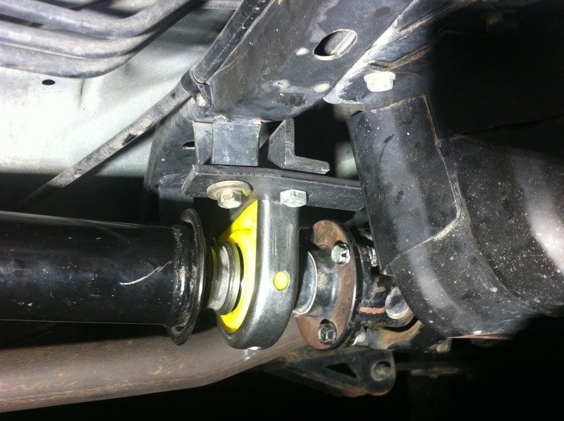

    Okay so my carrier bearing is exhibiting excessive up and down play, it's not bad enough to feel when I am driving though I am sure I have become accustomed to it, but I have always been able to feel it on take off. At first I thought it was torque converter shudder but after doing a full transmission flush today and finding what I found about the bearing I am pretty sure it is time for a replacement part.
    As far as replacement options are concerned I have found several different routes I could go..
    -OE but given how I drive and how long It has been bad I don't want to deal with any issues on my replacement bearing
    -Timken/ SKF, I could go this route but I heard they were weaker than stock and again based on how I wheel I would ruin these replacements quickly.

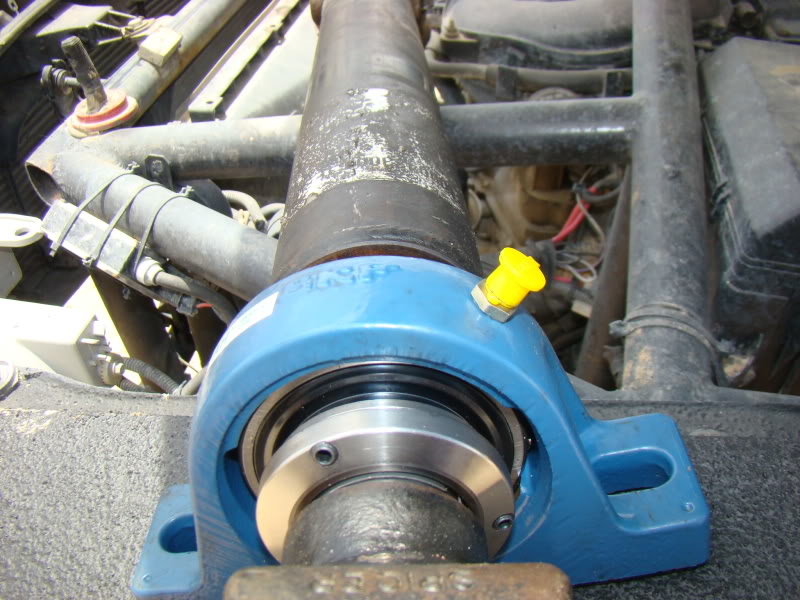

    -The relatively well known "Wookie strength mod" carrier bearing replacement from McMaster Carr, but I have heard while these are very well built, they tend to exhibit horrible vibrations unless your driveline angles are spot on and even then they have the potential to vibe at 80-85+ mph
    http://www.mcmaster.com/#2722t25/=ox5yjh
    - A Polyurethane carrier bearing replacement From IEDLS (Inland Empire Driveline Service) off a Ford Ranger with a ID of 1.1810"
    PN: 211590-1XS
    http://www.iedls.com/Center-Support-Bearings/Pickup-Trucks.asp
    ^^ This option seems to be the most viable to be tough enough to handle my wheeling, yet be forgiving enough for a street duty DD truck like mine is more often than not. It's supposed to require no mods to the driveline to fit.
    I had to search for a bit to find this option, but I'm glad I did. I was going to settle for the wookie strength CB, but now that I found this option I'll be much happier.. I'll be picking up one of these soon as an FYI.
    pictures of it installed (not mine):
    63A53DF3-BD85-4138-AE1B-A394C52C8DF1_zps_c46f8cfbaa38e7819ae34ac7d86eedb0031bf4cb.jpg
    4E101785-76F3-4EA4-A5E6-F5711F2504CD_zps_79bd985e930d692bb03c3c3c80763beb5901a7da.jpg
    So now you know. If you are having issues with your carrier bearing wobbling all over the place and causing horrible vibes at take off or during driving because it is that trashed, here are all your options. From rubber, to Polyurethane, to solid.

    I believe you also need to reinforce the carrier bearing mount if you got the McMaster Carr route

    This is also good to know. Which is even worse because then it does indeed involve modding stuff to make it all work.

    That Mcmaster unit is a pillow block w/grease fitting. There's no give to that unit. Not sure it's a good idea to use in a drive shaft application.

    Being that it is solid it literally transfers EVERYTHING back to you. A good thing for heavy duty wheeler's but a bad thing for weekend warrior's, daily driver's, and everything in between other than the latter. Which is the reason why for most people I am actually going to suggest the polyurethane carrier bearing replacement. Way better than stock, but will still not transfer over vibes.

    The polyurethane CB looks promising
    12TRDTacoma[OP] likes this.

    Doesnt look as solid as stock like front to back motions might bend it

    It shouldn't be an issue, remember, more rubber is required to perform the same task that polyurethane can do with less of it.

    Ordered the polyurethane carrier bearing from IEDLS. It should be in Monday. I'll most likely put it in that day also, so you guys will hear back from me by then about the results. I'm excited!
