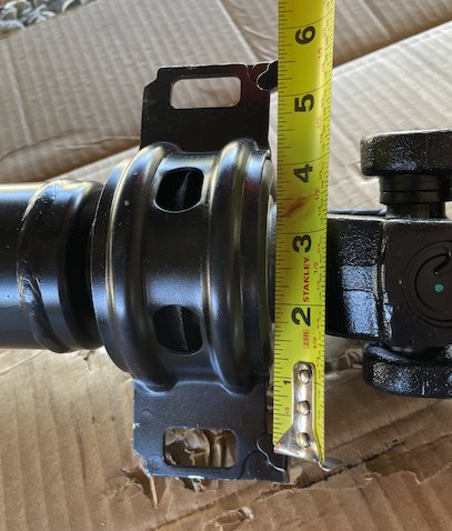

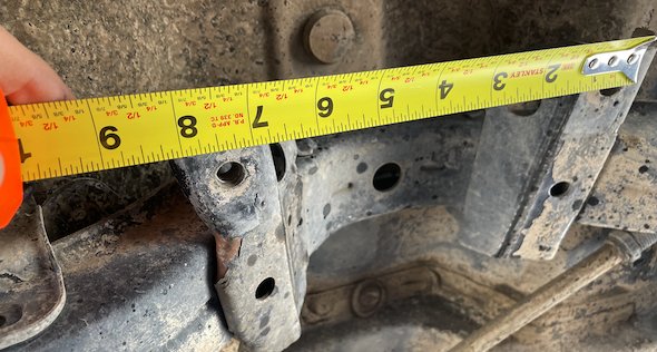

    Does anyone know the width of the bolt holes for the carrier bearing?
    i'm getting 7.5" from hole to hole on mine but I recently lost a driveshaft at the rear flange and it mangled the exhaust and who knows what else underneath.
    I looked at a replacement and my holes 7.5" apart will definitely not line up with this one below. I think the one below might be for a manual or LB because the front section is about 1" long but I would have figured the carrier holes lined up. Hoping I didn't do any damage other than the exhaust.

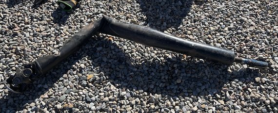

    if you're curious, this is what a one-piece looks like after the rear flange cracked and broke off going 45mph ...

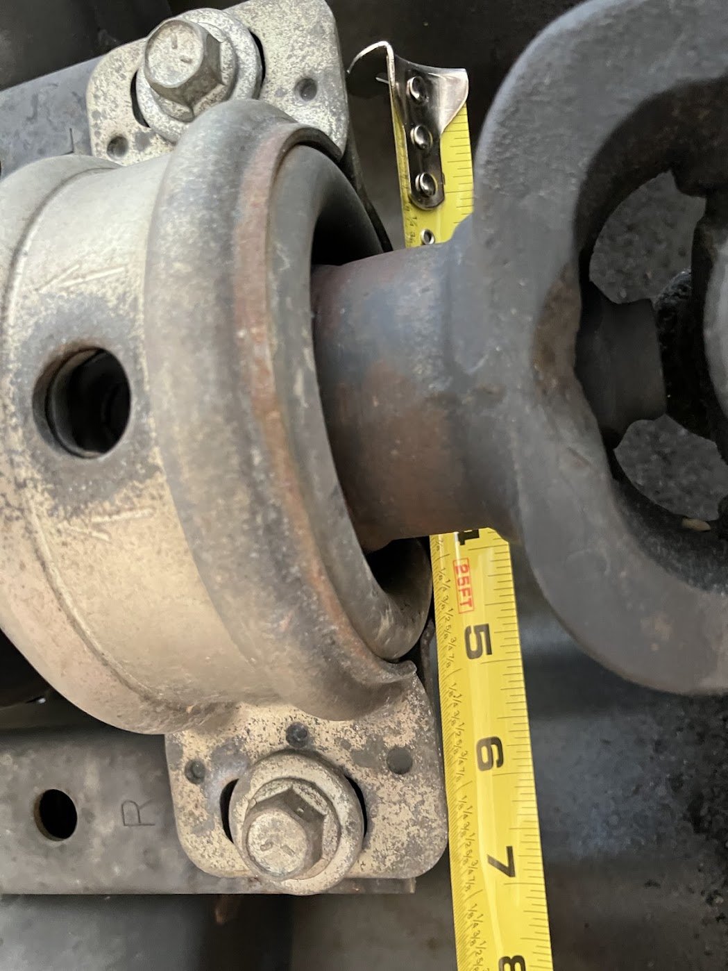

    95% sure it should be 5.5" -- I think the free spinning driveshaft bent the support bracket. unless I get a 1 piece again i'll need to get a new support across the frame that has the carrier bracket. on the hunt ... anyone know what that would be called or a part number? it looks like a cross member but it's really just supporting the carrier. thanks!

    Looks close to 6-1/4" or 160mm

    thanks -- upon more inspection and image searching my brackets are completely bent out of position from the DS that broke off so I'm going to either:
